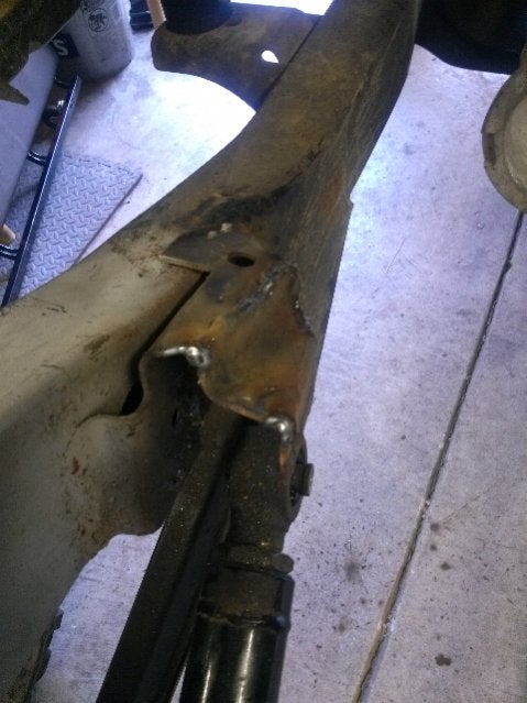

What did you do to correct the starter interference? I was looking at mine and I could see the passenger side upper control arm may be an issue with my starter on the 4bt.
I had to fab up new control arm brackets,which wasn't to bad to do. What are you going to do about the 8 degree engine tilt to the left?

Cummins5552,
The engine is tilted because the motor mounts are not in yet. The main weight of the engine is still supported by the hoist. The starter is hanging up on the control arm mount causing the motor to slant.
What are your plans for a fix?

I am going to cut entire top of the mount and then maybe like 1/2 an inch down on the side and see if an angle wont reduce the interference . I dont need much.
I dont think it will interfere with the control arm function.
You guys have any suggestions.
Becareful cutting the bends of the mount. the bends give the metal its strength. hence "I" iron. The bends make ridgity. The only thing I would be afraid of is with the motion of the arm that it will snap or bend the mount. If I was you i would cut and do whatever you have to do but I would re-inforce the mount molding the existing mount wherever possible. Basically I would just overlap the bends and whatever else you can. I'm just guessing. I'm trying to think how much force is put on it. I think if your bushings are solid and no play exists you probably would be ok leaving as is after your done with the fitment issues. Just my suggestion. When you are ready to do it you will make the choice I'm just the peanut gallery

Cowboyup94. I decided to take your advice about the bends in the upper control arm mount.
So this morning i cut the top inside bend out and actually flipped it.
After i flipped it i then welded it in.
Then re installed the engine to check for clearances .
