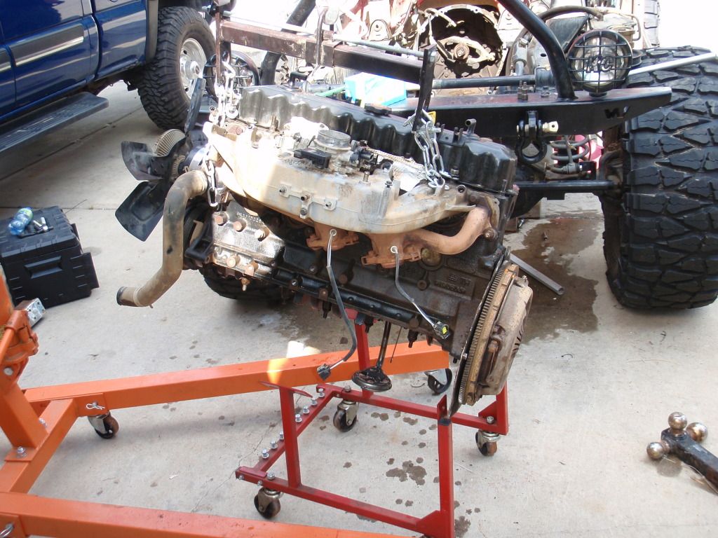

This morning i made some good progress. I have entire wire harness off the engine and the engine is ready to pull. Only thing is, i am not exactly sure where to hook my chain to the engine to pull it. Any suggestion.. i plan on selling the engine so i dont want to take it apart much to pull.

On my old jeep, when I did an engine swap I used the head bolts that were sticking up. There is just enough to get a chain and nut on them to pull it out.
