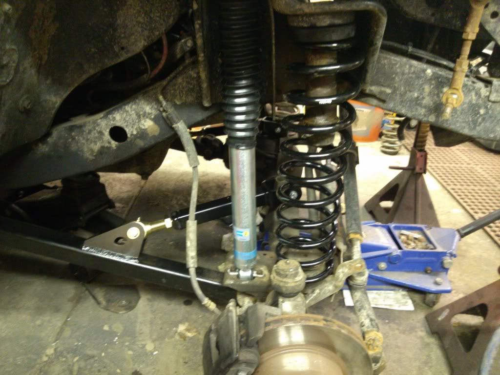

The last shows the frame without the lower control arm bracket. Everything is turning out great.

So today went much better and faster than yesterday. I have the entire front end done and it went together very easy.
A buddy and I took Oscar out and the Jeep is transformed. I should have done this from the beginning. It rides so smooth and so nice. Honest to god it rides like a new vehicle. And that's with half long arms and still rough country shot, worn out shocks in the back.
I took some pics which I will post up in a bit and a video of the jeep playing in a small snow pile.

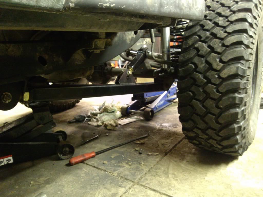

above picture shows the long arms sitting with the weight of the jeep on them
New shocks and new springs

I did have to cut the belly pan for clearance of the control arm mounts. Not a big deal just a little trimming.
Oscar sits a little funny right now. I ended up going with 4 inch lift coils rather than 5.5 and the front still sits about an inch high from the back. I am going to see if the coils settle before going and buying rear 4 inch coils.
I honestly cant get over how great the Jeep rides now.
