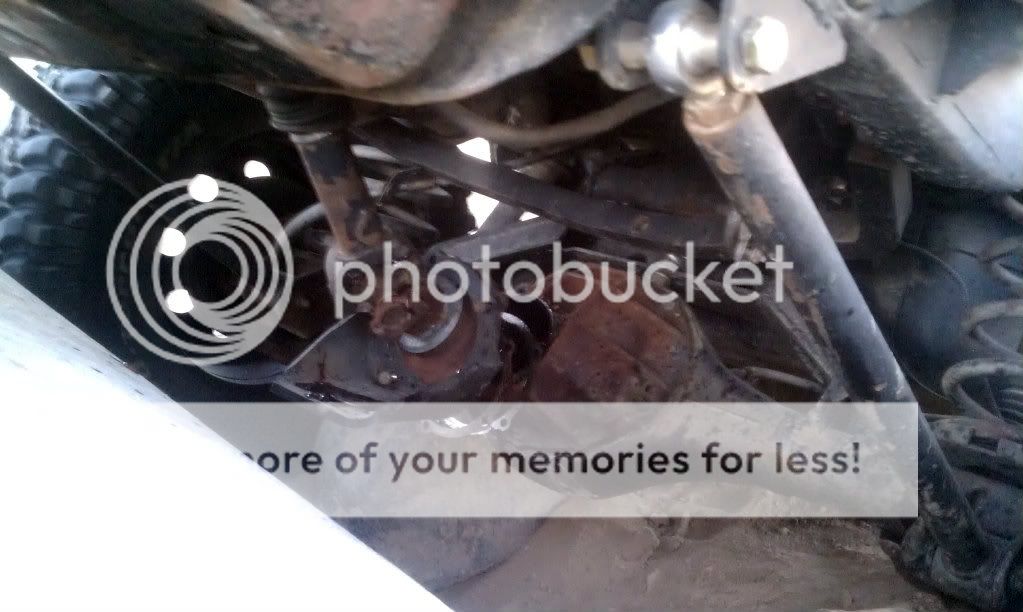

Turned out the pinion gear is in great shape, so we just need to get longer bolts and put everything back together
