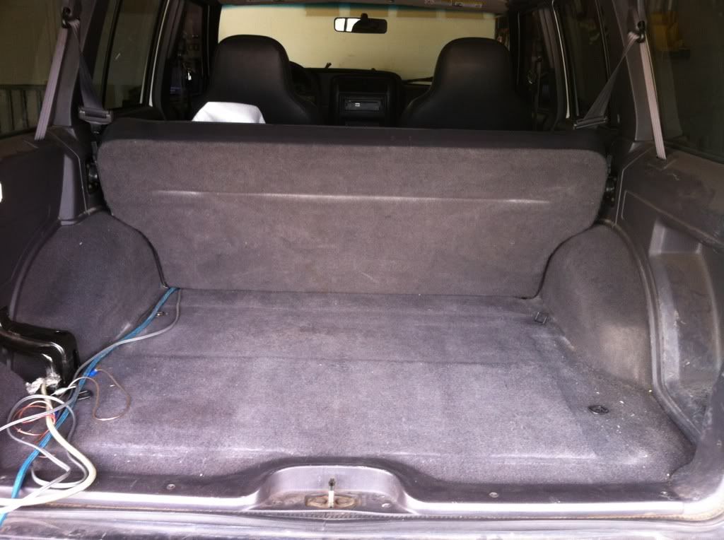

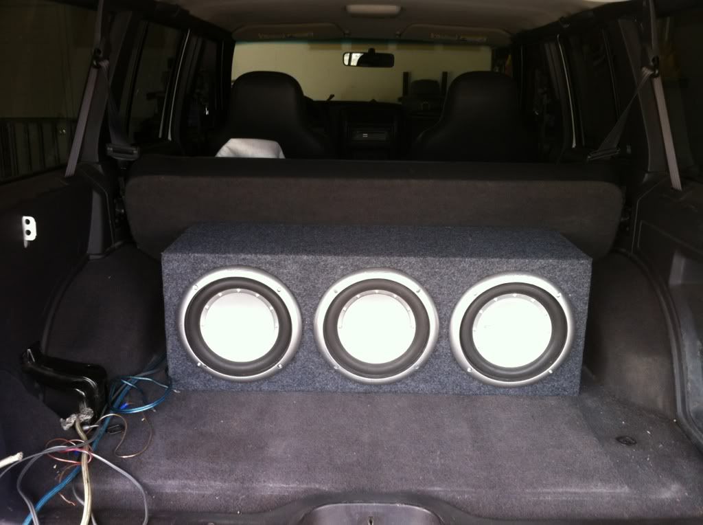

Someone broke in and stole my deck and a bunch of CDs
So now i ride around like this, so im not advertising what i have inside.

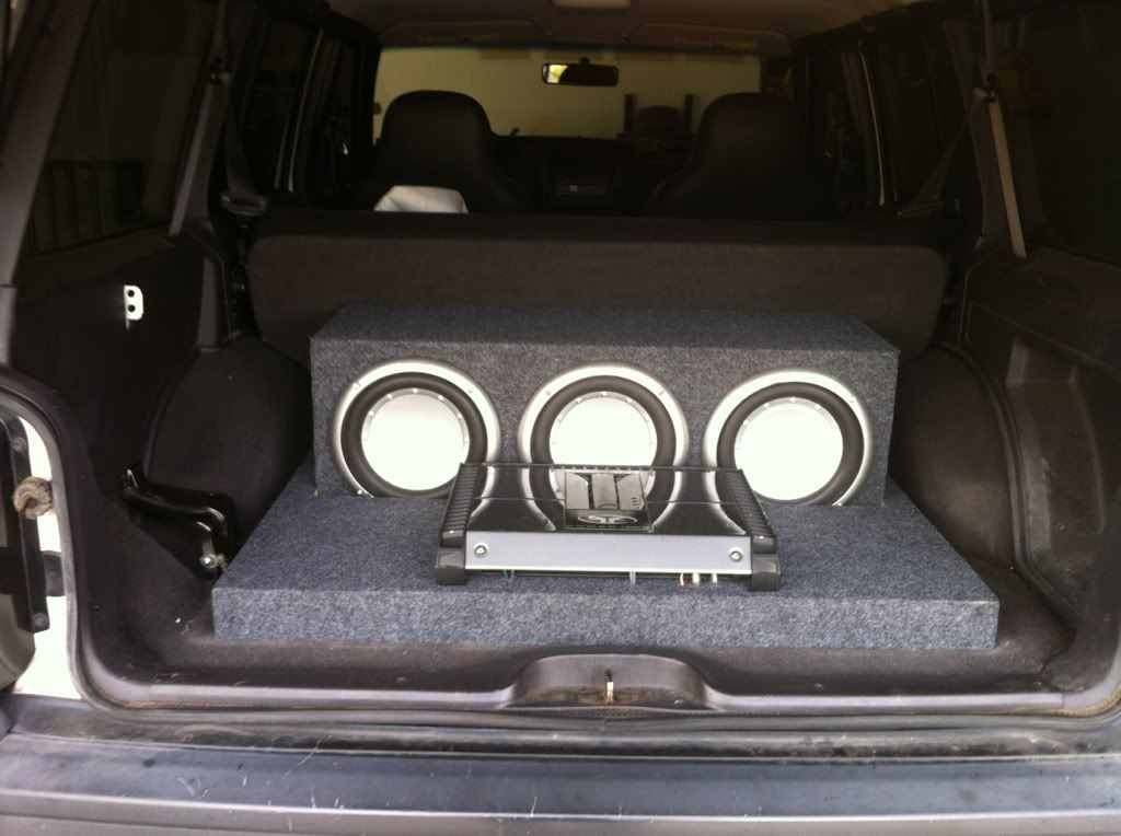

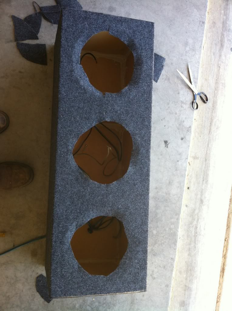

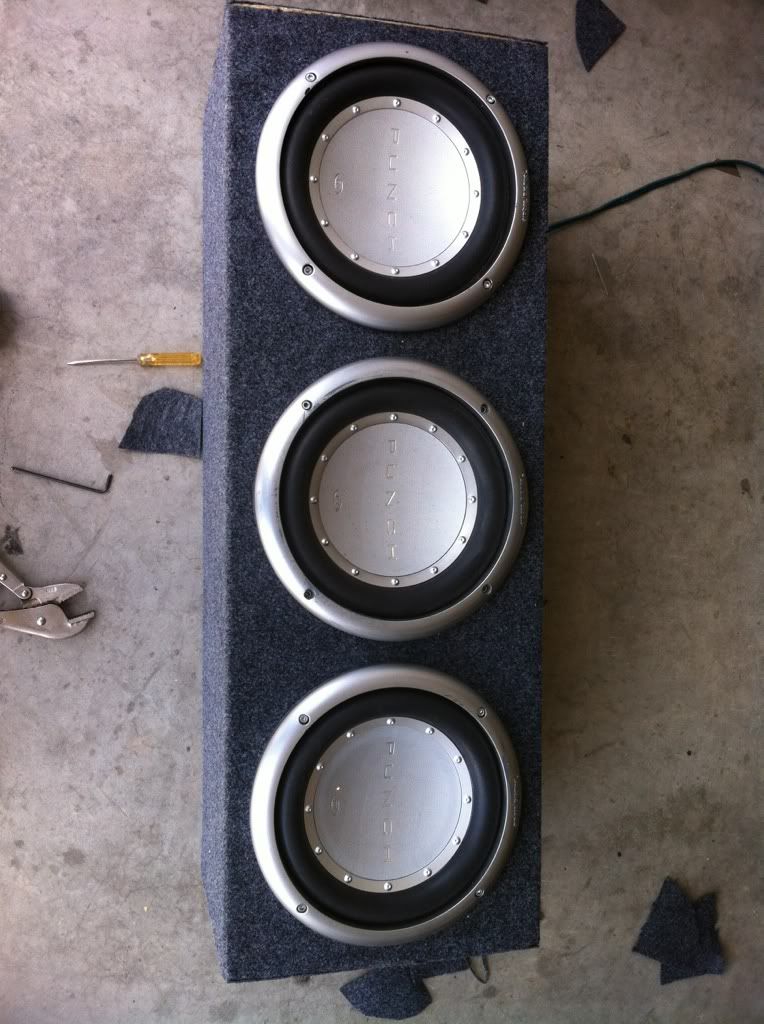

So long story short i got a new deck and it got broken into again but luckily this time i wasnt an idiot and i had taken the faceplate out. So after the second time i decided to purchase one of these.
It also has a remote start! Not that i really use the remote start part but it was cool to show off at first.

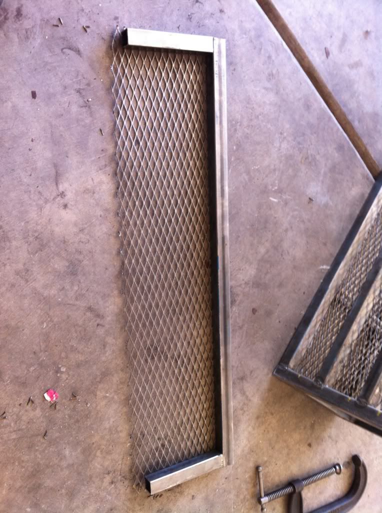

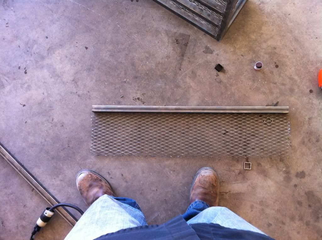

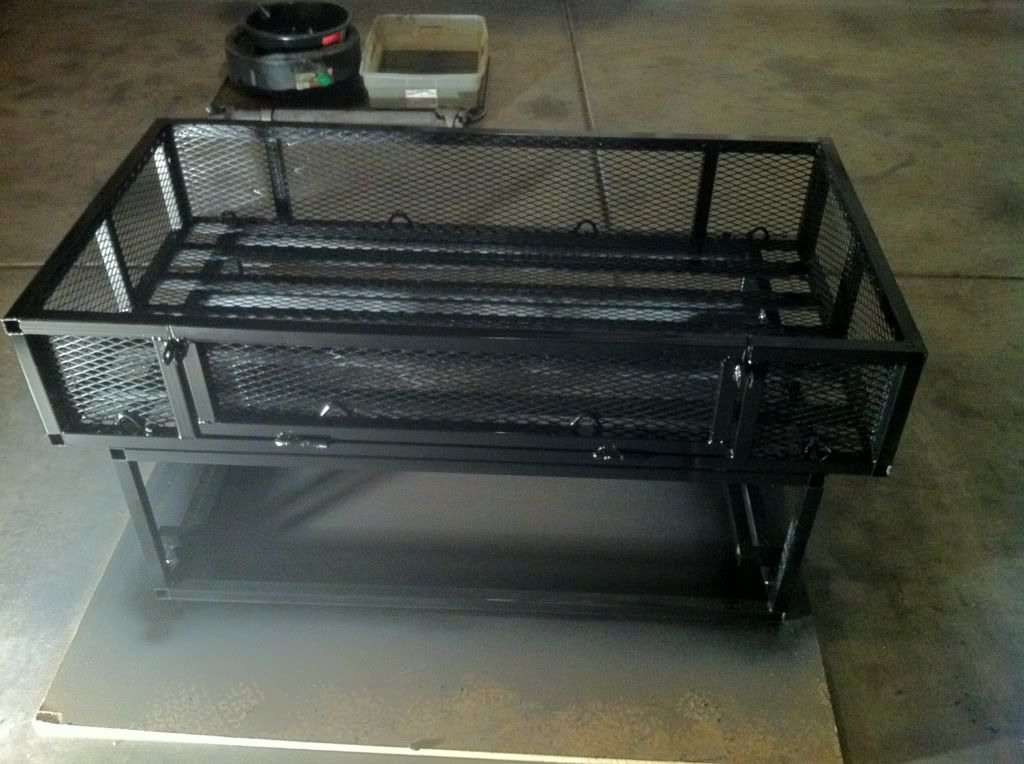

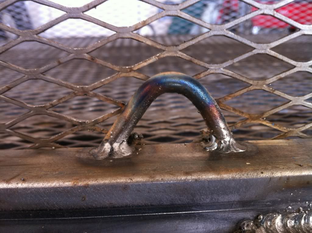

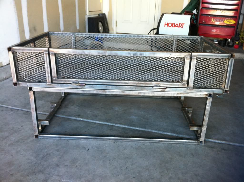

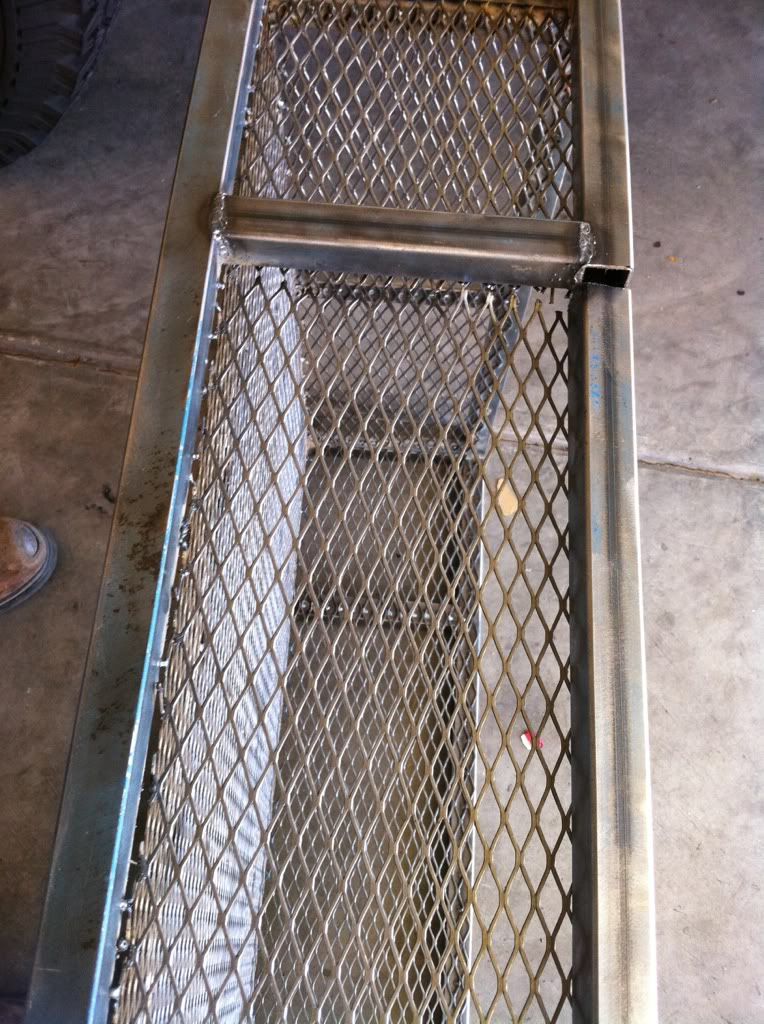

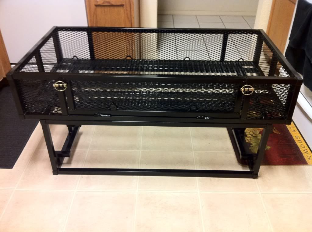

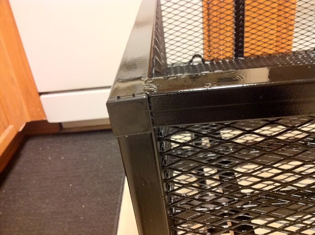

Here's something i made for the Jeep awhile back.
I used a hitch base and a stock tow hook off a ford truck
To make this.

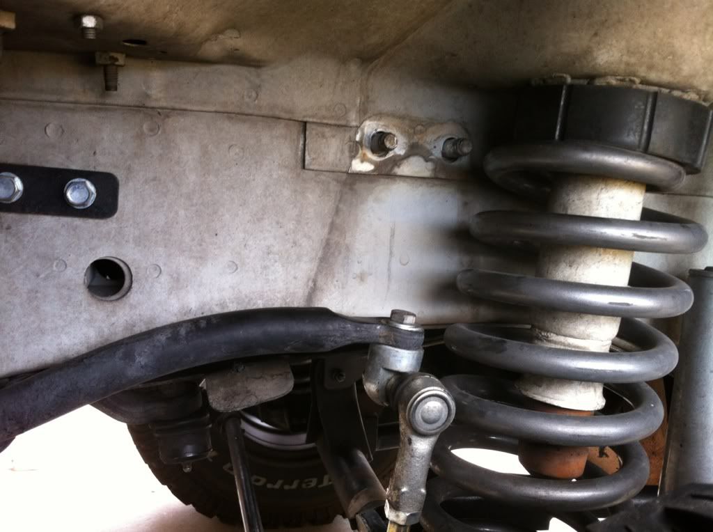

1" coil spacers to level it out because when i put the shims in the rear it made the rear sit higher than the front, but i havent put them in yet cause im waiting till i can get control arm drop brackets, the iro heavy duty track bar with drop bracket and drop pitman arm if needed. Reason being is that my front measures to 5.5 and rear is at 6.25 so when i add the spacers the front will be over 6".
