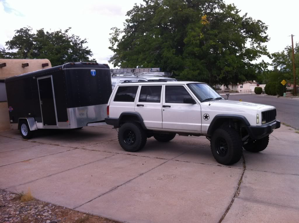

So driving on a little trip 2hrs each way with a trailer made me realize two things:
[IMG][/IMG]
I need a drop hitch!
I need 2 re-gear!

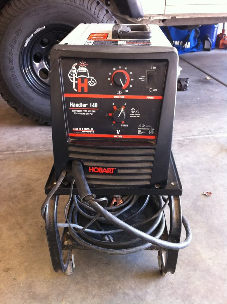

Handler 140.
That's the one I'm looking at getting sooner or later.

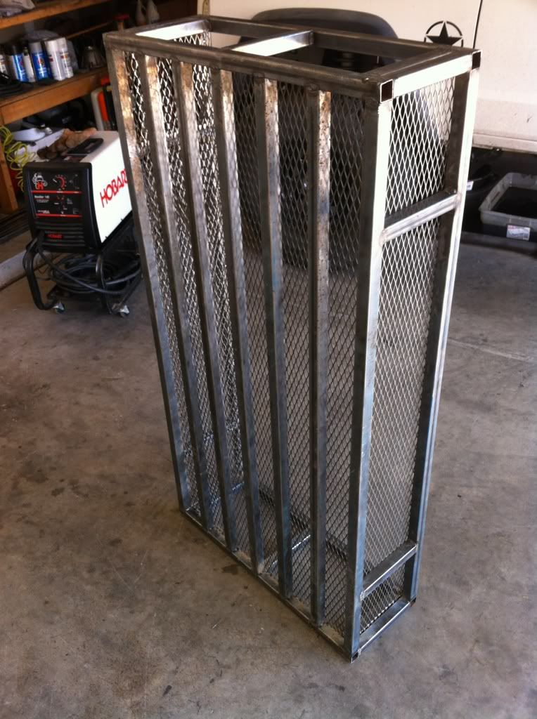

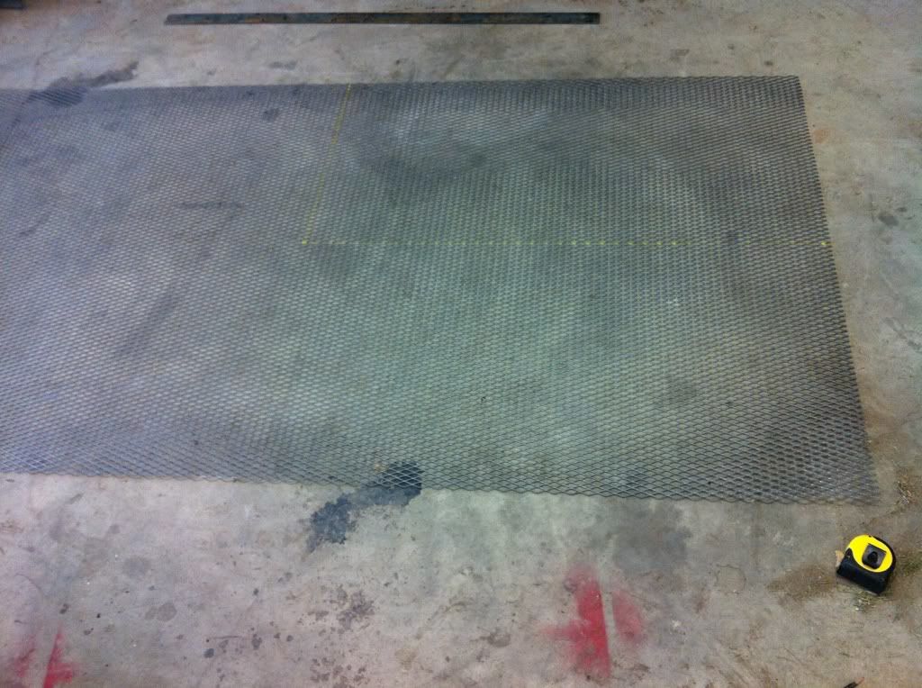

Got some progress done on the basket.
Got me a sheet of mesh to line it with.

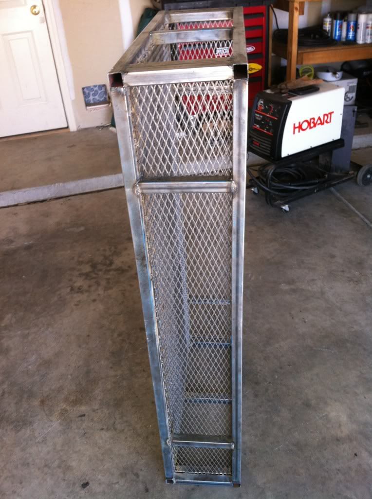

[IMG][/IMG]
Got the pieces cut out.
[IMG][/IMG]

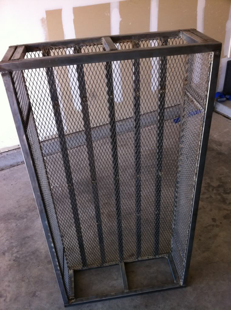

Got 3 outta 5 welded in. Just need to do the 2 small sides.
[IMG][/IMG]
[IMG][/IMG]
[IMG][/IMG]

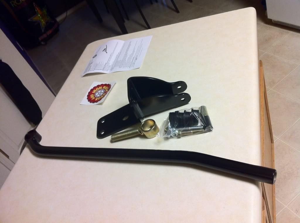

Why an IRO double shear track bar and bracket of course!
[IMG][/IMG]
Now I know what everybody is talking about! This thing is pure beef like a Hebrew national hot dog! I will post a comparison pic when I do the install.

Originally Posted by XJ_Renegade
Handler 140.
It's not quite as nice as my Lincoln power mig 140C that I have at work, but it get the job done and I got it used at a good price. The thing I don't care for is the current setting, u can only put it on the a,b,c, or d. On my Lincoln you can put it anywhere like between the a and b for more fine tuning.
