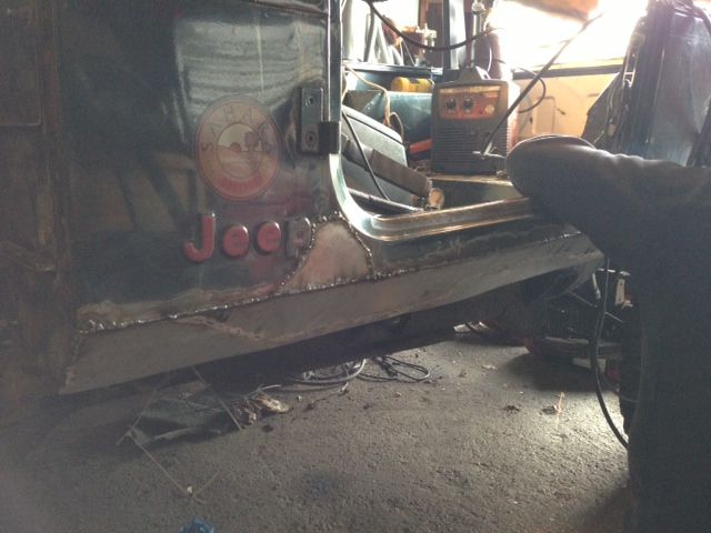

Finished the drivers side today. Fit some patch pieces in to the final rust areas, welded the whole thing up inside and out and grinded the outside down. Feel like it never ends, but kinda nice to know i have one side done atleast! Will just have to mount the boatside gaurds and drill mounting holes.

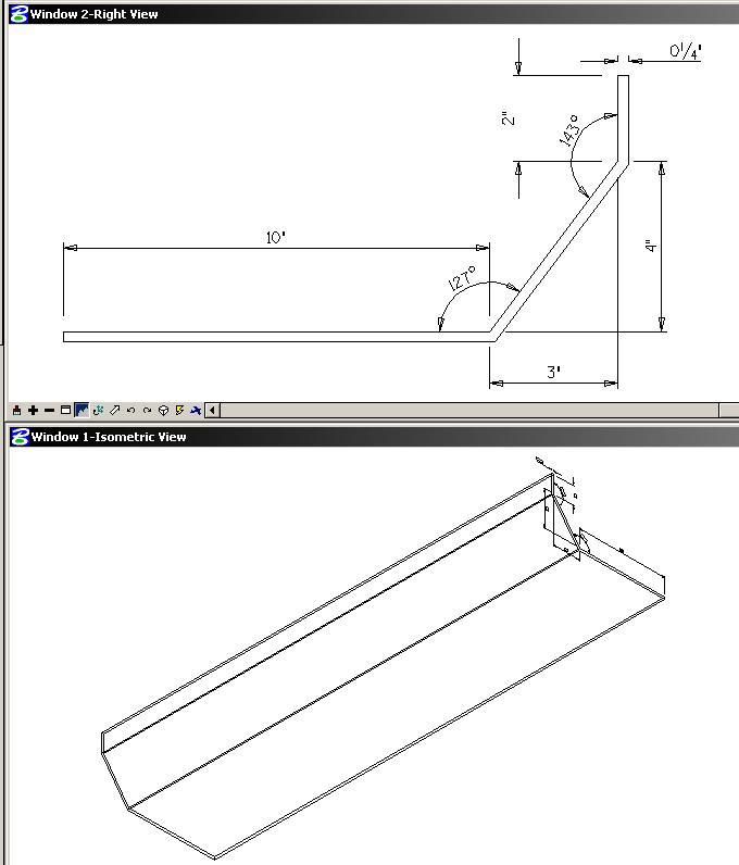

[QUOTE=CKjeeps;14838174]I'm guessing the angles are 45 deg on the bends, i was more so curious on how car you have them bending in after the bottom 45 deg. Do you have them replacing your floor panel at the body mount, or cut away from the body mount. QUOTE]
Not 100% sure what you are asking about but maybe this explains it. What you see in the pictures above is the 16G patch panel that is welded to the tub, it connects to the rocker and then inside is welded to the floor boards. The actual gaurds that go over the tub are 3/16" steel and will bolt to the rocker just below the "jeep" stamp and the door sill. They match the new angle of the rocker and run along the bottom of the floor. They mount to the stock body mount (front and rear, i cut out a center notch so avoid the center body mount. It made install alot easier) locations under the truck. I included a blue print ,i cant take credit for it i got from another user on this forum. I belive it was erock but i honestly forget who. My boat side gaurd is a bit different then this print. I bent up the front of the rocker to allow for the height difference between the body mounts and also cut a channel to allow for nthe e-brake cable. The gaurd was cut to run along the frame instead of having them slide between the frame and the tub. This also saved me a few pounds, 3/16" is kinda heavy so any weight i could take off was good in my book as along as it didnt have any effect on the strength which it shouldnt. Hope this covers what you were asking. if not please feel free to ask any more questions. I love the boatside project so far, it has been a fun learning experience.

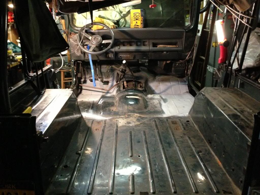

Finished welding the drivers side, then started removing everything from the inside of the truck. I purchased some spray on raptor liner and will spray the inside of the tub as soon as i get the passenger boatside finished.
Here is how the inside of the boatside looks. The old seat belt lower bolt location was totally rusted out so we welded a grade 8 nut to a small plate of 16g and then welded that to the inside of the sheet metal you see in the picture.
I started filling the seams with some brush on seal sealer but have not finished yet.
Inside is almost totally stripped out. To start the sanding pocess, not looking forward to it. The raptor liner should arrive later this week.

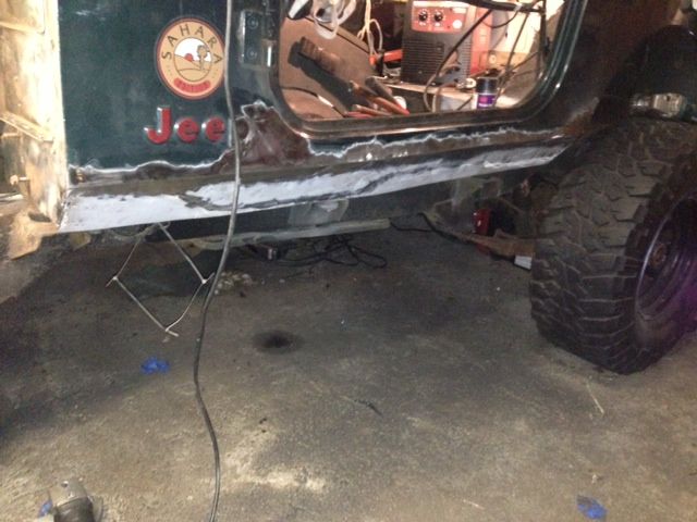

Got the passenger side boatsides welded up. Had a few rust spots I had to trim off. Need to cut some filler pieces for these.

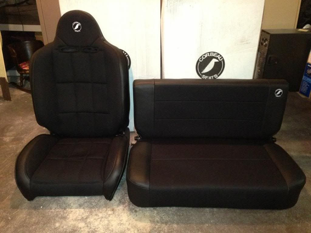

Brown Santa came today and delivered some goodies. The green sahara seats i have are fine but just wont go with the Jeep when i paint it black.
