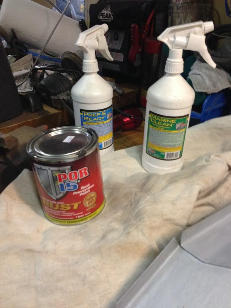

Had some time today to work on the floor boards. Cut out all the rusted area in the driver floor and fitted the replacement panel. I picked up some POR15 to coat everything i could reach while the floor had a huge hole in it.
Had everything prepped and finally ready to weld.

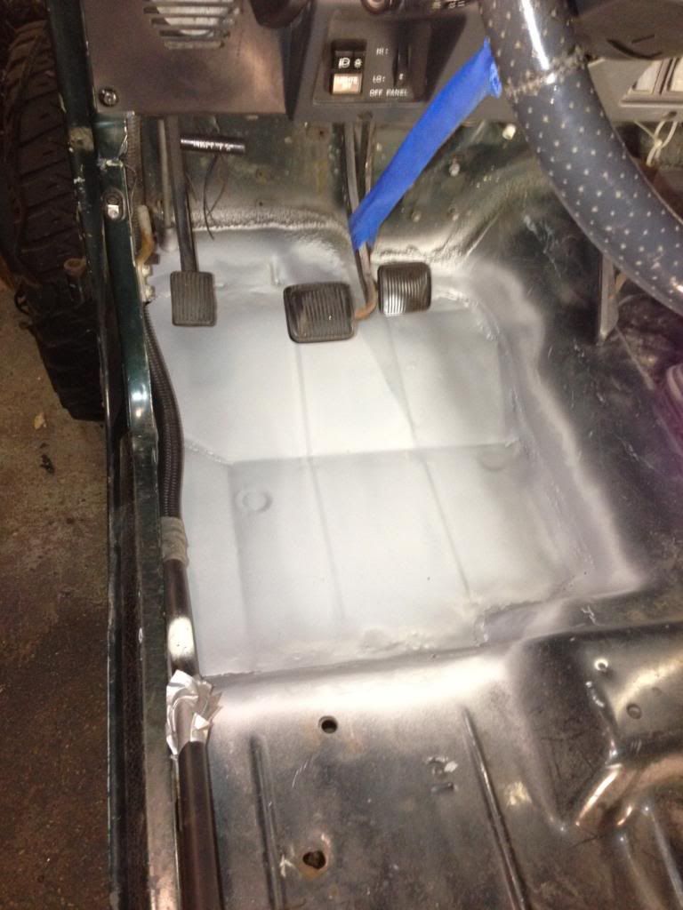

Front floor pan done.
Also Finished the mock-up of the boatsides and will take them over to the sheet metal shop to get the 3/16Th ones bent up. Now have to debate on if i should paint them or pay to get them powdercoated. Any opinions on paint over powdercoat for rockers? I know powdercoat tends to be stronger but figured paint might be easier to touch up if it gets scratched up.

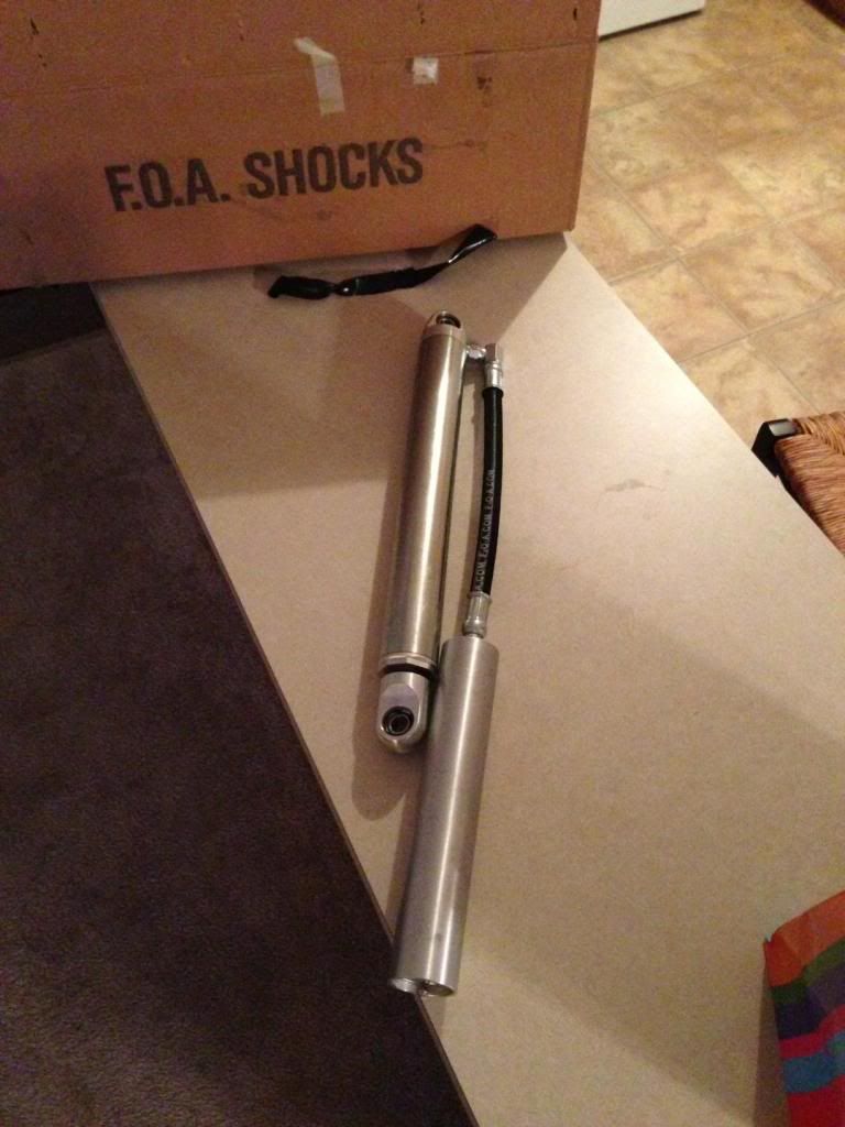

Well Wifea claus was good to me this year got me a Hi-Lift with base and a set of F.O.A. reservior shocks for the jeep. Just need to order some shock hoops for the front. Also have to figure out how/where to mount the reservior.

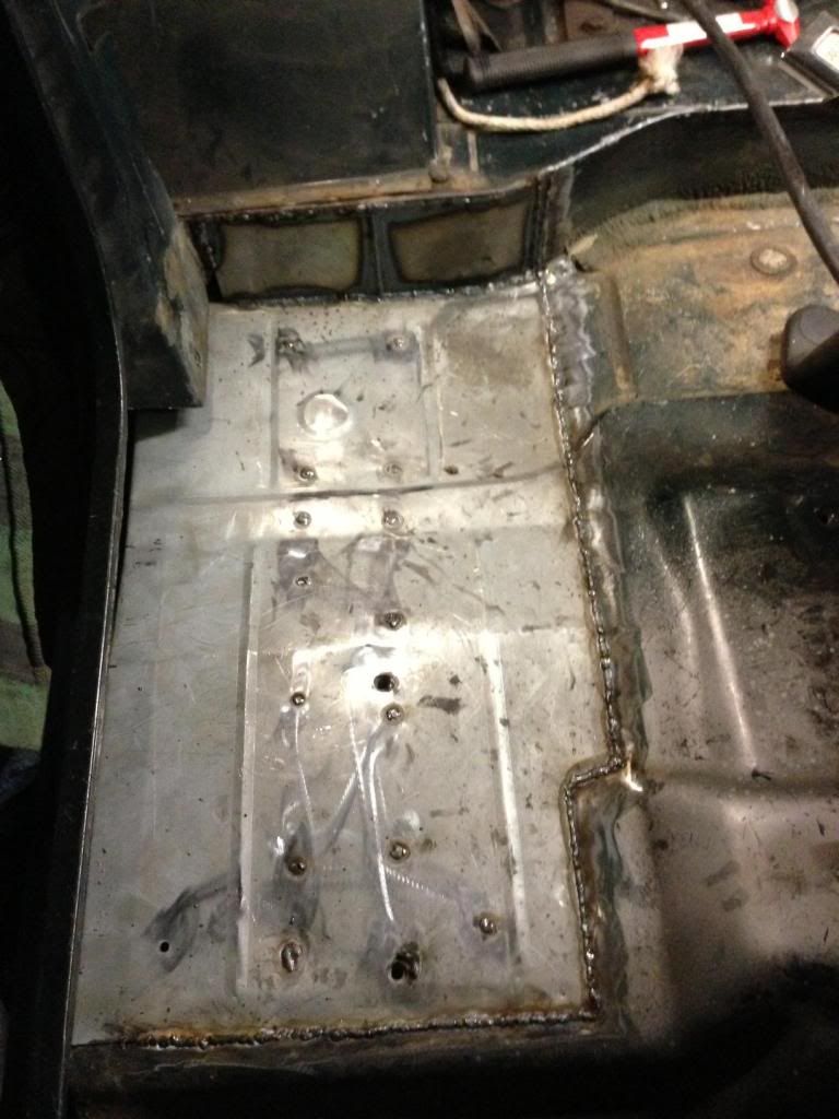

One more floorboard down, 3 out of 4 done. Just need to do the front passanger floor, close off rocker panels with sheetmetal for the boatsides, Grind down current welds, seam seal, prime, and monsterliner.

post #44 of 128 Old 01-06-2013, 12:48 PM Thread Starter
hokusi
Location: bohemia
Posts: 128

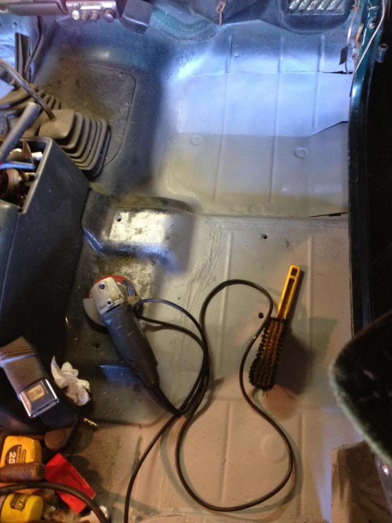

Got the last floor panel in today. Now just have to close off the rocker panels with some sheetmetal so i can finish my boatside rocker gaurds. Still have to figure out exacly how i will do the rocker panels, i want to be able to remove the rocker gaurds and still have a nice finished look to the tub.

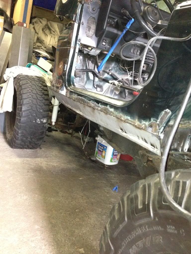

post #45 of 128 Old 01-13-2013, 10:52 AM Thread Starter
hokusi
Location: bohemia
Posts: 128
Started with the drivers boat side rocker today. Cut a strip of 16G and welded to to the body and then on the inside to the floor pans. Want to totally seal off the tub. It went pretty smooth , just need 2 small patch piece of sheetmetal on the rocker were i cut out some rust. Doesnt have to look perfect since its just getting covered by the 3/16" boat side rocker gaurds, but i still want it to be as close to factory look as possible.
