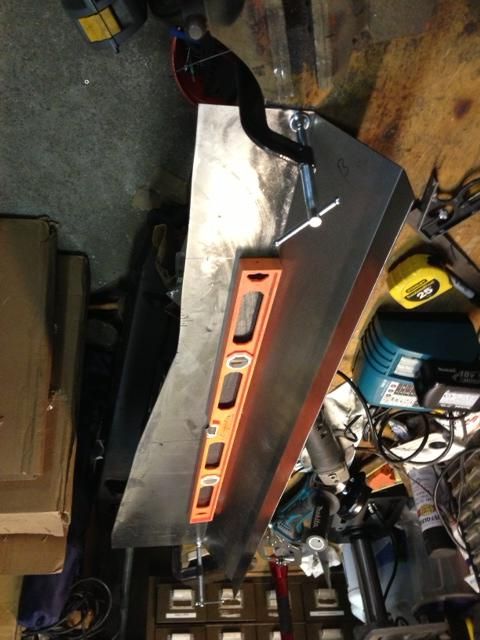

After some thought i decided to go with boatside rockers. One of my clients is an aerospace sheet metal shop and they where able to make me a set of boatside rocker. I had them make me a thinner mock-up set so i can check the fitment and make any adjustments. Once mocked up i will cut and bend up a 3/16 set. That being said it was time to start trimming the rockers. Sadly the amount we had to trim did not cover all the rust spots so i need to do a bit of patch work. I want to try to keep the JEEP stamp but depends how much rust there is and if i can trim out around it for the patch.
I have a 2 inch top lip on the boatside rockers so i measured down from just below the door sill and we ran a line of tape to use a cutting guide. It removes 4-1/4" from the bottom of the rocker.
Then it was just time to cut the sheet metal and pry if from the tub. It had alot of rust so actually came off pretty easy. Use the air chisel to get through a few rivits along the way.

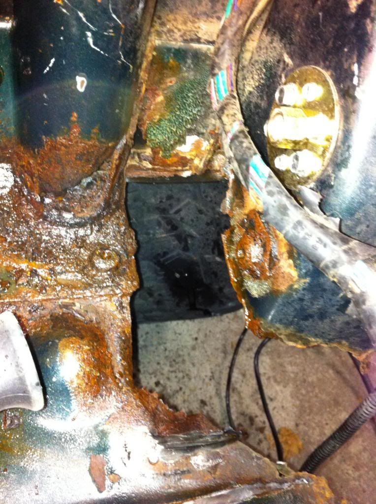

The floor boards had a good amount of rust so i opted to buy full replacements. When i pulled the rug and really inspected the floors there were a few more holes then i expected. Also the PO had done a pretty bad job patching the driver side front floor. When i first had looked i thought they welded in a patch panel but on second look they actually used sheet metal screws and some kinda hard rubber adhesive/sealant to hold the panel in.
Panel removed-
I was poking around with a screwdriver and poked a hole right into the base of the roll bar. Guess that' s going to have to be replaced.

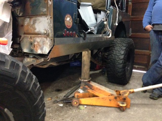

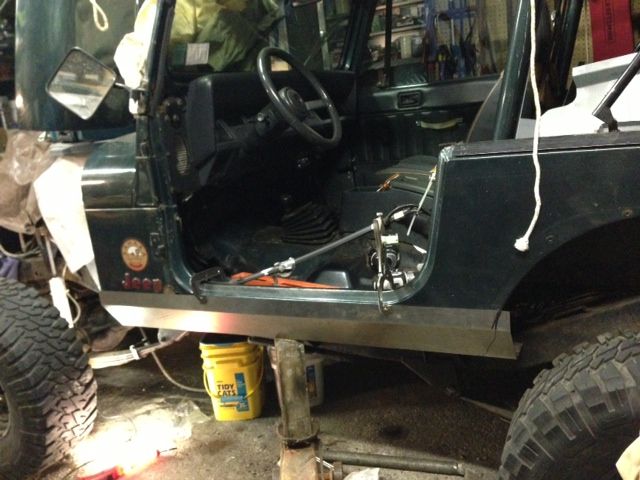

Got the boatside mocked-up today. Really like the way they look. It was a bit of work but well worth it. Now i have to cut out the old floor boards and weld up the new ones, drill out all the stripped/rusted roll bar bolts (screw you torx-heads), and create some patch pieces for the rusted area behind the roll bar mounts.
hokusi is offline
post #29 of 128 Old 11-18-2012, 07:21 PM Thread Starter
hokusi
Location: bohemia
Posts: 128

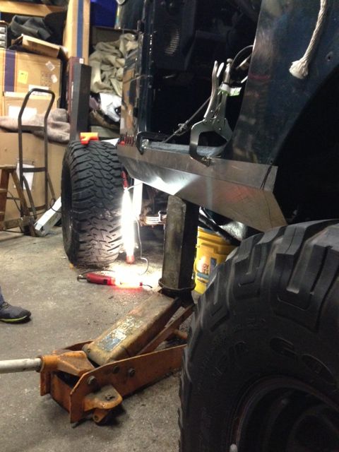

I cut the boatsides to run just along the frame. Once i get a few more small trims i will send it back to the sheetmetal shop so he can program it into the lazer and brake. Then have him make me a set in 3/16th sheet.
I ran into 2 small problems while mocking it up:
a) The front body mount is about a 1 1/4 higher then the other mounts so i had to bend up the section at that body mount. I will get a picture when i remove the mockup.
b) the e-brake cable runs right where the rocker mounts. I ended up cutting a channel through the boatside so it can slide past the cable.
