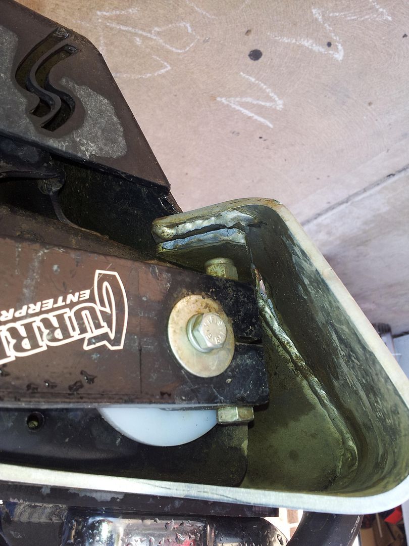

Lastly, I had been getting a clunk going from forward to reverse. After longer than I care to admit, the clunk has been found. 2 of the 3 bolt locations for the motor mount plate have broken off of the block. I ordered up a set of these heavy duty plates from MORE. They use the original 3 plus 7 more additional mounting points on the block. They look bulky and will be a chore to install, but it beats pulling the engine. After that I am down to balljoints, swap in the low pinion rear 3rdd member if I have time, and fix a leaking transmission cooler line. Home stretch.
