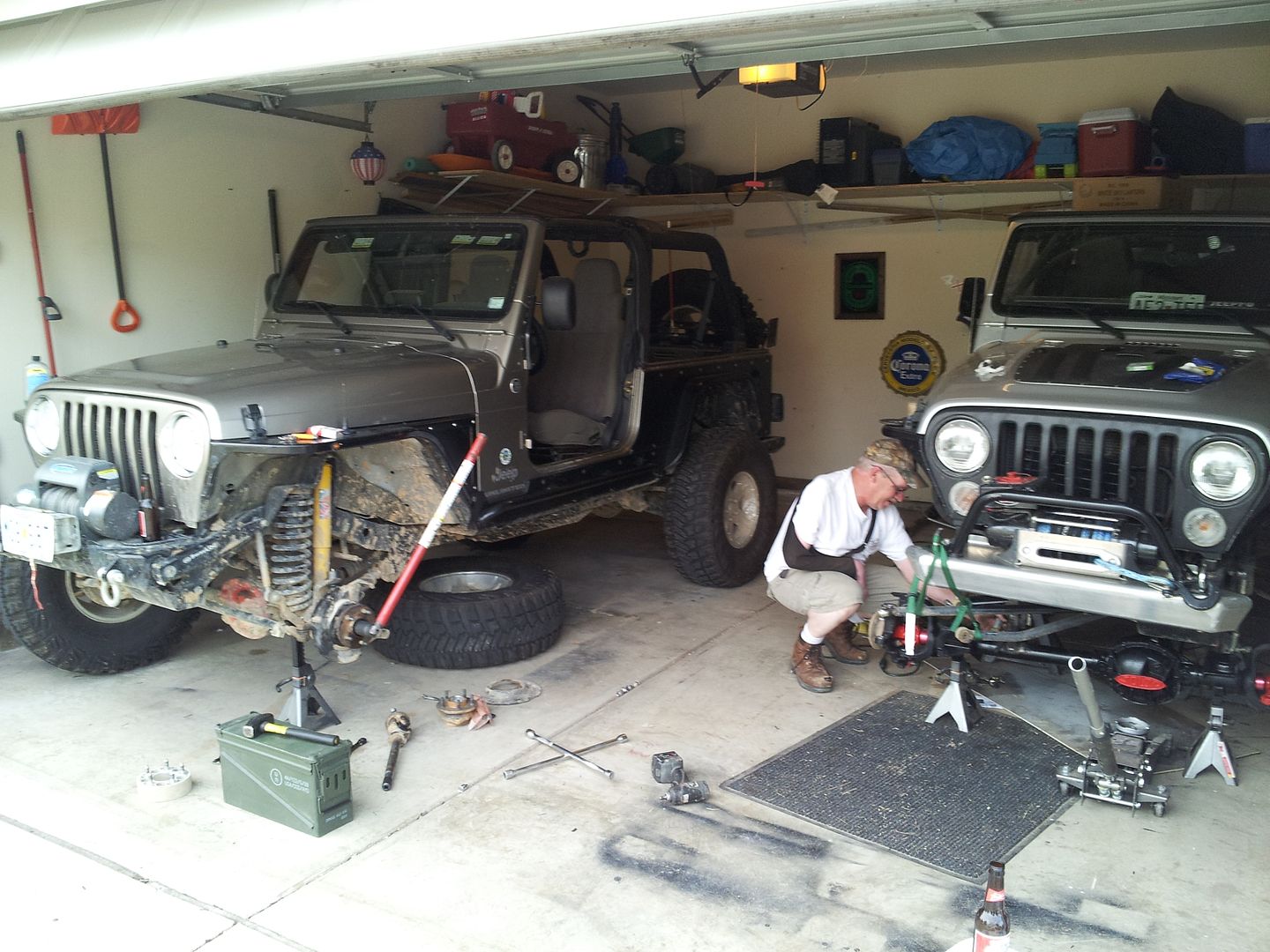

You worked a man so hard he had to get a sling ? I am not coming to your wrenching parties ...

That's my wheeling buddy Bandit. (one armed bandit..) We actually don't get much done, mostly beer and BS.

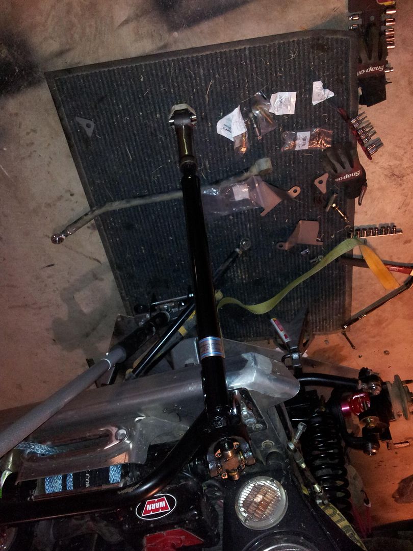

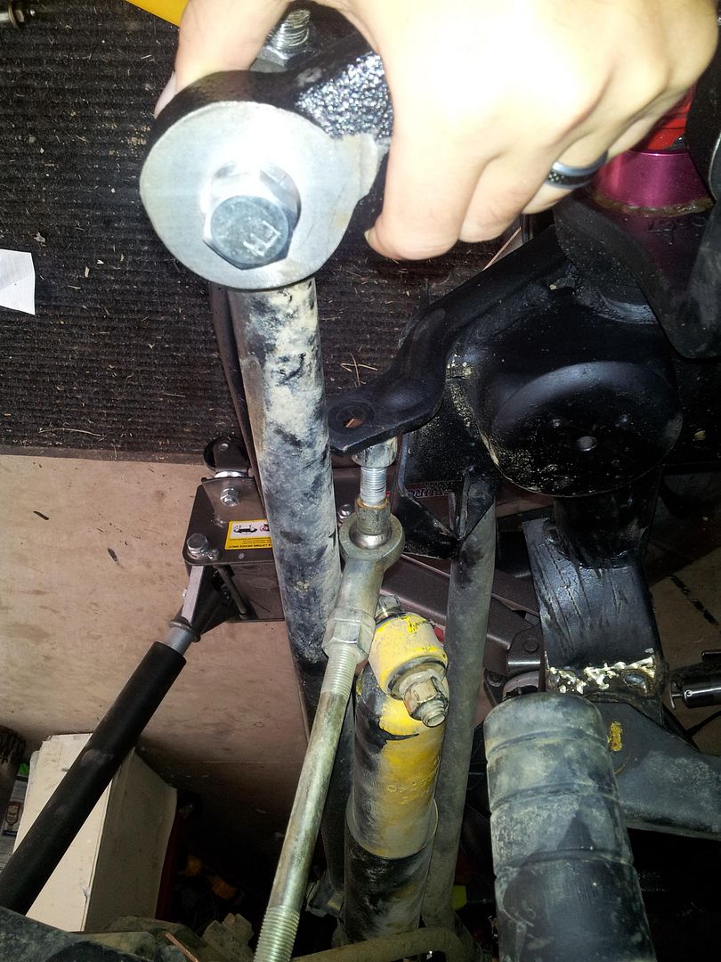

Got the steering finished on mine. Any comments, concerns or suggestions would be greatly appreciated.

I can't tell from the pics, but make sure the tie rod doesn't come up into the pitman arm at full bump cause that would not be good. Also you may have a little bump steer since your drag link and pitman arm are at slightly different angles.
You mean drag link and track bar?
Good work though man!
I still have about an inch of clearance, but I will check again at a loading dock before heading out.
On the different angles, I am still searching for a solution to that. Hopefully it isn't too bad.

If you don't drive it down the interstate then you are perfectly fine with what you got. Hitting a bridge bump at 80 mph is scary as hell with bump steer. Only way I can see to fix it is a completely custom track bar but that is alot of work.
Also to get on the same page, when I say full bump I mean both sides full stuffed. I'm telling you to check because that is where I had issues and I had to limit my travel so that the tie rod doesn't go banging into the pitman arm. But I have roughly 2 inches of stretch in the front
