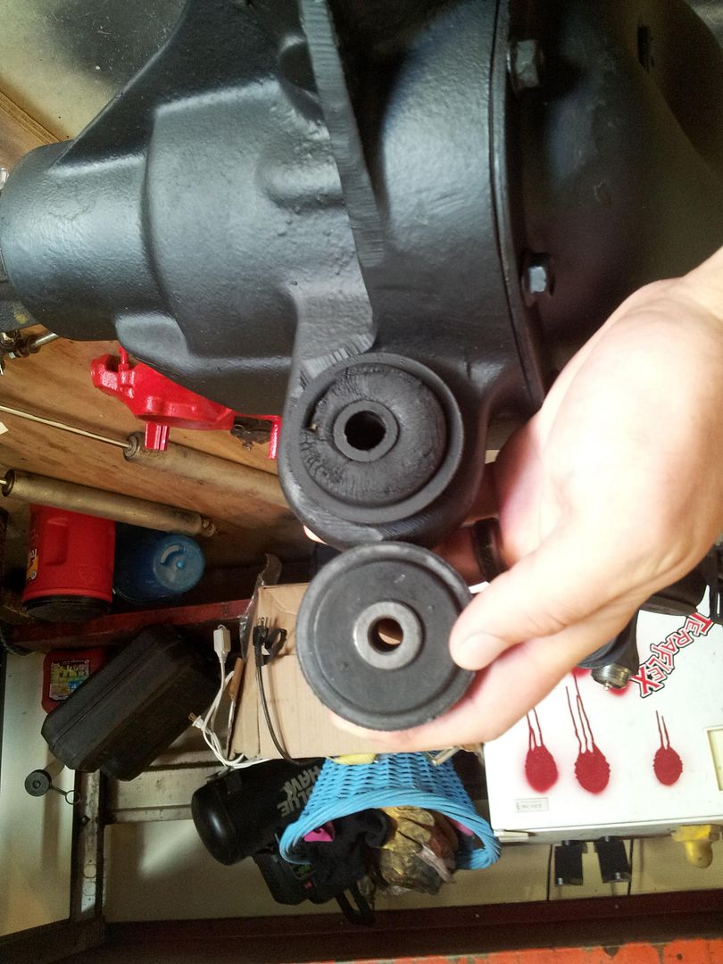

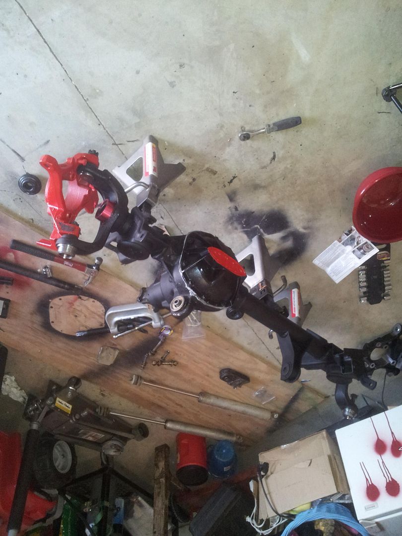

Almost back together. Just need to weld on the PS Johny Joint and ream the teraflex knuckle for heims. Hopefully have it done this weekend.
The ECGS axle overall was great. I have to admit though, I was disappointed they didn't even bother to put in new bushings. If I was not replacing them with JJ I would be pissed. It was so dry rotted that it came apart when I tried to press it out and the sleeve was a PITA to remove.
Holaday is offline
post #465 of 1042 Old 07-18-2013, 06:58 AM
G Beasley
Join Date: Nov 2001
Location: Eden
Posts: 5,708
The axle looks good , but I am also surprised about the bushings . Before you cut off the passenger side mount make a template so that it will be easier to line the JJ tower up when you weld it up .
