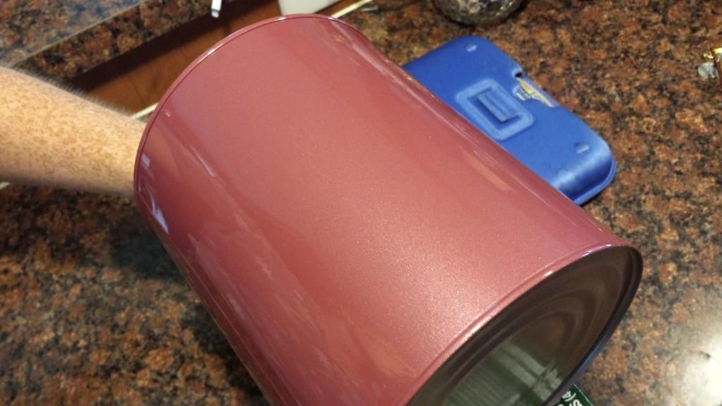

So the home brew left over paint worked out so good on the stretched yj that I decided I would see what I could do for this one. She wants a pinkish color. This came out ok, sprayed a test panel on a paint can! I'm not sure if I will use it yet. I'm going to price out some "Pink Panther Pink" as I want something a little more high impact.

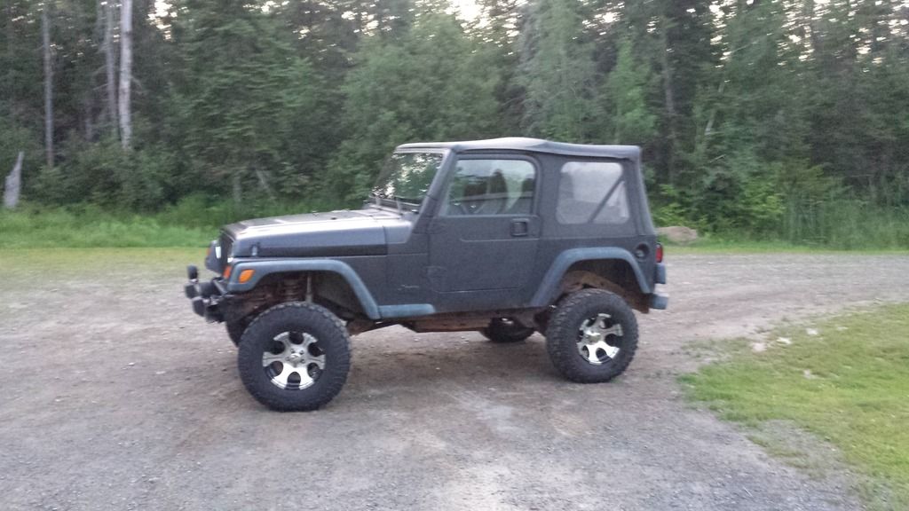

I ditched the awful grill guard and swapped in some Harley Davidson headlights!
I replaced the worn out original tan soft top with a sailcloth top from a late model tj. I got the top free from a friend! The rear window has a very small crack. My plan is to pick up a set of tinted windows for it.

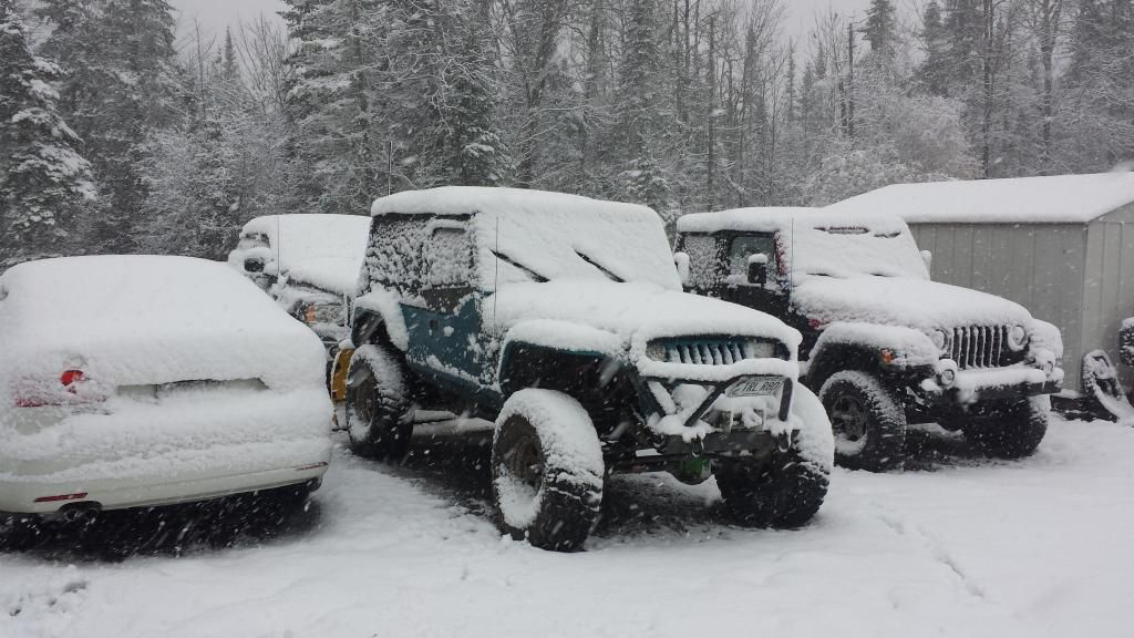

I need a larger garage! I hate that they can't all be inside during the winter! I suppose if I got rid of the Demon and Trans Am we could fit them!

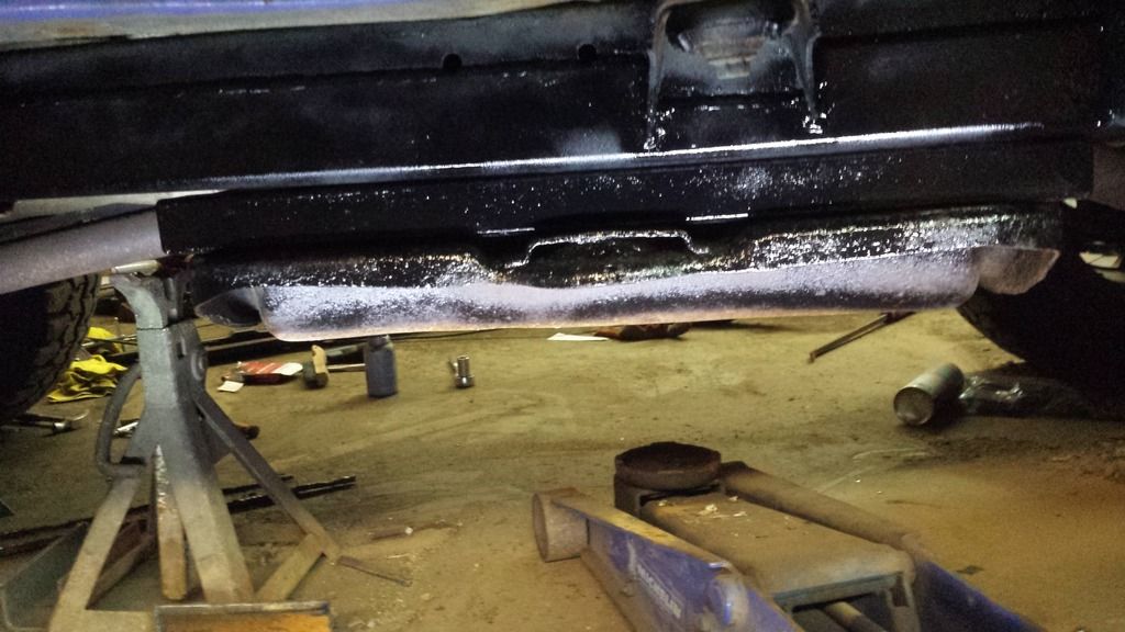

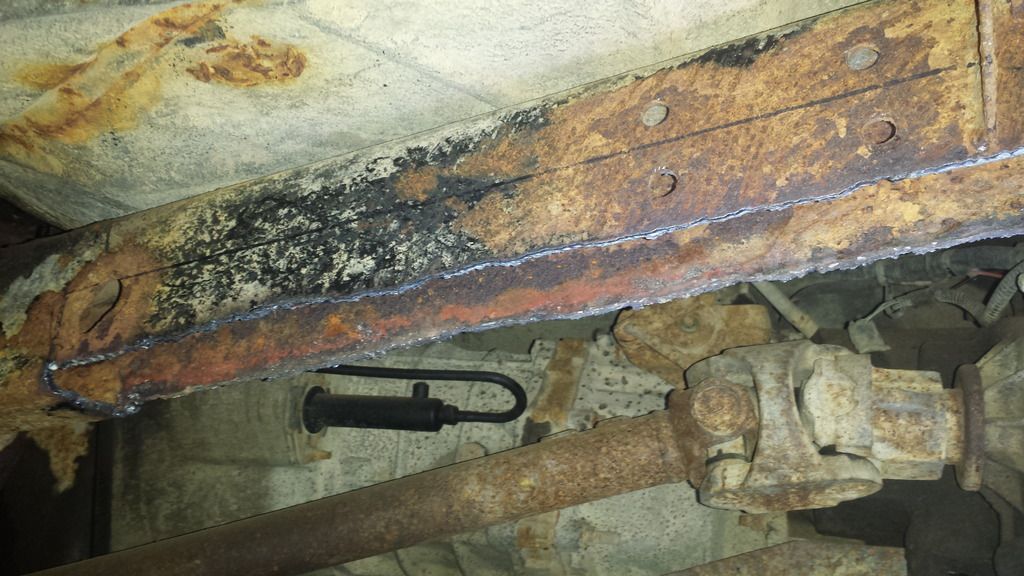

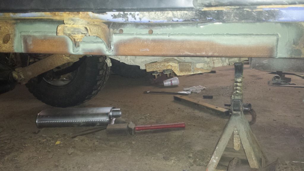

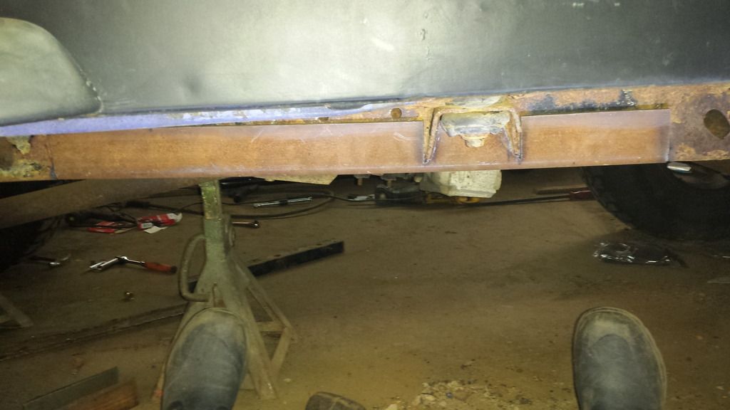

Finally had a chance to get under this thing and scope out what it needs for repair work. The skid plate bolts had pulled through the skid on the pass side and the PO welded steel rod to the skid and the side of the frame to keep the skid up. I cut those off and lowered the skid. The frame really wasnt all that bad but the nutserts were broken free. I used some 3"x5"x.25" rectangle tube cut in half to repair the skid plate mounting area of the frame. This tube works great as it slides right up onto the frame with a snug fit. Prior to welding in place I drilled holes and welded in some nuts for the skid plate mounting. I used my shop vac to clean out all the rust scale and dirt from inside the frame while I had it cut open. I also used a blunt tip in my air hammer to free up as much rust scale from inside the frame before installing the patch. Once it is all done I am going to treat the inside of the frame with some Fluid Film.
Outside welded in place before paint.
Inside with some paint.

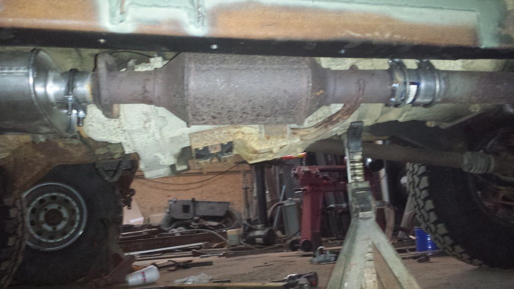

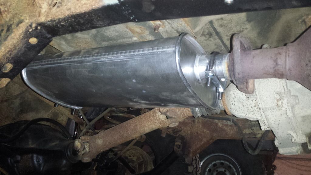

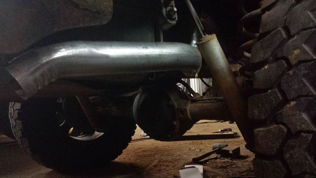

Last night I put the new exhaust on the Jeep. The previous owner had removed the converter. I installed one I had in the shop.

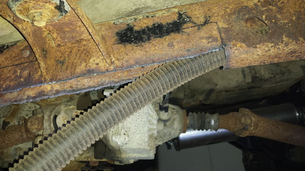

I also began the rust repair on the drivers side of the frame.

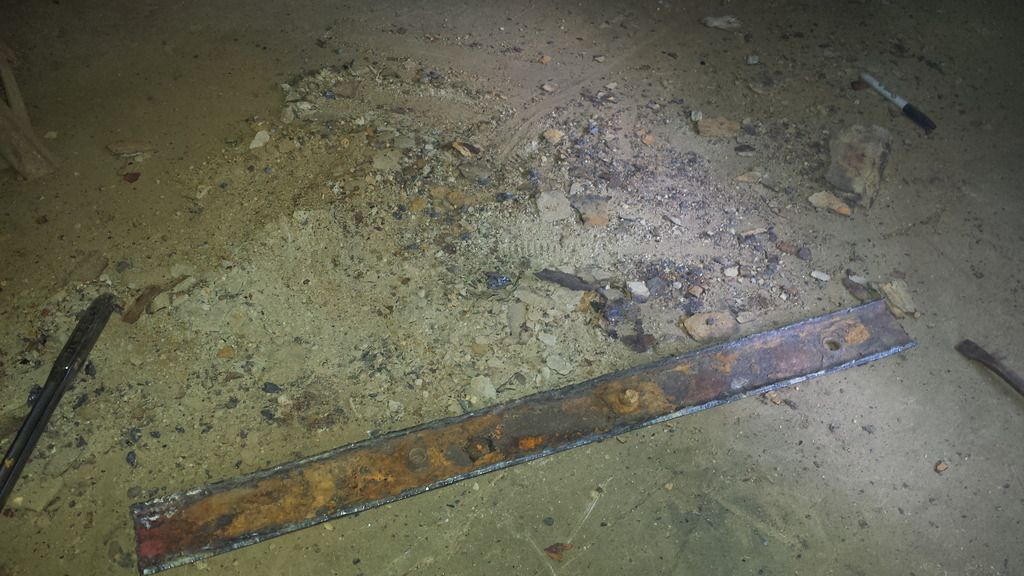

cut the lower part of the frame off to patch in the skid plate mounts. This was the dirt that fell out when I removed this piece!
this is what the frame looked like opened up. I used a body hammer and long pry bar to remove all the rust flakes from inside the frame.
I used my shop vac to remove all the dirt and rust scale from inside the frame rails.
Tonight I am going to finish up the drivers side rust repairs. Then start prepping the frame for paint.

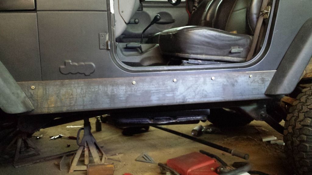

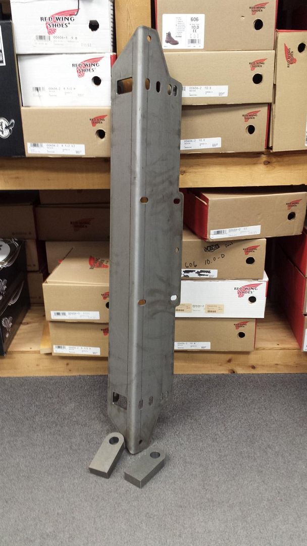

I began building the rock sliders with tube steps. These are 3/16" plate steel that cover 6" up the side of the tub and 6" under the tub. They are mounted to the side and also to the torque box support under the floor.
Here is the tube I bent up for them.
