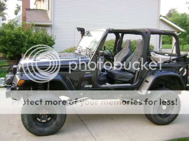

Pictures of the Jeep after the lift: Only have cell phone pics of it during the install.
I also got a Warn M8000 winch, which was already hooked up at that point. You can see it in the pictures above.

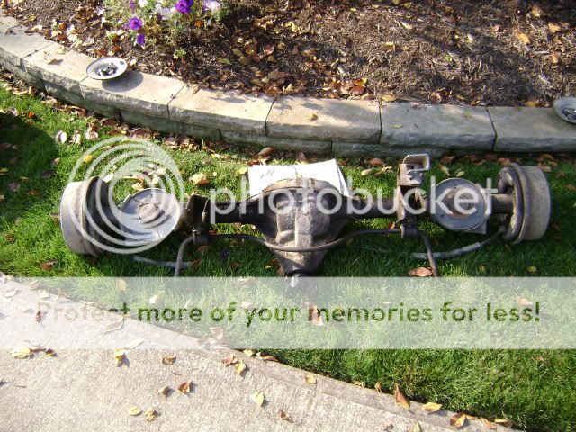

I had picked up an Exploder 8.8" from a junkyard in Daytona Beach at college, and it was CLEAN! However, it had 3.73 gears, which would never cut it.
Exploder 8.8 from the u-pull-it:
Before leaving Florida, I began a little bit of work on the 8.8, cutting off the old spring perches and grinding down the welds.

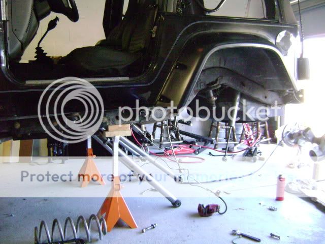

Beginning to pull the Dana 35:
Got the Dana 35 out as it got dark:

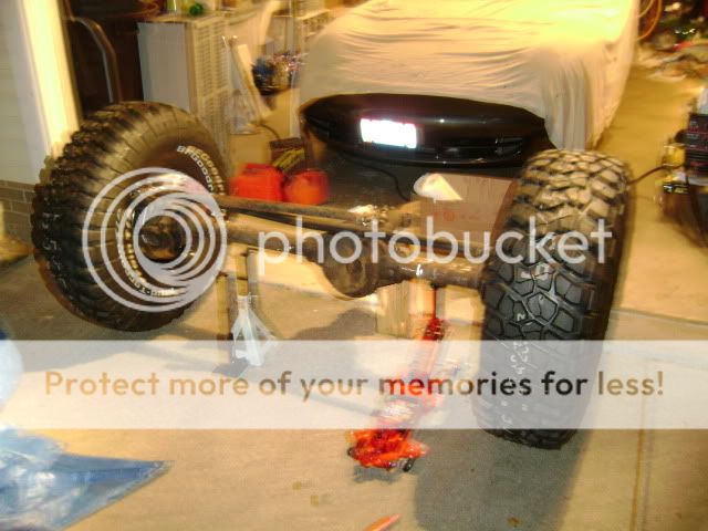

Got the axle under for the test fit, and didn't actually put the CAs in the mounts, just rested them on top to make sure it was close. Everything lined up fairly well, and I have adjustable CAs, so I figured the pinion angle would be fairly easy to set after burning in all of the welds.

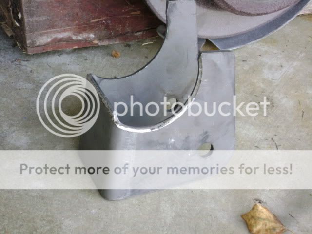

Here's one of the Mad4wd brackets that I used. They were nicely made, and I had to do minimal grinding to get them aligned on the housing properly. 3/16", and strong.
Preview of the final product:

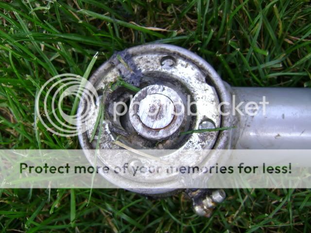

Monday: I assumed that I would get the axle under the Jeep today, but failed epically. Had to grind down the bushing for the axle end of the lower control arms since the Mad4wd brackets were slightly narrower than my D35 brackets. Uppers fit in fine, but the lowers were a pain since I had left the top end connected and the axle end was the rubber bushing style. After hours of messing with them, I finally got all of the control arms connected. The pinion angle at this point was about 45 degrees, but no big deal right? WRONG! When I went to adjust the lower control arms, they were STUCK!!!!

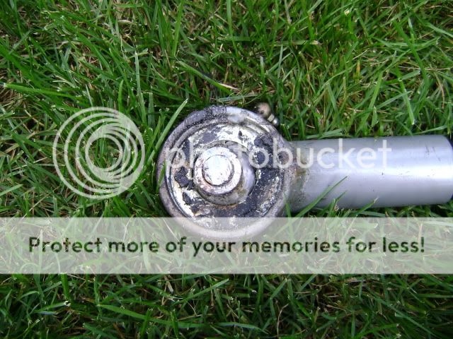

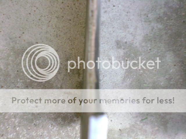

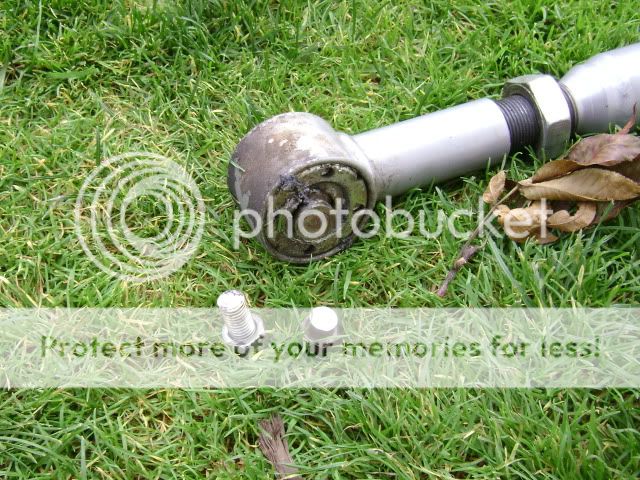

I cranked on them to try and unscrew the female end to lengthen them since the axle needed to move back anyways, but no dice, they wouldn't budge.
Next I tried to remove them to work on them, and the passenger side slid right out, but when I removed the final bolt on the driver side skid plate mount, it did NOT slide right out. No problem, I'll just grab a hammer, right? It didn't budge after smacking it with a hammer, either. Eventually, I tried using a spud bar and sledge hammer to get it out, but it wouldn't move at all.
After messing with it for the rest of the day (a good 4 hours or so) I gave up and went to bed, defeated and out about a can of PB blaster and propane. The next day, I soaked it with a bit more blaster, hammered on it a little more, then finally decided to cut it. Fortunately, there was just enough room between the control arm bushing and mount to fit in a hacksaw blade. My brother and I proceeded to cut the grade 8 hardware with a hacksaw (took about a half hour for one side.) Hit it a few more times with a hammer, and it still didn't budge. Rented a sawsall (didn't have one in Ohio) and cut the other side. Tried to press out the rest of the bolt, but it was too solid.
After this, I called in a favor from a friend at work, took it into the shop I used to work at (at a golf course maintaining mowers) and used the torch there to heat up the spherical part of the bushing red hot, then used an air hammer to get the bolt out. It was so stuck that it took 2 heatings to keep the sphere hot enough for the air hammer to get the bolt out.
To get the control arm ends to turn, it took a red hot heating from the torch and a 36" pipe wrench to break them loose. Quite a lot of force, thinking about it, but the only casualty was the powder coat on the ends. So the lesson I learned from this wasted day? USE ANIT-SEIZE ON EVERYTHING I INSTALL!!!!! It would have saved me a lot of trouble, as all of these problems are from 6 months of rust! Only 6 months!
I was pretty frustrated, but here's the pictures I did take:
That bolt was stuck like a pig at a barbeque! I couldn't believe it was just from 6 months of rust, as the shoulder in the bushing was smooth.
The CA end wouldn't turn either. Man that was a fiasco.

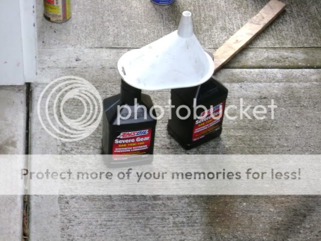

Diff fluid waiting to go in. I ended up needing twice this much.

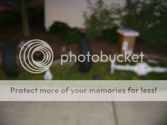

At this point, I was really worried about getting back to college, so Tuesday and Wednesday sort of ran together. Long story short, I worked all day Tuesday, test drove around noon on Wednesday, finished up Wednesday afternoon, then left for the 1000 mile drive Wednesday night at 10:45.
Unfortunately, I made that drive with a Dana 30 geared 3.07 under the front, so I'll be a pretty ineffective Jeep for the next 6 months.
I swear that the D44 was taunting me at this point (Tuesday night, I believe.) But I had to ignore it and finish up the rear and hit the road:
I'll cover the D44 build in more detail when I put it under there, but there was a bit of work put into it to say the least. Plus, if anyone needs 8 lug D44 or chevy 10 bolt parts, give me a ring, I've got 4 spindles (long story) 2 hubs, 2 discs, and 2 brake caliper mounting plates.

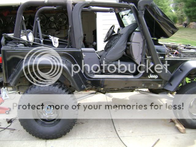

So for the axle swap, here's a quick before and after:
Before:
After:

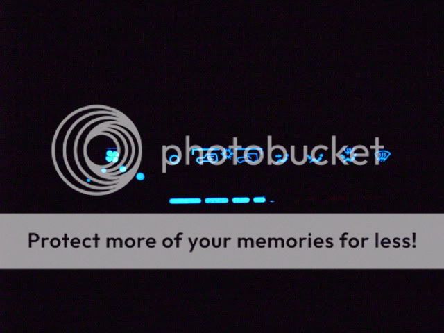

LED gauge project. Cost about $20 and looks great. Got all my info from this thread (thanks to everyone who posted and helped out.)
http://www.jeepforum.com/forum/f9/ga...nstall-752937/
Gauge cluster:
and HVAC:

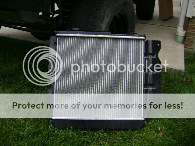

My radiator also blew up about a week before the axle swap, so I replaced that as well:
New Radiator:

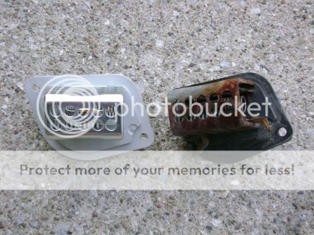

Another thing that I fixed this summer was the HVAC blower motor resistor. Ever since I got the Jeep, the heat/air has only worked on high, and the other 3 settings have been 'off'. Picked up a new resistor with the radiator, pulled the old one and saw pretty clearly why it didn't work: There were leaves/dirt/twigs stuck in it, and it was one rusty resistor!

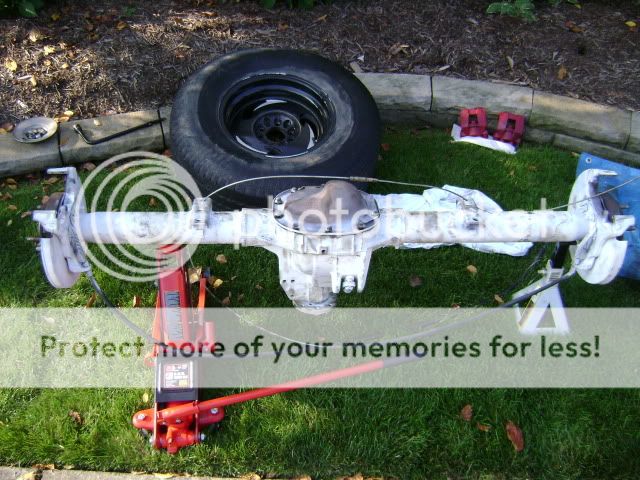

So after replacing the master cylinder and brake booster (which was busted, sucking air in) with a Cherokee booster, the brakes still weren't up to par. I figured it was air in the system, and I'd bleed them again when I pulled the rear axle to paint it. Finally got around to that last weekend since some of the mounts were beginning to rust a bit. Turns out, I had the darn calipers upside down, bleed screw was on the bottom so air was staying above the stream of fluid coming out, hence the soft brakes.

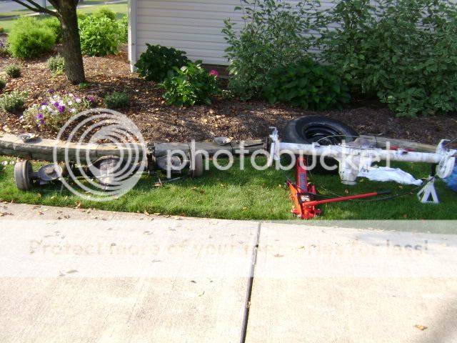

So I got the axle painted, threw it back on, and fixed the brake problem. Brake pedal travel is now about 25% of what it was, nice and firm, and I can lock up the wheels really easily, especially the rears since I took out the rear seal on the proportioning valve (Not sure if I like it that way though, I might put it back in.)
Here's a few pictures of the rear end painted silver. It doesn't quite match the RE control arms grey color, so I might just Herculine it if I decide that the silver is too bright.
Pulled the axle:
Looked like this:
So I hit some of the bare metal with brake cleaner and primer:
Painted, it turned out to be slightly blinding:
And under the Jeep, looks like this:
I'm going to wait until I get the Ox locker diff cover on (it's on the list of things to do) and see if it looks good with the black diff cover. If so, I'll leave it. If not, herculiner it is!

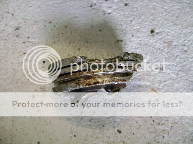

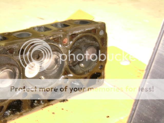

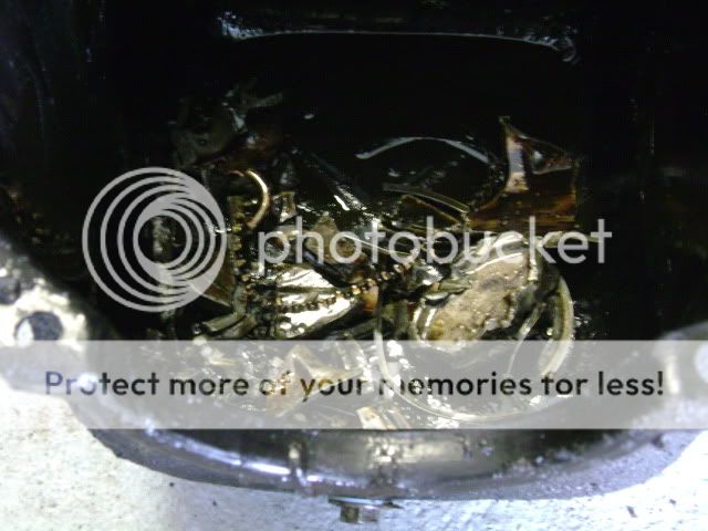

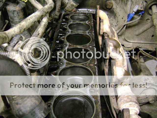

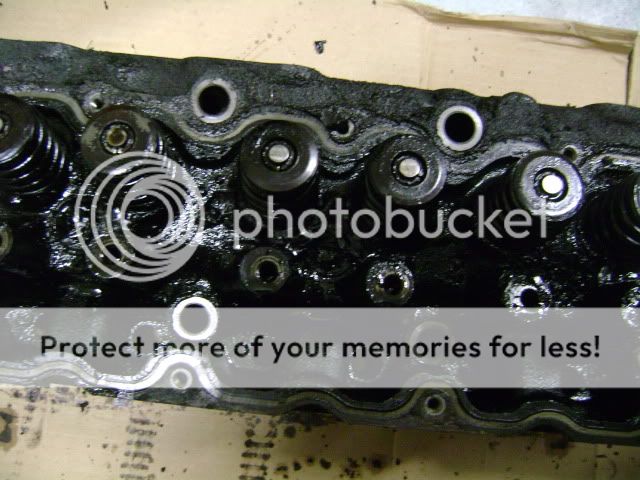

Next step in the project is to try and save my 4.0 from a drawn out death. Developed an engine tick a week ago due to low oil level, not sure if it's leaking, burning or if it wasn't filled all the way at the last oil change (I hate having other people change my oil for that exact reason, but I had no time and was a dummy for not checking it sooner.)

Pulled the lifters over the 3 day weekend, took pictures during the replacement. The following, however is pretty much a moot point because I'm almost positive the 4.0 took its last breath today. The tick hadn't gone away after replacing the lifters, so on my way back from buying a stethescope at Harbor Freight, the 4.0 tick got louder, then it started running really rough, RPMs dropped to zero. I gave it a rev to bring it back to life, but then it was running really badly, so I pulled over and got my roommate to tow me home with his truck.
Pulling the valve cover and pan to see if any damage is really evident. If so and it's fixable, I'll fix it. If nothing obvious shows up, I'm going to the JY or getting a 98 TJ 4.0 off craigs list.
Here's the pics of the uneccessary lifter replacement:
There was a ton of sludge on the rockers and on top of the head. I cleaned it while it was off.
Kept all of the push rods in order
Intake manifold
Motor with the valve cover off
Then I pulled the head: It was a mess inside and out, especially cylinder #6
And lots of sludge
The piston on #6 wasn't much better:
Everything I took off:
Old lifters:
New lifters:
Clean head back on the motor:
In the end: it was a royal waste of time, apparently . Oh well, if I save the block, I might just start a slow stroker build as I get the funds for it. I guess I need to make some cash.

4.0 is officially dead as of today. Even though the 10th was when it died, I had to go out of town the next day, and just got around to dropping the oil pan today. Didn't expect to find THIS!
Apparently the #6 piston (which didn't look good before) was only a few miles away from exploding, because that's pretty much what happened after the lifter job. My guess would be that one of the valves failed to open, as I found that one of the rockers had a lot of play in it when I pulled the valve cover again after the 'incident.'
Here's the only piece of the piston that was still in the block:
I pulled the last piece out of the block: it was in rough shape.
