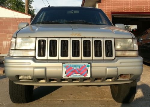

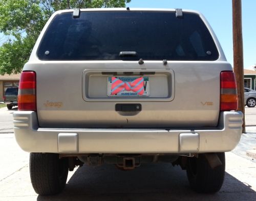

Here she is.

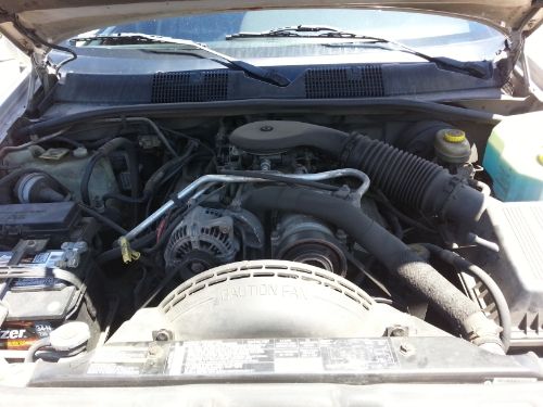

5.9l 46RE NP249
D30/3.73 front
D44a/3.73 Rear
Sits 19" front/rear from center of hub.
P245/70r16 Falken Ziex S/TZ

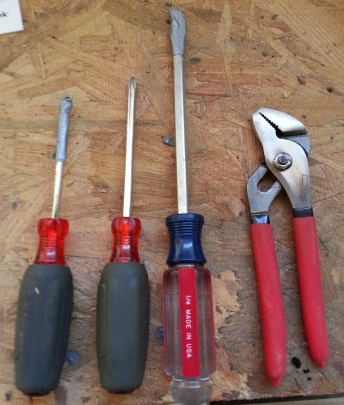

These are the tools I used to remove the cladding. I wrapped a Standard and a Phillips head screwdriver in duct tape to avoid any unnecessary scratches.

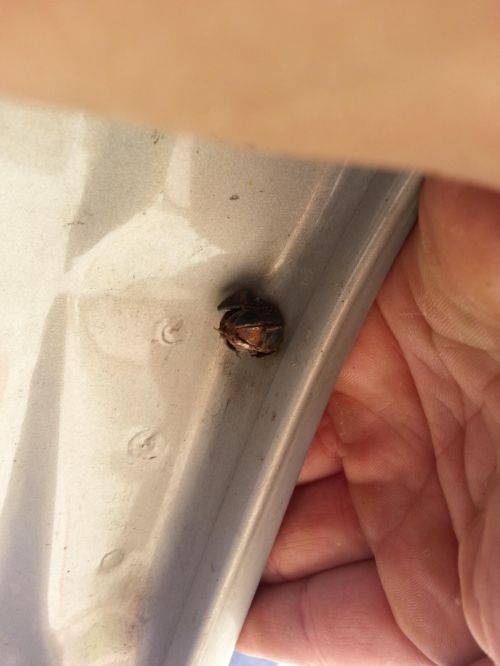

The back door trim is held on with 4 clips and a bolt located on the inside back edge of the back door. It is a (not sure what it is called) weird flowerbud looking nut. I forgot about it on the drivers door and ended up busting the bolt off. That was the only casualty in my removal. The passenger side nut must have been banged by something as it was deformed.

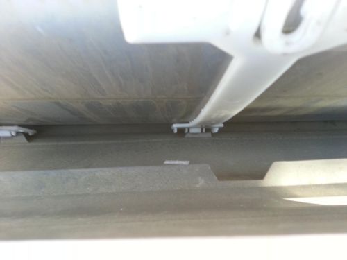

Once the top is freed from the clips, the bottom is just a matter of popping the tabs out of the compression slots on the bottom. Here is a look behind the cladding at the bottom of the clips.

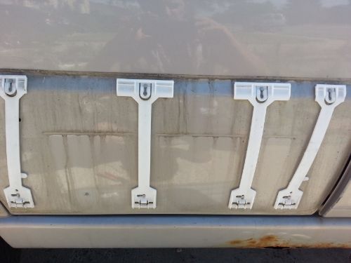

Here is a shot of the rear door clips with the cladding off. Notice how dirty it gets under there. A little windex wiped it all right off. I was surprised that salt didn't get back there and start some rust.

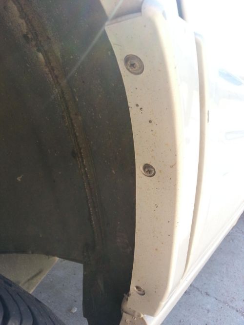

The front piece is held on by 3 screws located in the front wheel well and one clip attaches it to the body.

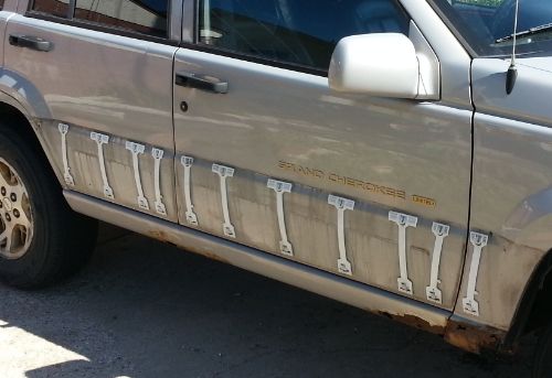

Here is a shot of the clips on the wagon (and the dirt of course).

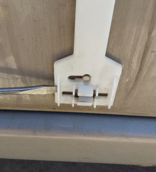

To remove the clips i used my standard screwdriver again. Place the screwdriver against the left side of the clip and give it a little tap to the right to pop the clip off the stud that holds it on. then with that loose just slide the clip upwards to free it from the top stud.
When done you have a pile of 22 clips. Hopefully all intact. I got all mine off with no damage.
And finally here is a shot after getting it all cleaned up. I think it looks alot better without the plastic so I think I am going to keep it off. I also debadged to drivers side. I like the clean uncluttered look.

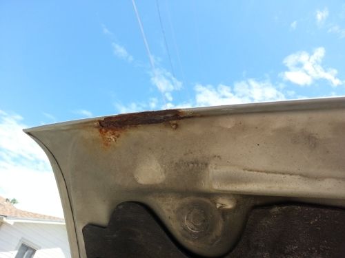

Rust!!!

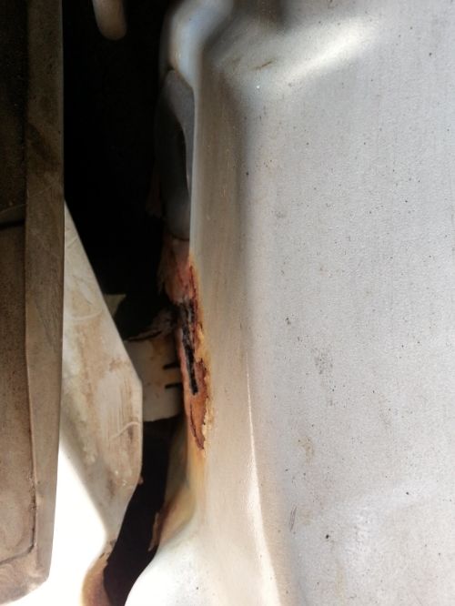

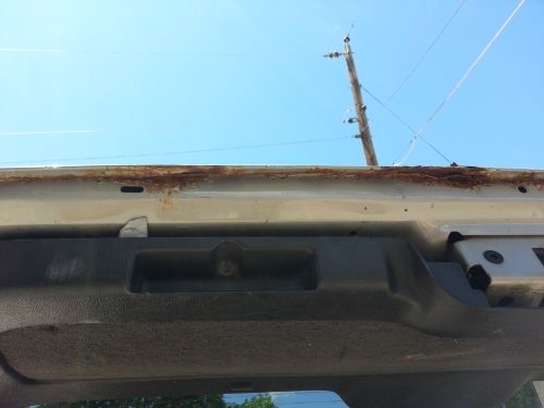

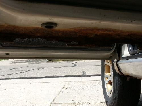

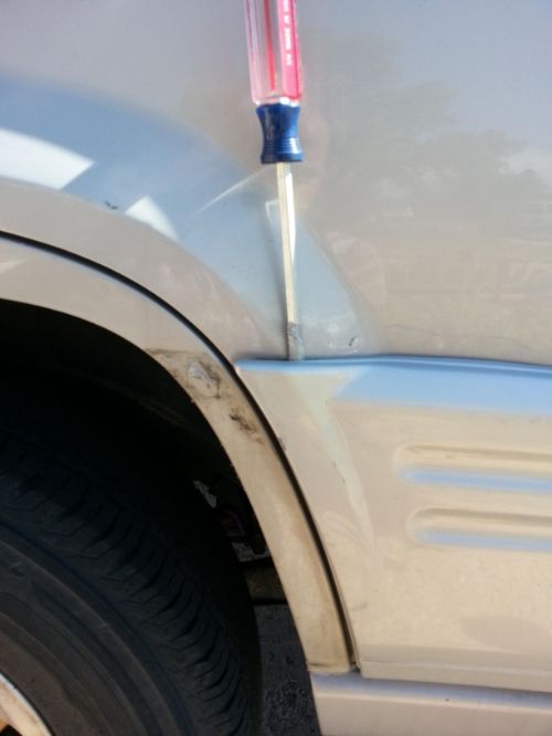

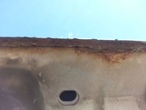

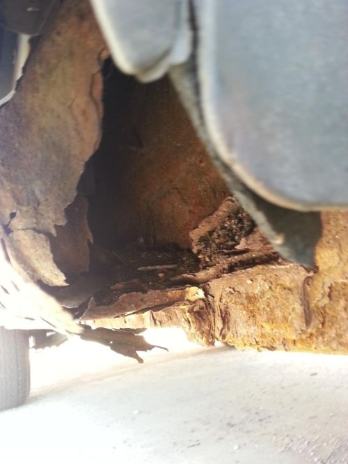

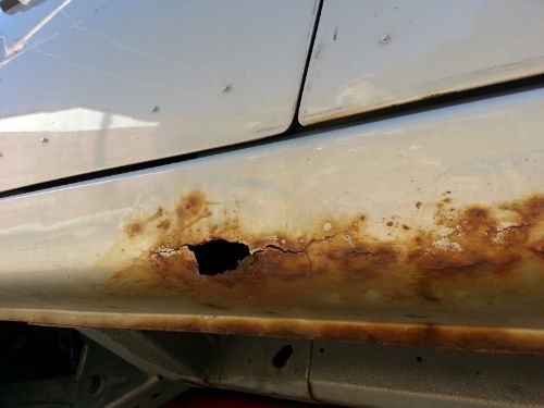

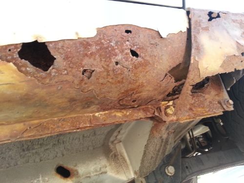

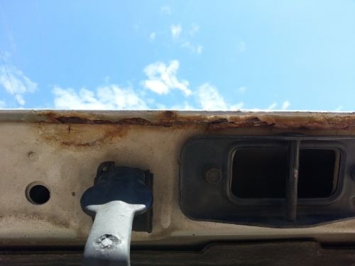

Rust assessment was better than I hoped. I am going to have to replace both fenders, hood, liftgate and rear drivers door. There will need to be some repair to the A pillar/front cab corners as to be expected but all in all not quite so bad. The unibody/undercarriage on this rig is almost immaculate. I am not pulling the carpets yet but judging from the underside I don't expect too many surprises there. The rockers are pretty much toast but as I am planning to cut them out and weld in slides I am not worried there at all. I am sure there will be more surprises in the future as i start cutting away, but that will be for a later post to go into.
Hood.
These two dents have always baffled me. I made the assumption that a 500 lbs. stripper named Hilda did a two step on my hood.
Drivers Fender/A Pillar.

Rear Hatch
Passengers fender/A pillar/rocker
Most people would not bother with this and ALOT of them would probably consider this junk. I look at it this way. I have had 6 years to learn the quirks from this jeep. I could buy another rust free jeep for a couple thousand and then hope it is as good a runner as mine. I look at all this work as an experience to get to know my limitations and build on my skills and knowledge, plus I am starting a couple grand ahead to buy parts with.
This will actually be a relatively easy task as far a rust repair goes. Prep is of course the key. It will take me some time to gather all the parts to get this stage completed. I will post an update as soon as I get started.

Unless someone did some extensive parts swapping, that's a 5.2, not a 5.9. If it does not have Z88Z in the VIN, it's a dead giveaway.
Yep. a 5.2 unless a swap was performed.
