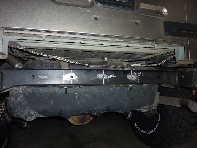

rear winch bumper...
from the start plan was to have a winch-receiver type of setup for the winch, as I had done on the XJ.
Liked the concept, liked the idea, just didnt like having to carry that heavy thing front/back as needed.
What is better than a WARN winch???... of course... 2 WARN winches...
so now its a matter of fabricating a rear winch bumper.
have seen a lot of other great setups, but not many to my liking on Wranglers.
Point of making everything as functional as possible, yet maintaining a great esthetic look, as not too cluttered, and keeping the departure angle at its best...
Off we start...
cut off the rear cross-member to be able to tuck it in as much as possible...
cut the tub section in order to keep the winch as I wanted to...
with a little work, had put on a winch plate on some square tubing & secured it to the frame...
get things welded up & move on to the next step...
Nikson is offline
