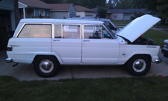

I believe that there are two quotes that can best describe my progress for the day: 1) The best laid schemes of mice and men often go awry, and the more direct 2) Two steps forward, One step back.
Tires, successfully mounted, waiting to carry the Jeep:
And better yet, successfully installed:
'twas getting dark when that picture was taken, I'll get better ones yet!
That was one of the two forward steps, the second forward step was installing the new alternator. There is a bracket on the alternator, that runs between two of the four studs on the back. On this new unit, I was momentarily put-off when I saw that the wire-mounting-stud was bent. Then I was further put off when I saw that the original part was shorter than this new blue piece, not allowing me to swap in the unbent original. Then I realized that the old part went across the "top" two studs, while this went along the side. Crisis averted, original part installed, new blue part set aside...
No alternator... (Yes, I have replaced the air filter...)
Alternator!
There will most certainly be a new witing harness making its way in to the Jeep at some point in time, but for this startup there is just the 47 year old harness. Between the age of the wires, the (hopefully) increased output of the new alternator, and the possibility of crossed wires (I labeled mine, but I have done worse) I figured a smoke watcher/fire extinguisher holder would be a good investment (my particular model is called "Helen").
Still not charging! So onto the voltage regulator, which is a special order part. Either it will solve my charging woes, or it will be a good replacement of a more than likely 47 year old electrical component. SO either way is fine by me, but I would like a charged battery, and to no longer have a net drain on the battery when the lights are on. About a weeks wait for that component, of course being the one step back.
So I broke even for the day?
