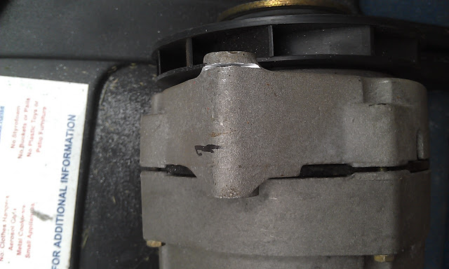

Charging system woes are no more!
I hate messy wiring… Actually hate is an understatement. So my final fix for my charging system is even better than originally thought out. A few weeks ago I bought a replacement alternator, a stock replacement, and discovered that my battery still wasn’t charging, which pointed the finger at the voltage regulator. For those who are thinking that I mean that I got a bad alternator, the voltage regulator for these old units are external, mounted on the fender. So I had the parts store order one, of course it was a special order. I picked it up this past Saturday and began a few hours of electrical fun.
First the new regulator I bought is a Delco part, it has clamp-down terminals to run the wires to, while the original Motorola part uses an electrical connector. No big deal though, the wiring is straight forward, and I couldn’t find a replacement for the Motorola part, so I began tracing wires to run. And I ran right into a brick wall. A voltage regulator requires a constant 12 volt source, easy enough, also a switched source (thru the ALT warning light on the dash), and two sources from the alternator: field, and stator. Well I know there are wires coming from the alternator, and I know there are wires coming from the dash. For the life of me I couldn’t get what should be the switched source to trip a test light when I turned the key on, probably an issue. Then determining the field and stator wires from the alternator would have been a simple matter of looking up a wiring diagram of that model alternator, but I never got there. While staring at the wiring coming out of the alternator I realized that the output did not go to the battery… It went to the voltage gage the previous owner installed on the dash… He (She?) ran the output from the alternator straight thru the firewall WITH NO FUSE BETWEEN THE ALTERNATOR AND THE FIREWALL to the voltage gage back thru the firewall to the battery WITH NO FUSE BETWEEN THE FIREWALL AND BATTERY. So, at this point I was staring at the wiring and getting disappointed, and it dawned on me: Why am I putting an alternator in with an external regulator when I could put one in with an internal regulator, eliminate 2 wires, one connection, and have a more readily available replacement part? AND I HATE MESSY WIRING TO BEGIN WITH! Yeah, that was a special moment.
My brother happened to have a Delco 12SI alternator he wasn’t using, which made this change over all the more appealing. Here’s what you do:
1) Modify the mounting bracket on the alternator to fit the Jeep. This requires cutting the mounting tabs, I used a hack-saw. Also a section of the housing must be filed away as well to clear the adjusting arm.
2) Install and wire the alternator, you will require 3 wires. 1 wire from the output to the battery. 1 wire from the switched source (ALT light) that I was having trouble finding earlier to terminal #2 on the alternator. I chose the wire it should be, cut back the old connector and voila, the correct switched source (corrosion and electricity doesn't work so well). And finally 1 wire from the battery to terminal #1 on the alternator so it knows how much charge the battery has. This can go straight to the output of the alternator, but I chose the battery due to the extra resistance of the wire, should have the alternator working at a higher output.
Here the wire with the short RED lead goes to the battery, the YELLOW wire goes to the "power lug", the GRAY wire goes to the ALT light and the solid black wire goes to the battery to gage its charge.
That’s it, the other wires remaining from the external regulator can be cut and removed from the harness. This was so simple it’s stupid not to do, unless you are keeping a vehicle 100% original. And now that I’ve done it, I’ve seen dozens of these alternators at the 3 car shows I went to since Saturday morning!
