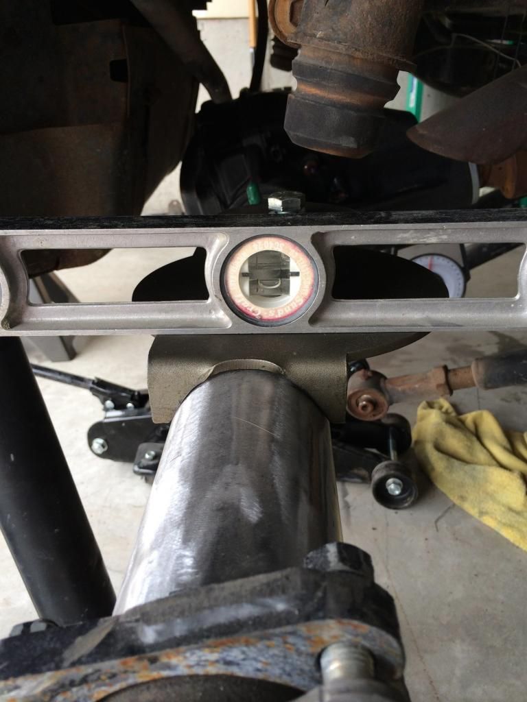

I got the axle centered under the Jeep and set the pinion angle.
Once I had the correct angle, I went ahead and centered my lower spring perches on the axle and set them at 0 degrees.
From here everything was very simple to align and tack in place. I basically set the LCA Mounts at 0 degrees as well and centered them on the axle. Listed below are a couple references that I found online for TJ axle bracket set up.
Front - http://www.claytonoffroad.com/documents/AB-FABK.pdf
Rear - http://www.claytonoffroad.com/docume...rawing_000.pdf
newman08 is offline
