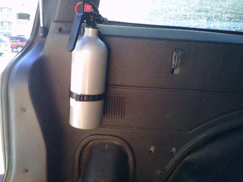

Cut, and painted the front bumper.
Added a fire extinguisher

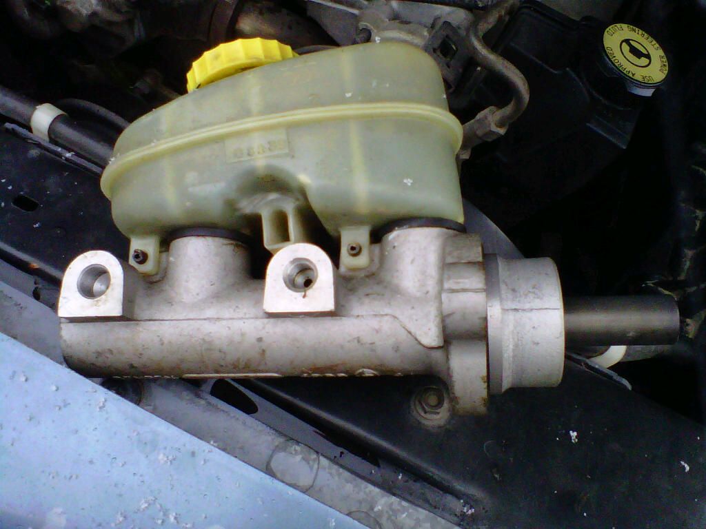

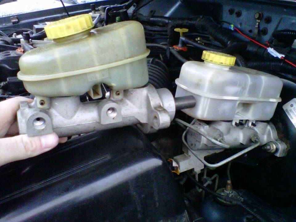

Upgraded the master cylinder, it's out of a 2002 Dodge Durango. Direct bolt up upgrade. May need to bent the brake lines a little to get the lines connected to the cylinder. It's a night and day difference.
Here's the stock one.
Here's the Durango one
Side by side comparison
