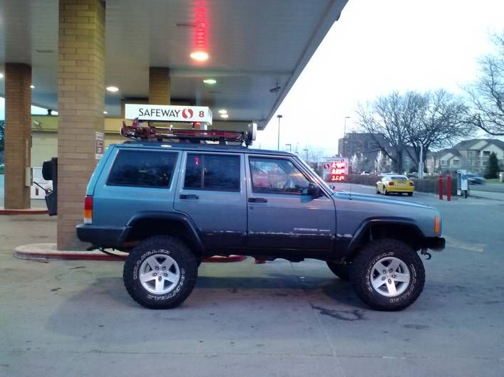

I bought and installed RC shackle reloction brackets because my stock shackles with my 4.5" full leaf pack was hitting the body of the Jeep. It added about an inch of lift and the ride is like night and day to me. Clears my 32's fairly well too.

New SYE since I haven't got one yet and it's pry a good idea with a 5.5 inch lift in the rear. Looks like I've got my weekend planned out.

Thanks man! I have been using the stock drain plugs but over the winter I've found out that I need more haha. I put my SYE in over the weekend and I should have the TC back up in the Jeep today.

Thanks man, I've got a lot more plans for it. Seems like it never ends, I'm replacing the steering today. Going to a Currie heavy duty tie setup. I love the WJ's, thinking about getting one for a DD.

Also got my new steering on. Much better, no more bump steer, or clunking.

Thank you! I definitely wanted the Rubicon wheels for 2 main reasons, you don't see them on a XJ very often and they just look awesome! I ordered a tire carrier about 2 months ago should be getting it within the next week.

Well, its kinda a long story but its the JCR 1 ton steering under knuckle setup. Now JCR's product is a good product the offroad shop that installed it for me clearly did not know what they were doing and had reamed the knuckles to big so I drove around hearing a pop and snap noise so I had took it back to them after 2 months of this and they said it was my fault because I drove my Jeep and it wallowed out the knuckles causing it to move and pop. I argued with them and they told me they weren't going to do anything unless I bought new knuckles and brought it back to them so I went to my local pick and pull and got new knuckles so this time they reamed them to small and was causing the tie rod to rotate almost 180 degrees now they blamed it on the product and said the JCR was a garbage set up. I called up JCR and they said we can sell you a spacer that goes between the bottom of the knuckle and on top of the tie rod that will help it from rotating. I installed them myself and it fixed the Jeep from going off the road but it still had the pop and snap noise so I moved to Colorado and made it but when I got up here I decided that I need to do something about it, I've heard great things about Currie so bought the setup from High Country 4x4 here in Denver area and installed it myself and of coarse had to get new knuckles again. The Jeep feels like new again no popping or cracking and drives like stock. The lesson I learned from this was either install it yourself or take it to a REAL offroad shop that knows what they are doing with all 4x4 vehicles.

No problem, yes its all bolt on and so worth it. haha
