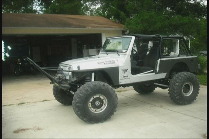

Build 1:
Skyjacker 4" suspension, 2" body
35x14.50.15 S/S SSR's on 15x12 M/T classic II wheels.

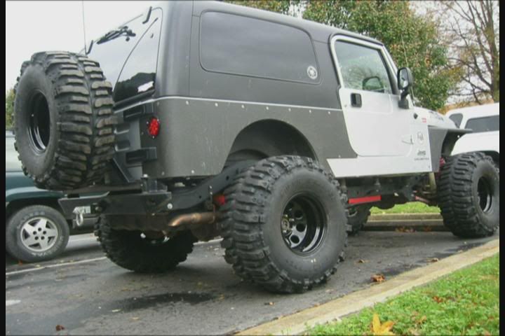

Build 3:
So after MANY broken U-joints, I decided it was time to go all out!!!!!!! I pulled the suspension lift, wheel, tires, and axles out and went to posting on the internet. I had EVERYTHING sold from it within 3 days. (Back when the economy was good)
So with a bunch of cash in hand, I set on a search for a 78-79 Ford HP60 front and a 14 bolt for the rear. I was stationed in Va Beach at the time and found a smoking deal on a complete stock housing in NJ. Luckily my wife had just given birth to our daughter so I was on baby leave. ROAD TRIP
Got the axle back home, did a complete rebuild including kingpins, bearings, seals, races, and loaded it with 5.13:1 YUKON gears and welded up the spider gears.
Order all the coil buckets and link brackets from Ballistic Fabrication and Ruff Stuff specialties, then went to welding.
Found a cheap 14 bolt that someone bought 5.13's for, along with a Detroit locker and install kit, picked it up and started linking it also. Decided to shed a few pounds from it and did a disk brake swap using cadi callipers and 3/4 ton chevy rotors.

Well, things happen for a reason right????? The U.S. NAVY decided they wanted my a$$ in Bahrain for a year. I went wheeling 1 time with the new wheels and tires, Crozet VA.
I made a decision to take it down to Essentially Offroad in Murfreesboro, TN.
It really needed a full cage, and the four links redone the "right way"
Jimmy did a great job with it, triangulated 4 links front and rear using 7075 solid bar, full cage through the dash and tied to frame, and most importantly removed the god awful body lift.
