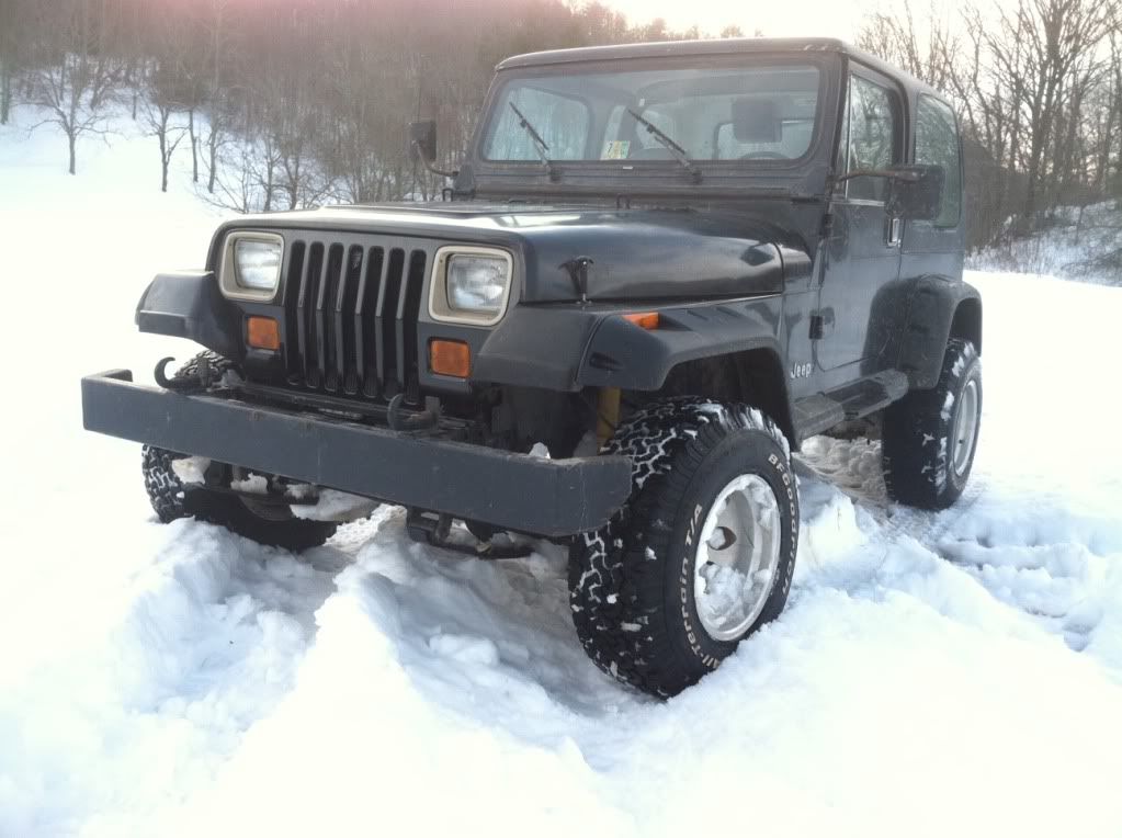

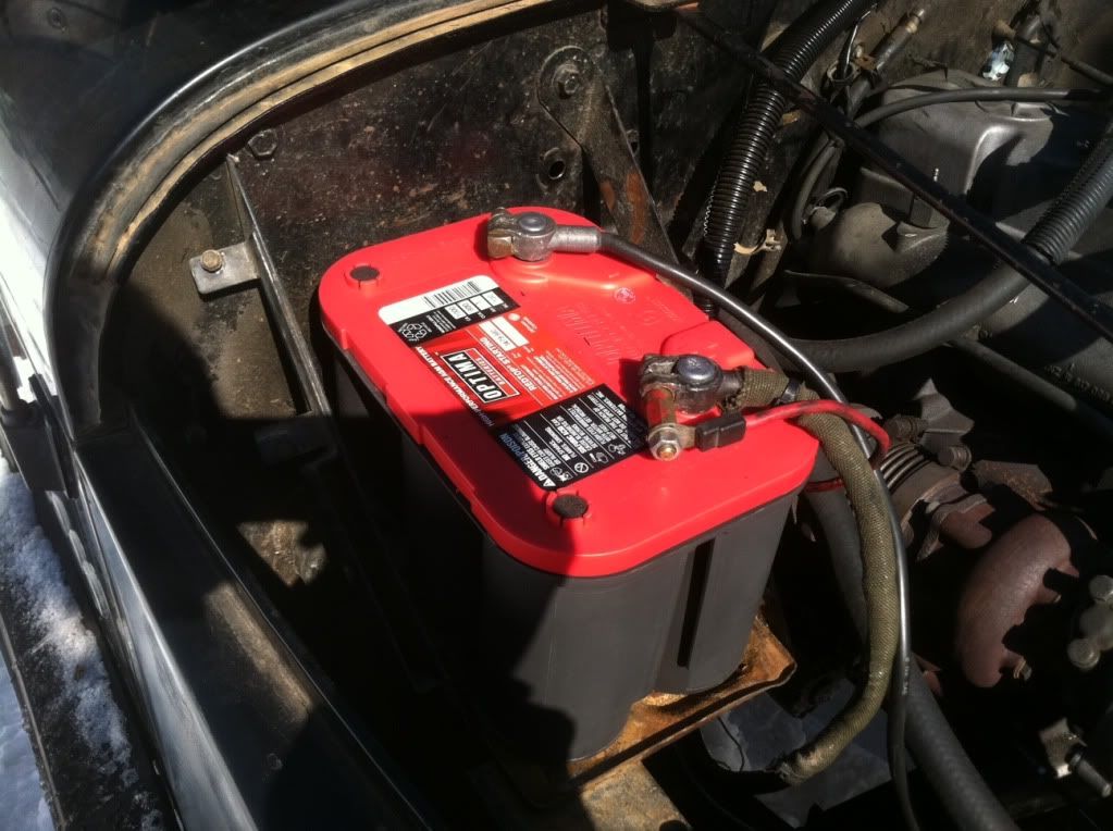

Thanks for all the positive comments guys! Here's some more pics of where I an with it now, still needs a little cleaning up in wiring (just some loom wrap, any unneeded wiring is already gone) and the heater hoses. Also the air cleaner and unsightly PCV hose with the plastic 90* will be going in favor of a Donaldson air cleaner and a moulded 90* hose.
Optima 800 CCA red top to light the glow plugs and spin it over in the cold. by removing the bolt on base battery holder on the passenger side the bigger battery clamps in perfect.
Here's the radiator fan, couldn't stand the idea of using the fan manufactures zip ties to mount it against the fins, so I made some brackets for it.
The YJ likes the snow I gave the chrome grille the boot and repainted the grille and did the headlight bezels in a tan, think it looks good.
Here's a quick video in the yard, 18" of snow, got warm today and it was getting really heavy, hope it works, if not let me know and I'll try and get the vid working tomorrow.
