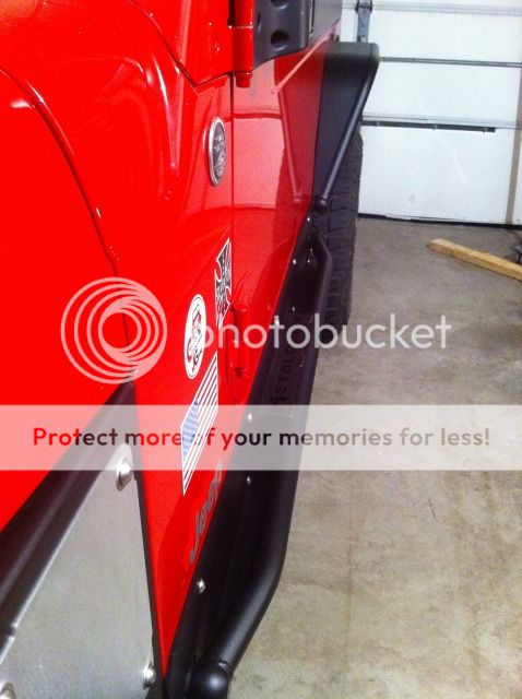

Got it on but still have to bolt everything to the fender now:

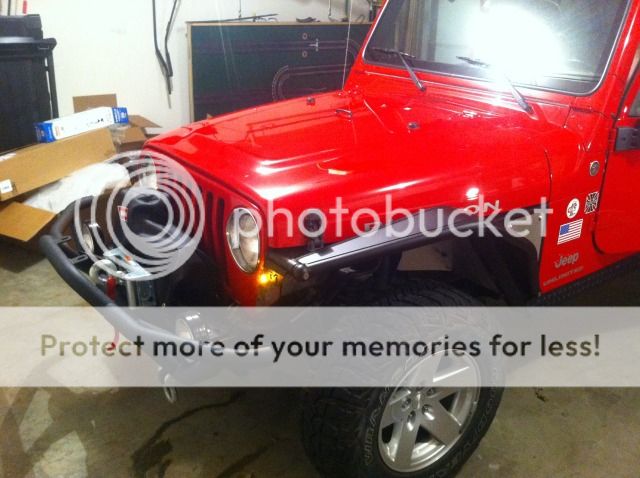

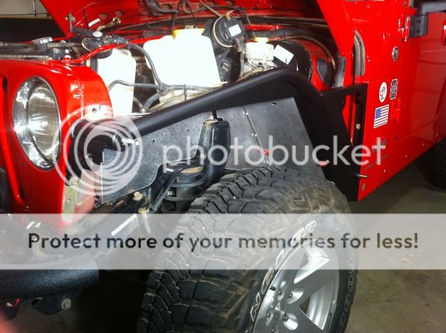

Got the front on, and the lights hooked up:
Maybe your dent will be under the rock rail, which sits high:
The LJ permits trimming both in front and behind the wheel:
Now its screamin' for new wheels and tires, which I hope to put on next month!

Thanks for the pics!
So you went with the arched front and 6" fenders(i think). Looks Great! I personally haven't decided to go with arched or overline just yet - but i definitely need the 6" fenders to avoid getting pwnd by the police up here in BC.
Do you have any lift on there? My first thought is not. But wow there is sooo much space between the wheel and the fender! What size rubbers were you thinking of going to?
The Rockers do go pretty high - they almost touch the Jeep logo and i believe that should sufficiently cover my little dent! perhaps a little spray foam insulation or something will keep the water/muck out also.
