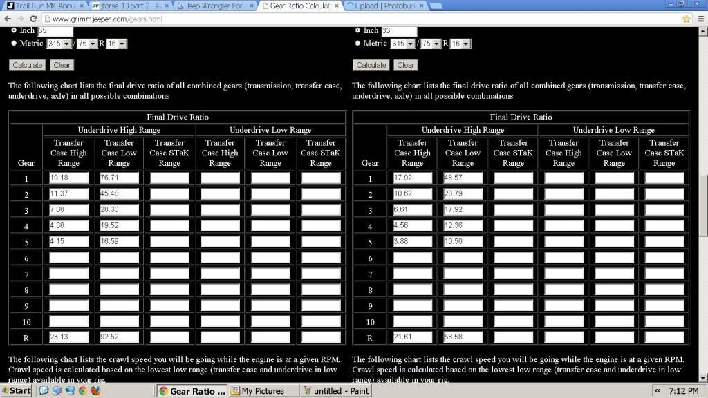

In the long run a swap to a nv3500 or a ax15 is better, stronger trans with a lower 1 st gear. Then you can run a rubicon transfer case.
AX5 isn't a very strong trans so somewhere along the line it's gonna give up, then you are stuck with either upgrading to something better with a 23 spline output so you have better transfercase choices or you blow a wad of cash on another weak transmission and hope the terra crap doesn't die after that.
Anyway I am happy with this stat on the left is with the original 5 speed, stat on the right is with the 6 speed I swapped in
This one is a comparison of a 4 banger TJ with 4.88 gears and a terralo and 35" tires on the left and the same TJ with 33" tires, 4.56 gears and a stock np 231
Jeep is looking good Nate, while tinkering a flip kit for the left knuckle isn't a terribly bad idea, gives a lil more tierod clearance and it's a cheap mod
I hear ya Art, and I know what you're saying is true.... but me being me... and realizing that my AX-5 has served me well for the last 6 years, and about 50k (95k on the jeep total), and more wheeling trips than I can remember would cause me to not have ANY problem buying another if this one decides to kick the bucket. Honestly the dang thing has never skipped a beat so I think it's going to live a long time. If I drastically change my wheeling style, or intentions then I'll definitely be looking for an upgrade. And the difference in 1st gear ratio would be nice, but not nice enough to spend all that money on a new trans. AND T-case.
