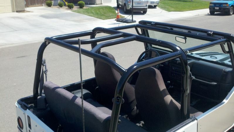

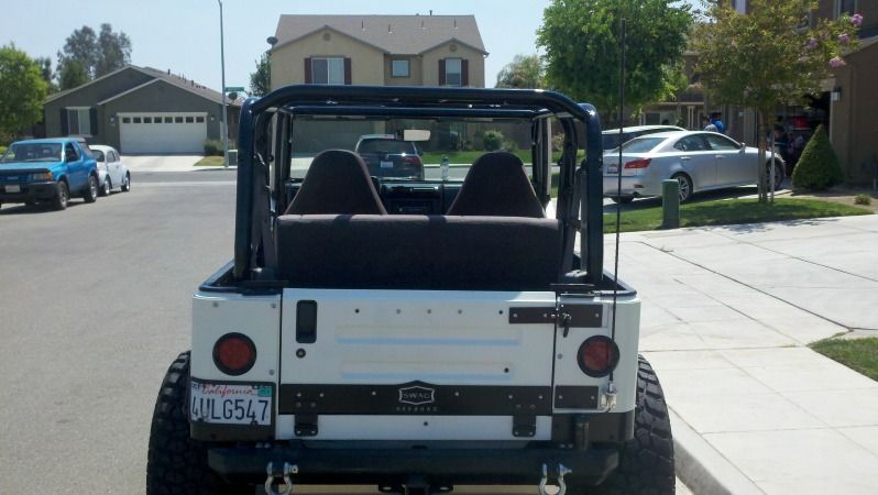

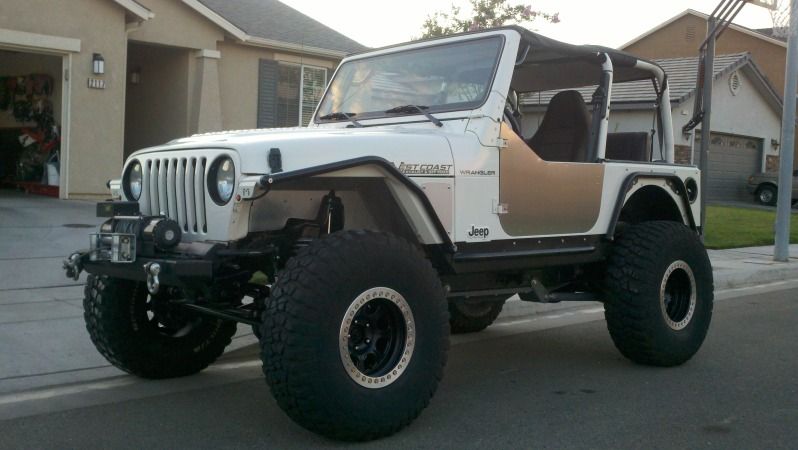

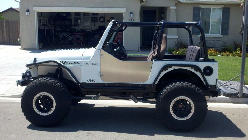

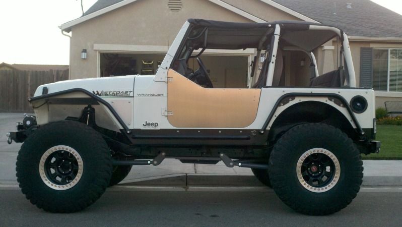

Got her all cleaned up after it cooled off today. Snapped a couple better photos. Looking forward to wheeling next weekend. While driving around today people were looking at the jeep like it was a spaceship or something. Haha it's funny, I think the doors and hood louver are what causes the odd looks. Oh well.

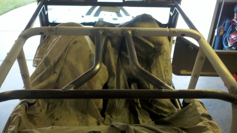

And just like the crackhead that I am..... this is next on the list. PSC rear spreader bars. This will be my first official welding project on the Jeep. Looking forward to it.

Jeep looks great ! Have fun welding the tubing in , whipping the puddle as you come down and go around the tube is tough the first time you try it .

I should probably buy some tubing and practice that motion before I jump in.... I knew it would be tricky until I was familiar.

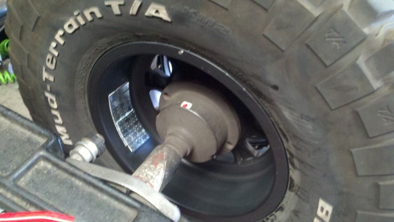

I had a chance to balance my new Raceline's today at work. I read a lot on here about how hard it is to find someone to balance big tires / beadlocks and how hard it is to find someone to do it right! Here's a few tips that may lead to more success.
First of all you want them to use Pin plates. This aligns the wheel assembly on the balancer using the bolt holes as well as a cone. Not just a cone which is what we use on 90% of everything. This will align the wheel more precisely and give a better balance. This is pretty important, especially since not many of us use hub centric rings, therefore making our wheels Lug centric, which technically they are not.
Now on wheels with less than 3.5" of backspace that you don't want or there's no place to use weights on the outside of the rim your only real option is to do a "static" balance with tape weights in the center of the rim. This should give the best results. If you tried to do a dynamic balance with so little rim width behind the hub the two readings would just simply counter balance each other and you'd have to use a TON of weight.
Mine balanced out pretty easy, one only took 1 ounce, I found that suspicious but went with it. One took 8 ounces, a little high in my book, and typically I would have spun the tire 180 and tried again but with a beadlock, I wasn't gonna loosen all those bolts. haha. The other two took around 3.5 ounces and that's what I would want the average to be on something like this. I see a lot of guys throwing 8oz. of dynabeads in there wheels...... that would have been excessive on all but one of mine. Just something to think about.
I must say that I spin a lot of aftermarket wheels and I'm usually pretty amazed by how much run out they have even brand new but these Racelines were incredibly true.
Notice the pin plate.
Eeek that's a lot! It zero'd out so I'll run with it!
gst95dsm is offline

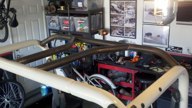

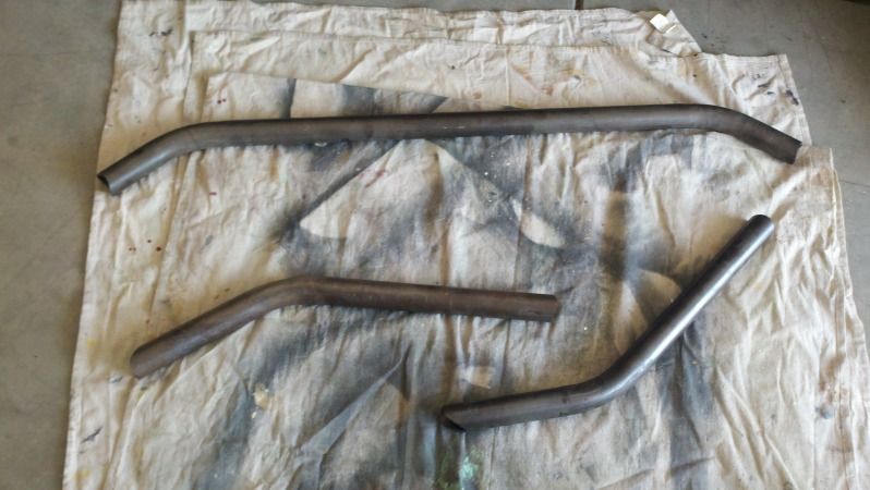

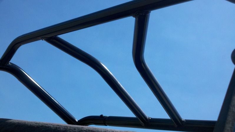

Poison Spyder Rear Cage
My rear spreader bars came in today. Nicely cut and notched, fit was literally perfect. I find that amazing and unlikely given the how much each Jeep seems to be different.

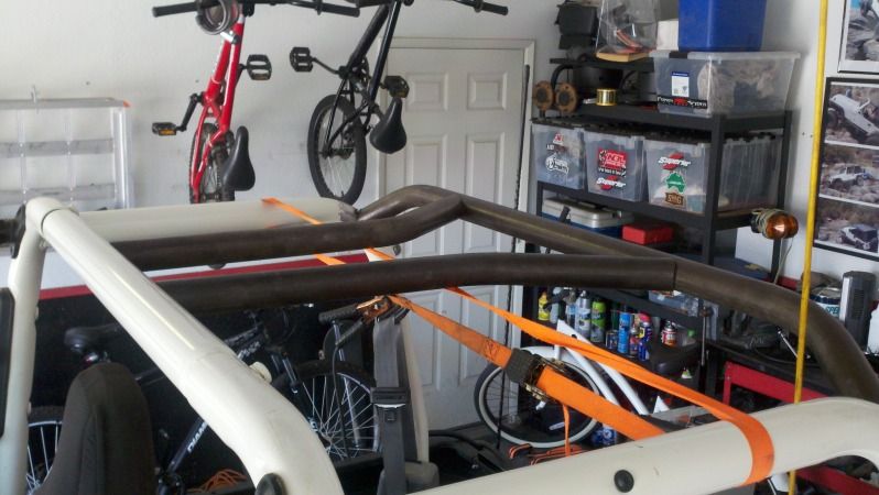

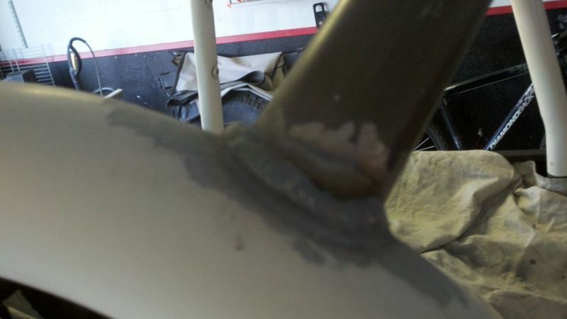

I got everything tacked up and fitted easily enough. Now if you've ever read my thread before you know I've been welding for about two weeks now and this is my first "real" welding I've done on the Jeep. I've been practicing my *** off though and felt pretty good going into this. Well I got a WAKE UP call! Overhead welding or upside down welding just was not working out for me at all. I tried slower, faster, closer, further, shorter, longer..... just nothing really worked. It was like I had never pulled a MIG trigger before! Well needless to say the welds looked like absolute crap,
I WAS able to do it though, just a lot of starting and stopping, a lot of build up, and a lot of ugliness! So out came the grinder to clean up my mess, and my hopes of having some pretty little beads to show off that I did myself were lost! The only areas I was able to actually get a nice puddle going and a nice fluid motion were on the top halfs and around the sides. I think I need to learn to just lay off the trigger when things aren't going well, I kept in it to see if some more heat would get things moving along, but it was just making a mess. The only that worked was grinding everything back smooth and just using a sort of "thin" sheet metal method, basically just starting and stopping instead of "running" a bead. Well..... Im learning! On to some photos......
My little nightmares....
Tacked up...
One of the only I didn't have to grind on at all....
Getting ready for primer....

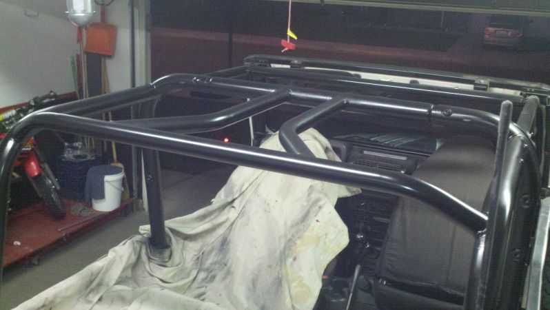

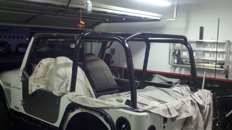

Got some paint on it tonight, Cage is finally all black, I knew it would happen sooner or later... looks pretty cool all painted, and hey my crap welds look a little better painted also....
Thanks for looking and PLEASE!!!!!!!!!!!!!!! If you have any tips for overhead welding, share them!

So after reading about overhead welding all morning, I've come to the conclusion that although it didn't seem like my wire speed was to low, it must have been... the reason I could not get a continuous bead going was that the puddle was traveling down my wire, explaining why when I was done welding there was little to no stick out, and a blob on the end. Also now in retrospect a little more angle would be better. So I think I'll practice with that later today.

Try turning up the heat too. I like to burn tube hot with the wire speed way up. Might be difficult for a beginner to run the gun that fast around tube though. Also the manual for the welder will give you a great starting point for that material thickness, some manuals will have a corresponding wire speed too.

Ok so I finished up this little project. A little more sanding and painting to get the finish looking presentable. I hate spray painting tubing because you get a good wet out and then unavoidable overspray around the tube causing shading.... Oh well I just went for shading on TOP of the tubes and a nice wet finish on the underside. Overall I'm proud of myself for getting this done. I know I'll look back in a couple years and laugh a little at how much I struggled to weld the underside of the tubing..... but hey you gotta start somewhere! It has definitely added some rigidity to my Jeep, In the past going down my driveway at an angle always resulted in a "creeek" from stuff flexing.... and now it's completely silient. That's cool! I also feel that in the event of a flop I can count on those C pillars working together to minimize damage, and increase the safety of my passengers. for this mod, at $180 it's pretty reasonable. Some finished photos, I'm digging the all black cage...
