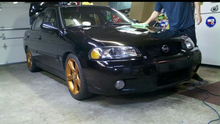

My friends Spec-V
I'll see if I can post my friends TSi thats currently getting an auto to stick swap.

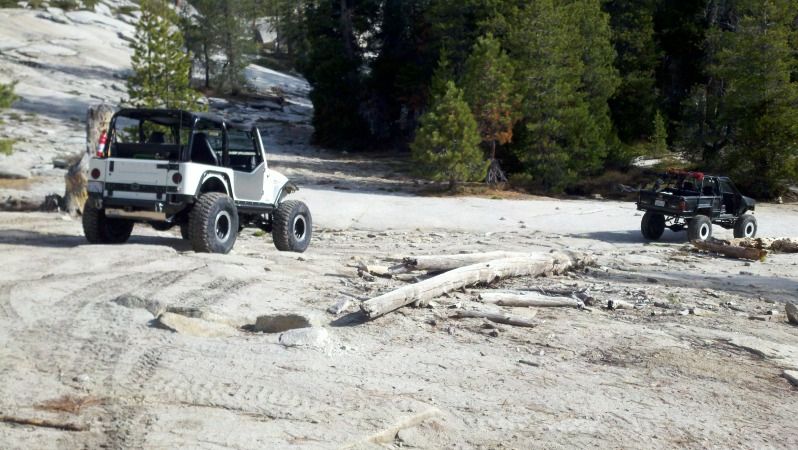

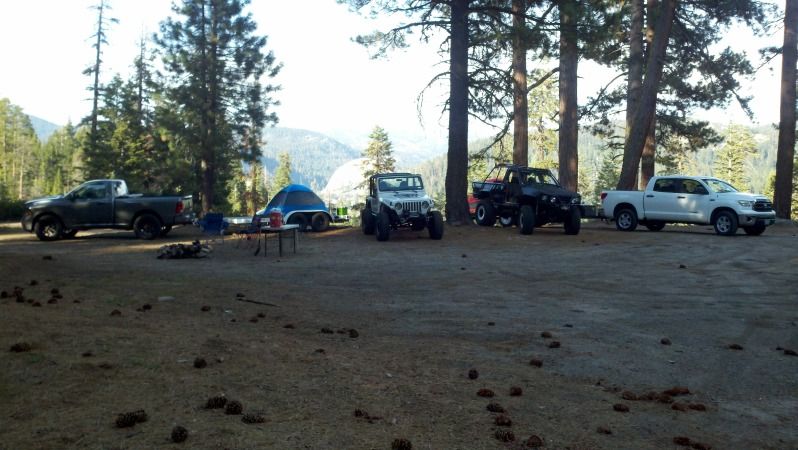

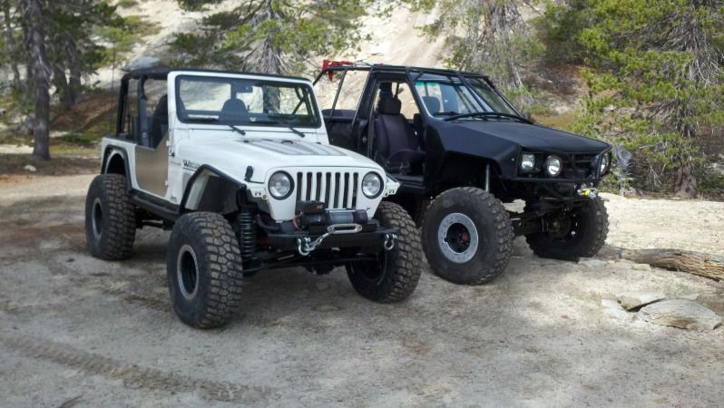

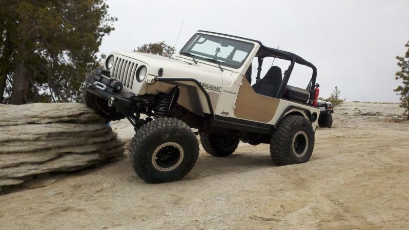

Great time wheeling Yesterday. Trailering up the hill went perfect. Took it easy on my rig, being this close to Moab I didn't want to have to fix anything or spend any money on repairs. We camped overnight on Wednesday and I froze my *** off. Good times though. Gopro vid is uploading.
