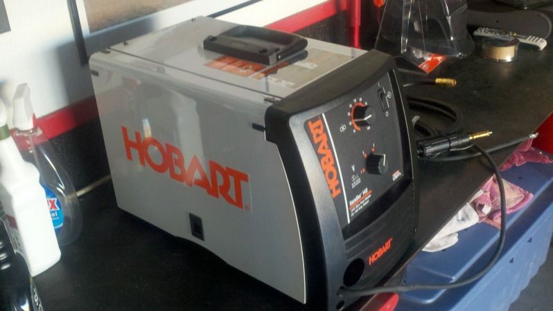

Got a new toy today. Now maybe I can stop being such a bolt on master. Picked up a Hobart Handler 140. Based on a zillion reviews I read the consensus was that this is a quality machine. Seems like it. My only experience MIG welding was a brief ownership of a harbor freight MIG-100 that absolutely sucked about 10 years ago. And before that I did some ARC and OXY/Acet. welding in High School. Other than that... I'm a total newb. Well I just got it home about an hour ago, got it assembled and set up (no gas yet) and just for kicks I made some sparks. I can tell it's going to be NICE when I get some practice. Even my total rookie nervous hands almost made something that looked like a weld bead. haha. Was actually quite the rush pulling that trigger for the first time.
Nice looking machine, sucker is heavy too.....
Practice Practice...... haha.

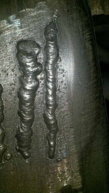

The one thing I didn't get today was some scrap to practice on. I only have this one piece of bumper I cut off a while ago. So after setting up the tank, regulator, swapping to the solid wire and just making sure everything was hooked up legit I was able to run a couple small beads. WOW at how much difference the gas makes. It's like I would NEVER not use gas unless I absolutely had to. It's so clean and so much easier to SEE the puddle and what your doing. It was very enjoyable and much calmer. If anyone has a gas capable welder but has been using flux core just because they have not wanted to bother with gas...... you're really missing out on a much more pleasant welding atmosphere IMO. I also think that welding with gas will really speed up your learning curve and make welding with flux core that much easier when you need the added strength or convenience. Just because it's much calmer, you have more visibility and there's no smoke coming up into your face.
Ok here's my set up. UHG at how much I've spent on it, but hopefully I'll have some fun with it and learn with it.
My first beads ever using gas..... keep in mind this metal is NOT clean...
Top one was u shape motions pulling (to fast I think)
Middle was weaves pulling (to fast)
Bottom was weaves pushing (slowed down cause I've never pushed before)
I know it's nothing special..... just having fun!

Beads look good! I'm thinking about upgrading from my flux core 110 Lincoln. You just made that urge a little stronger...

Thanks, I don't know what I'm doing yet but I'm happy that my practice beads actually even look like beads and not just splatter!

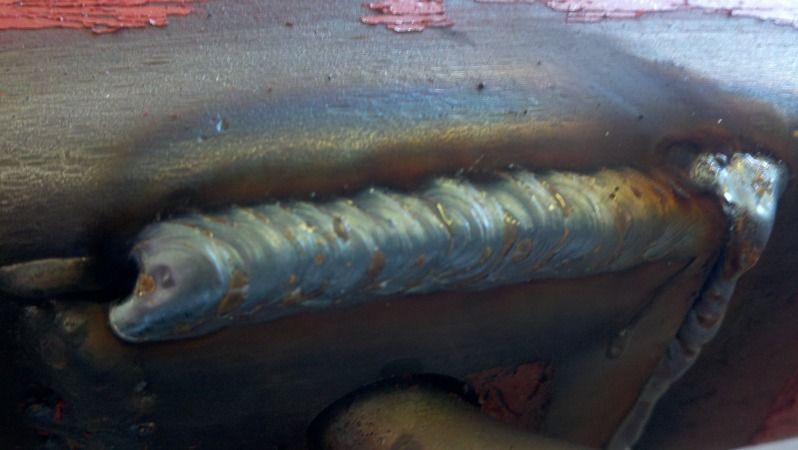

Ok well I sure did do some welding today. Bit off a little more than I should have. I started welding all the seams on my HF trailer. Cleaning the metal sucked. I ended up using Aircraft stripper with good results. My biggest issue today was there was pretty good sized gaps in some of the seams. It seemed like the arc was shooting through the gaps and I was loosing control of the bead. On some of the bigger ones I started running one bead on the edge of the metal and then another to connect the two. I had some good some bad results with that. My weld quality was decent on most of it. Pretty good on a little bit, and HORRID on a little more than was pretty good. HAHA. I got to do a bunch of different angles though and feel that I learned quite a bit.
I was proud of this little bead so I took a photo.
I also definitely learned painting stuff that's been painted or powdercoated in the past SUCKS. Even with good cleaning of the weld area, the surrounding area from the heat will blister and smoke.... FUMES.... bad... headache. I think a trailer like this is a worst case scenario being made out of C channel with a lot of nooks and crannies.... still fun though. Now i'm painting the damn thing, gotta put it all back together today and be done.

Not sure about aircraft stripper but some chemicals are bad news to weld over .
http://www.brewracingframes.com/id75.htm
Something you may want to read for future use . The bead looks good and they will get better the more you weld . When I have to weld something that has been powdercoated I use a grinding wheel , then follow up with a flapper .

Yeah I have read that in the past, and it was on my mind when I was doing this. I'm sure ANY of the fumes are bad for you. Incredibly scarey what happened to that fella. The aircraft stripper does dry pretty quickly and I thoroughly wire brushed the area. I'm sure most of the fumes were from the backside of the pieces I was welding and the paint melting off.
Thanks for saying the bead looks good, especially if you're a welder yourself.
