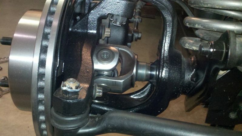

Here we have two assembled axles.... I gotta say I botched the U-joint install on the first one I did and I'm not happy! It'll be ok, It just pisses me off! I distorted the dust covers pretty bad on two ends. I was being a complete dumb dumb and while I pressed in the first cap, let the joint just sit there instead of pushing it up into the cap as far as it would go. So it put a little pressure on the dust shield and jacked it up a little. I'm not worried about it, just irritating. The second one went on like butter after I started paying attention! They are pretty though.
Just beautiful. Any hints for someone who might be doing the same this weekend?

Just go slow, think it through, use a torque wrench. You'll be ok! JF is here for any problems. If you're working with Bail Out.... he's gotcha.

Thrashed for a couple hours and the front end is together, went back together real nice. Everything torqued to spec and ready to go. I'm thinking shake down run on Saturday at my little play spot. Only thing left to do is put on the rear diff cover tomorrow. I didn't feel like playing with the Ultra Black tonight. I did notice the old axles slid right out of the unit bearings and the new ones did not slide right in, it took me tightening the hub nut down to "pull" them in, I can only imagine when it comes times to remove them the fight they'll give. I'm curious if Beasley's new Superiors are like that or not. I'm pretty satisfied with the work. I desperately needed a refresher course on solid axle front end overhaul.

You guy's will be fine, it's all fairly pleasant work, Nothing like pulling a transmission or doing a clutch, doing a head gasket, or any of that other dirty work... this is all just right there in front of you, easy to reach, lightweight....it all makes sense. Just gotta have some patience and the tools.
