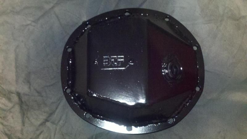

Posts: 4,368
Finished up this little gem today before work.... came out pretty nice I think. Some good welding practice for sure. I've got this, and my ball joints to press in tomorrow, and the final axle decision. Also going to order the unit bearing from Rock auto. No way am I going to slap new axles into old unit bearings.
