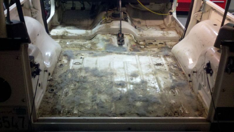

Opened up a big can of worms tonight.

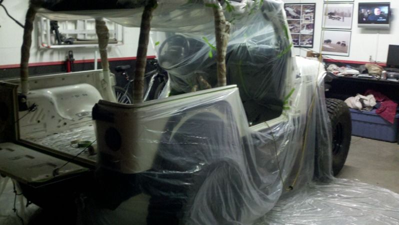

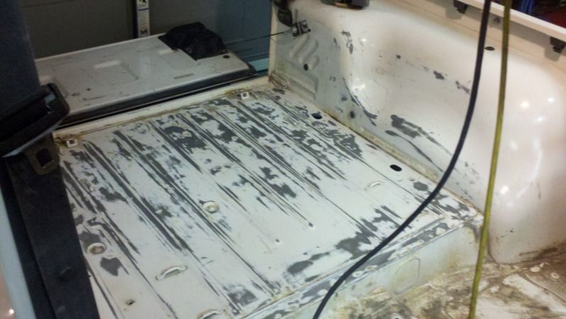

I've wanted to line the inside of my tub since I bought the jeep but never have because the previous owner actually redid the rear carpet and sprayed ADHESIVE!! down to keep it in place....... I've just left it for years but finally have had enough and just want it nice and clean inside there. So anyways prep began tonight. I got my son in on it too..... lots of tedious sanding ahead of us. I've decided the Raptor liner is gonna work good, and plan to be spraying next Saturday, so i've got a week to get it ready..... we made good progress tonight i thought!

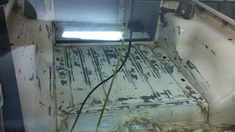

Well my prep is about 90% complete. Mostly done sanding, just have to clean it, and sand it a bit here and there. Feels good to be this far, getting through all that glue and fuzz was no fun.

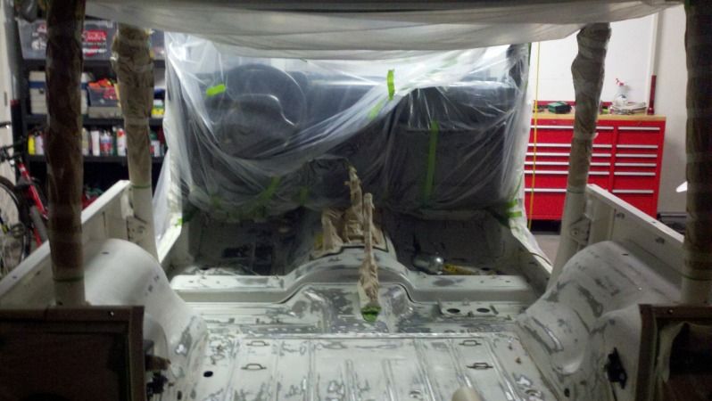

Getting close to being ready to spray on Saturday. Underestimated how long it takes to mask.... uhg. Hard to know if rolling it would be faster or spraying in the long run. I think i'll like the results from spraying better though. Overall this is a much bigger project than it seems imo.... having fun in the garage though....

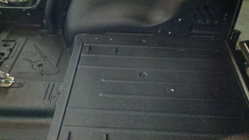

Ended up spraying today. Overall pretty happy with it. Was kind of looking for a fifth bottle though. It surprised me how quickly I went through them. There's already more than a couple spots I can see now caused by gun angle and spray direction, and not hitting it the other direction. One small can of this liner in aerosol form would really be handy to take care of minor mistakes. I ran out of light today so we will see tomorrow if anything really bothers me. I know once I get all the interior in and stop staring at it so hard it'll all be fine. I'm just a little over critical of my work usually. Handling this stuff is easy, but my recommendation is to purchase one extra bottle.

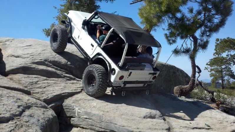

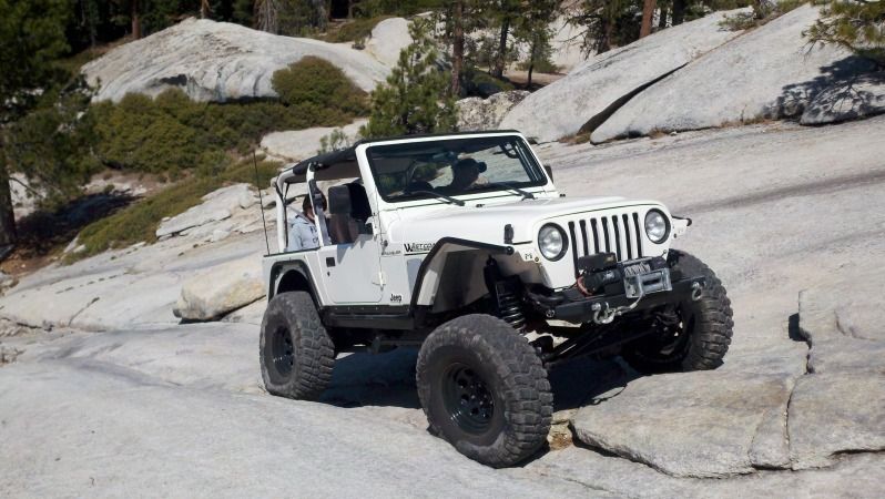

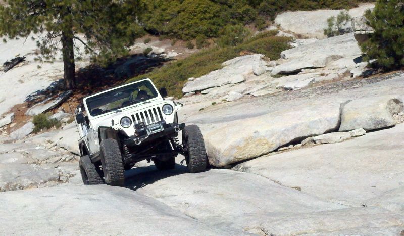

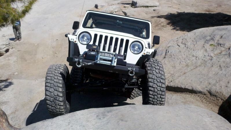

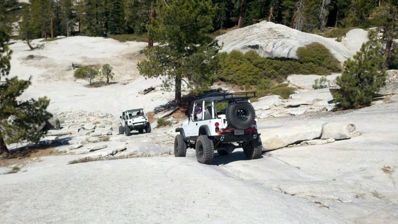

Went wheeling on Memorial Day! Really happy with how everything is performing. The new Teraflex shocks in the front seem to work real good and the additional droop gave a more planted feeling in situations where the jeep was really flexed out. Also the RC Long Arms are working just fine for me. All of the steep climbs I like to do, all of the ledges, just everything I throw at it, it feels solid. No drama, bad behavior, noise or weirdness. Here's some pics, it was a great day~!

Wheeling looks great. The overlines that you have, are those able to have the 2" or 4" extensions bolted to them?

These are actually the arched version. And yes you can bolt on 4 or 6 inch flare extensions. I think just the rub rail looks bad *** though.
