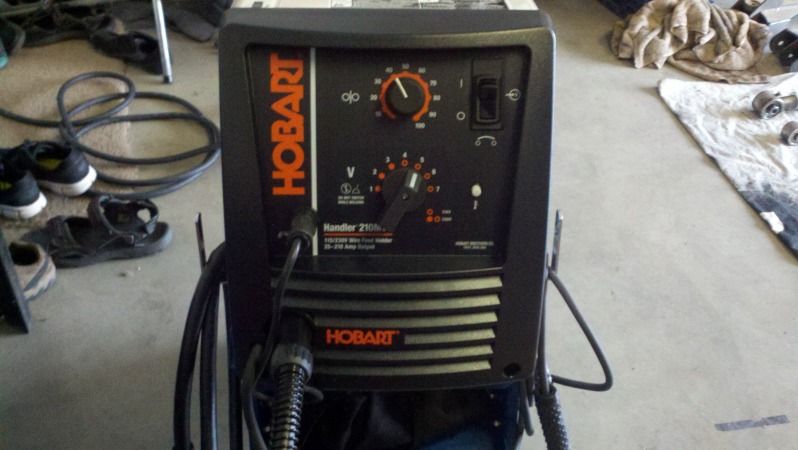

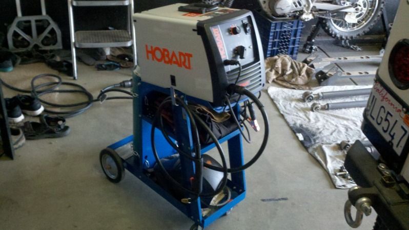

Back in action!!! Ok this little thing is a tank compared to the 140, it's got to be at least 30lbs. heavier. I just did some practicing with it.... and YEAH! it's got a TON more power.... Holy crap. I had to keep that gun moving!
Very nice
Wheres the weld pics ?

No weld pics yet, I'm to busy making a mess of things. Need some advise Beasley.... the settings suggested on the panel seem a little aggressive, Have you found that to be the case? Also when welding WAY out of position, what kind of motion do you prefer with the gun?
I always run my heat and wire speed higher than recommended. For the welding advice, a back and forth motion works well for welding in awkward positions.

On my Miller 210 I run the following as a generic starting point depending on thickness 2/25 ,3/35,4/45 and then I adjust as needed . I have found that the 3/35 works great for 3/16" to 1/4" material . For overhead I add little more voltage than I would normally use and a little more wire then move a little quicker than I would normally run a pattern . One thing I do a lot when I weld is reposition my project as I move to avoid welding overhead if possible . I can do it , but I dont like it . The pattern that works best for me on hard to reach areas is the push j . Most of my welds are lowercase e's if I can get braced up and have room to move .
When I get a new welder I weld on some scrap to feel it out and learn its settings . Hopefully my generic #s will get you started up and close to dialing in .

Thanks, it just seemed like I would have to move so fast at the recommended setting or make holes! If I turn up the wire speed I can get some nice smooth sizzle, but good lord it's HOT, and I'm moving FAST. I guess that's ok though.... I just find it hard to go fast, and use a steady motion with my head crammed up under the jeep and both arms reaching up or to the side, haha.
Well this little guy goes 1-7 Beasley on the power..... it's saying 6 for 1/4". 5/60 seemed to work good, and 6/70 seemed to work good at a very crazy pace. (from what I'm used to). Haha...... can't handle the powa! Now don't get me wrong, I can post up some pretty perfect looking beads on some scrap sitting in front of me, but the couple spots I tried on the shock tower were pretty out of control in comparison.... maybe my entire issue is that I need to spend more time getting into a position that I can actually get a steady motion...... perhaps a little impatience is a problem.

When i started welding i always went to fast, so id always turn the wfs or amps up. It always turned out allot beeter when i could go faster and keep moving. Also anything over head your going to need more amps/ faster wfs. Welding pipe i always tack in four spots and weld one bead from tack to tack and stop then weld to the next, much easier then trying to get all the way or have way around
Haha fast and hot is good. With that upgraded welder you will quickly learn to move your hand faster and your welds will continue to look better. It will become second nature. Happy burning !
