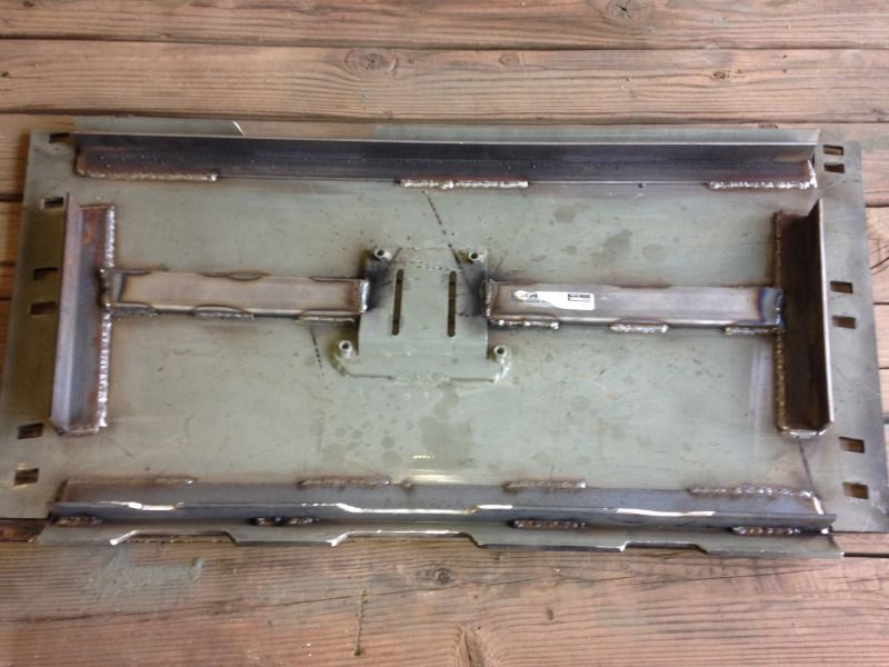

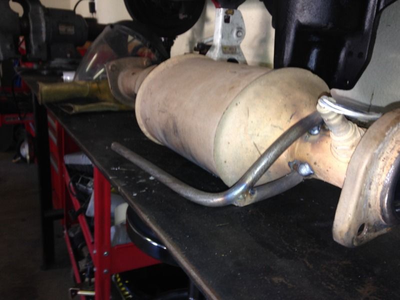

Guess I should post this in my own thread also. Today I added bracing to my Barnes flat skid plate. After much discussion in Danno's thread I decided to tackle the project. I'm happy with the results and I know that I've definitely improved it's strength. Time will tell if it holds up to my abuse. I think it's going to be fine though. Hopefully this will help anyone looking at the Barnes flat skid... or any flat skid for that matter. Keep in mind this is an AX-5 transmission so those of you with other transmissions will face other (similar) challenges.
Reversed cat hanger...
Bracing mocked up...
Test fitted and welded...
I'll post some more after it's re-installed.

Nice work Nate, the angle iron on the long sides will be especially helpful!

I need to pull my skid down, but I believe I used a few pieces of 1x1 square tube. 3/16 thick. Anywhere I did heavy bracing it held up. On small spot I left out took a nice hit.
You shouldn't have any real issues. Good work

Thanks guys, it's definitely a much different skid than it started out as today. I may have to trim the lip of the angle in the front a bit more if it rattles. I've got clearance but we'll see how much the exhaust and tranny move around during operation. Over all I'm pleased with my work today, now I got to do some painting and clean up of my undercarriage from these last 4 wheeling trips!
