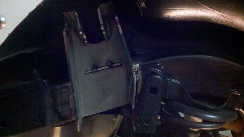

The track bar bracket never even entered my mind until today, I had read you need to "notch" the tower... but it's very hard to measure the tower to mark the notch.... that doesn't fit where you need to measure it from.... so again.... cut small... and bring it out to the final dimension. Time consuming and dirty, I'm still not really done with this step, I'm damn close though. We should BOTH be doing this at the same time by the way!
The notch looks perfect , should make for some interesting angles to get to when you are welding it up ! And I wish I was working on this same project , but on a whole I try to finish one project before I start another and my trailer is eating up all my time .

is your axle set at ride height? The mistake I made was having my axle sit lower when placing my towers thinking I would have 6" of uptravel but once the tires went on and the weight of the vehicle I was really looking at about 4.5-5" of uptravel.
Overall your looking good my only concern is the shock body contacting that trac bar bracket. Do you have enough clearance?
I've left the springs in and leveled the axle the absolute best I could at as close to it's actual height with the wheels on as I could. The Jeep is sitting almost just as it does with all 4 wheels on so I figure not much should change when I actually do put the rear wheels on. Let's hope!
As far as the track bar bracket is concerned, I'm planning to trim quite a bit more off what you see in the photo. Worst case scenario I'll actually trim part of the track bar bracket itself but I'm not anticipating having to do that. My rear links are pretty flat so I think my towers have ended up a little more vertical than most, causing me to be a little closer to the track bar than I've seen on other outboard jobs.
Thanks for looking though, I need the advise!

Had just a little time tonight to work. I did some more fitting on the passenger side and have it about as good as it's going to get. Fit up is pretty tight, not nearly as clean as the driver side but still not bad. I will have some "filling" to do with my welds by the track bar mount and unfortunately in my center notch but not much at all considering. I plan to drop the tank to weld the backside lower portion. I just think it will make it a lot easier and dropping the tank is easy enough. Overall I'm feeling pretty good about it. My next chore is to thoroughly clean up the frame around all my weld joints. I could tell just by some little tacking I did that if I don't spend some time cleaning it up better my welding is going to suck.
