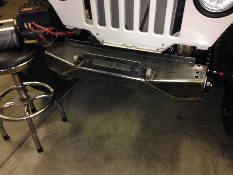

Drew up a fairlead mount for my new Barnes bumper and cut it out today. Should work out good. Just waiting on the UPS guy... dude is running late today.

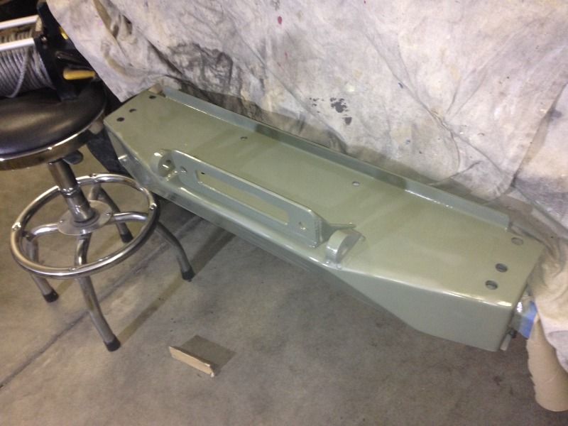

This new bumper is pretty sick IMO. A lot more detailed in it's design than I thought it was. My fairlead worked out perfect and looks pretty at home I think. I'm going to work late tonight and try to wake up to a nicely painted (dry) bumper to stick my winch on and call it done.

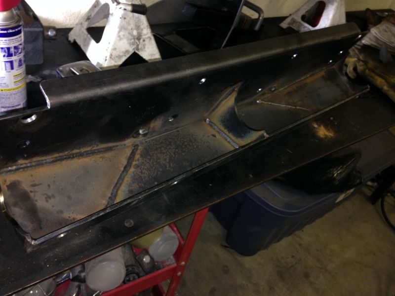

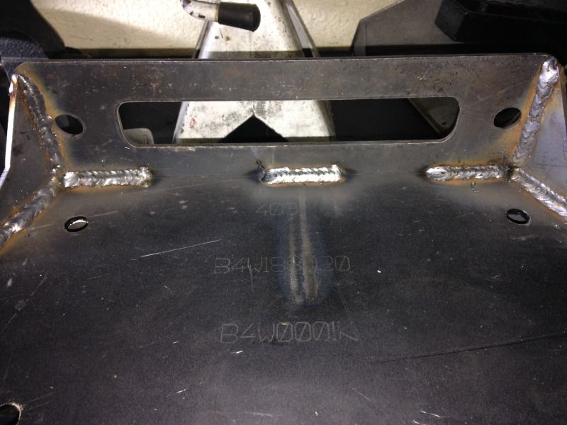

The interior of the bumper is a lot more elaborate that I thought... it's got a nice gusset in the center.
Overall pretty pleased, especially for the reasonable price.

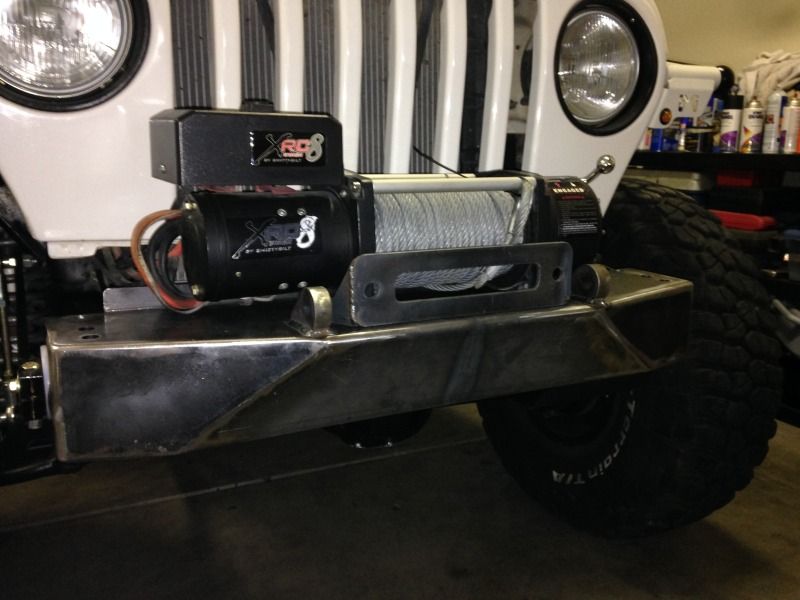

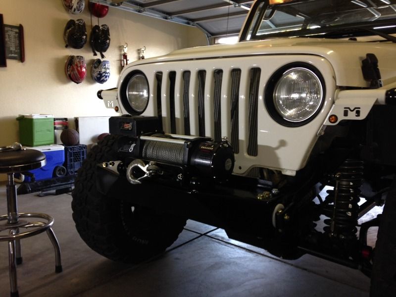

Well here is the sexiness.... I know it just looks like a black blob in the photos, but trust me it's a pretty sleek looking front end now. I've gained about 2" of approach angle and even more if you count not having my shackle mounts sticking way out that I would regularly hit on stuff. One negative I found is that the shackle mounts are for 3/4" pin, shackles, that seems odd to me.
Ah crap... you can't even see it. Later on I'll get it into the sunlight and take a better pic.
I thought the same exact thing, pictures do it no justice. Oh, and he is selling the **** out of these already, don't worry. They were backordered for weeks when I ordered mine.
