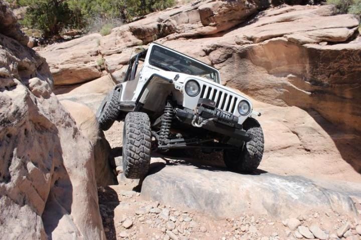

I just noticed this pic in my photobucket.... didn't even remember taking it. I thought it was a pretty cool shot!

I am liking this one

Thanks for that tip Art! I honestly didn't know that. And that's one of my favorites also!
Where is this?

Where is this?
Place called Jose basin, near auberry ca.

Only a day and 8 hour drive for me. That's doable
