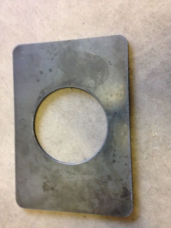

Cut out a piece of plate for Mike MO2500 today for his spare tire mount. I'm REALLY happy with the cut, compared to what I was getting before. I got virtually zero dross and what I did have chipped off completely and easily. Tweaking the cut height and pierce height just fractions of an inch is what has made the improvement. I did struggle to array a bolt pattern on the piece so we decided to just leave it blank and he could drill the holes. It get's a little tricky spacing things out exactly and maintaining the proper hole size. I just gotta play with that more to get better at it.
