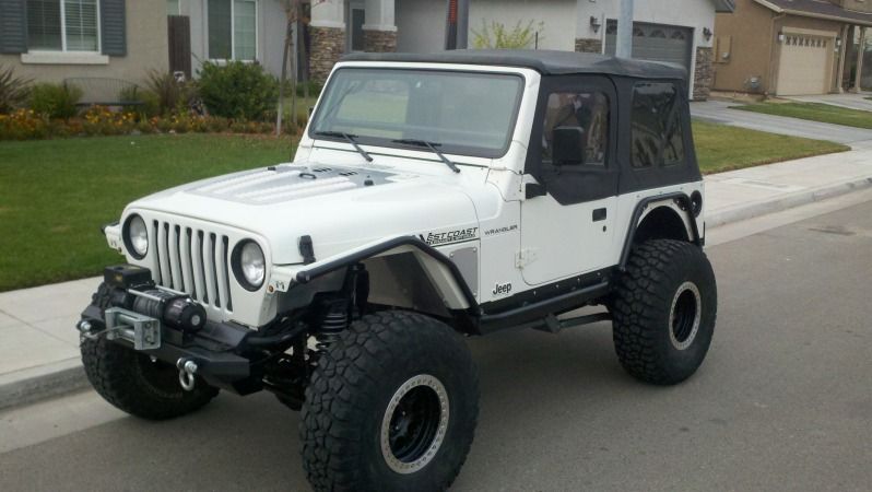

Finally have to admit winter is here. Winter mode activated. This may be this tops last season...... that rear window was a pain to zip!
Ok so here's the plan. Order two 1" JJ's, two 1" tube adapters and four 1.25" tube adapters. Snow wheeling this Saturday!!! Tear down next Tuesday when my brackets arrive, and reassembly throughout the week / weeks..... depending on how everything goes. Goal to be ready for our annual Snow wheeling trip on New years day.
