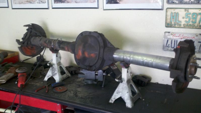

From eyesore, to garage decor.
I'm glad that portion of this axle build is done. Tomorrow I will disassemble it further, replace the e-brake shoes and possibly weld the tubes.

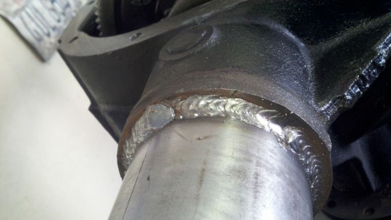

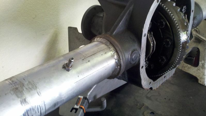

Welded the tubes....reading online will get you about a 100 different ways to do it, no one can agree. Many just go at it with a 220 mig and never have an issue. That's what I got... so that's what I did! I just did 1.5" sections, going from side to side and rotating the axle around. Now to disassemble further.
