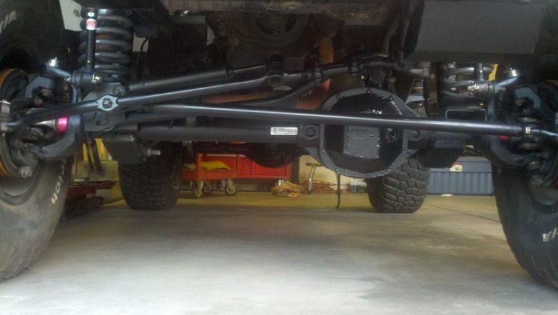

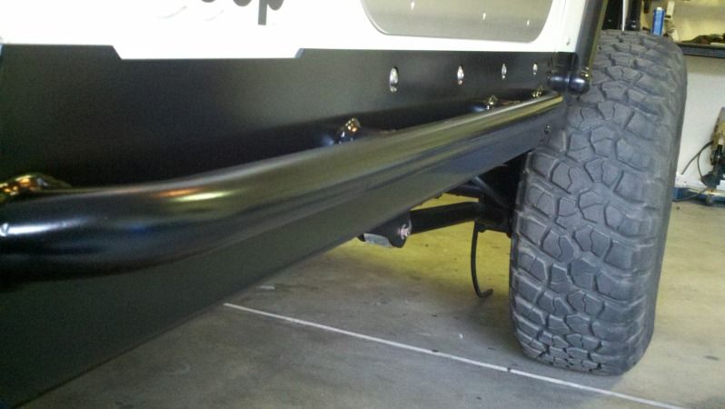

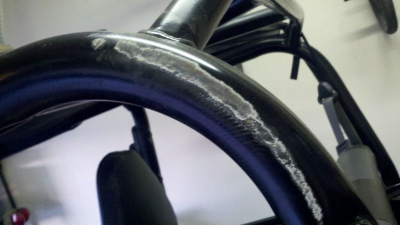

Got the front end up cleaned up again. It's not surgical like when I did the ball joints... but it's pretty clean again!
Got one rock slider done, took care of some Helldorado and Chocolate Thunder scratches,
And now I have to focus on the cage.... it took a little beating on Helldorado, I dread painting it because I know it's going to turn into a complete re-paint and not just a touch up. I hate painting tubing! Maybe I'll leave it for a conversation piece.

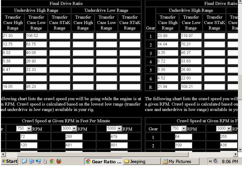

In the long run a swap to a nv3500 or a ax15 is better, stronger trans with a lower 1 st gear. Then you can run a rubicon transfer case.
AX5 isn't a very strong trans so somewhere along the line it's gonna give up, then you are stuck with either upgrading to something better with a 23 spline output so you have better transfercase choices or you blow a wad of cash on another weak transmission and hope the terra crap doesn't die after that.
Anyway I am happy with this stat on the left is with the original 5 speed, stat on the right is with the 6 speed I swapped in
This one is a comparison of a 4 banger TJ with 4.88 gears and a terralo and 35" tires on the left and the same TJ with 33" tires, 4.56 gears and a stock np 231
