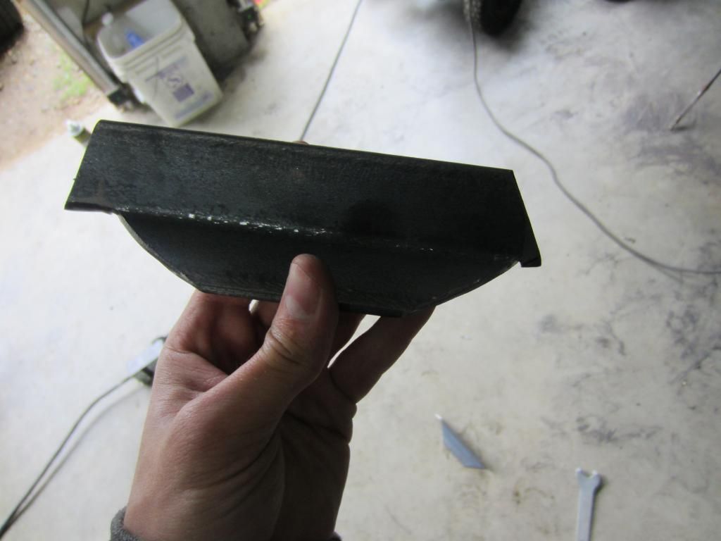

When I straightened my coil buckets it got beat up pretty good bashing with a hammer to break the inside welds but I did the following:
Ground it completely off
tacked in place
grabbed and cut some angle iron
finished
Doing it the way I did made the ride perfectly level because if you think about it by straightening the bucket your adding about an inch of lift but by removing the bracket and welding it straight to the frame your removing about an inch of material therefore keeping it level.

Enjoyed the read.. great build
That came out really good man. Definitely a route I am willing to take. It would be NICE to find some inexpensive coil bucket "blanks" that I could just make the brackets for and avoid having to grind the bracket completely off the stock one. Thanks for posting your photos though.... very helpful.
It wasn't difficult or very time consuming. Cutting wheel and a grinder had it cleaned up in less then 10min once I had it off the frame and in the vice.
