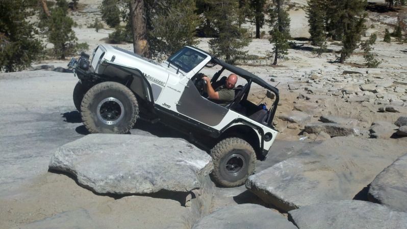

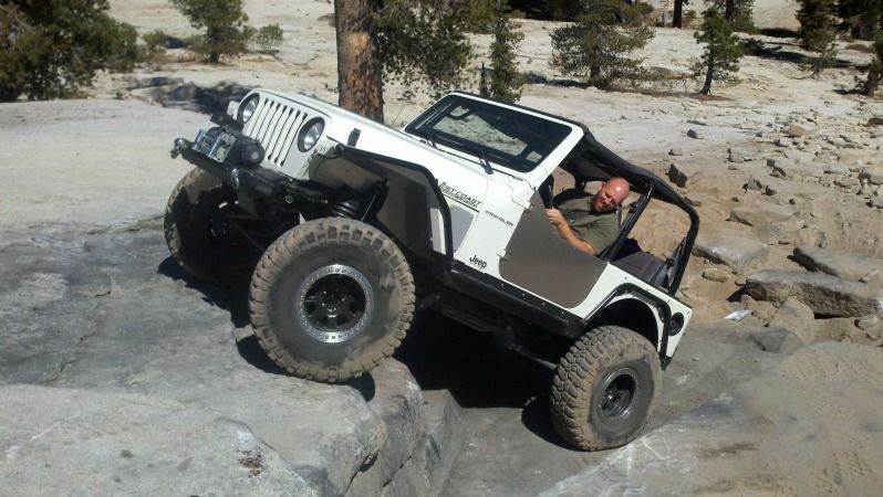

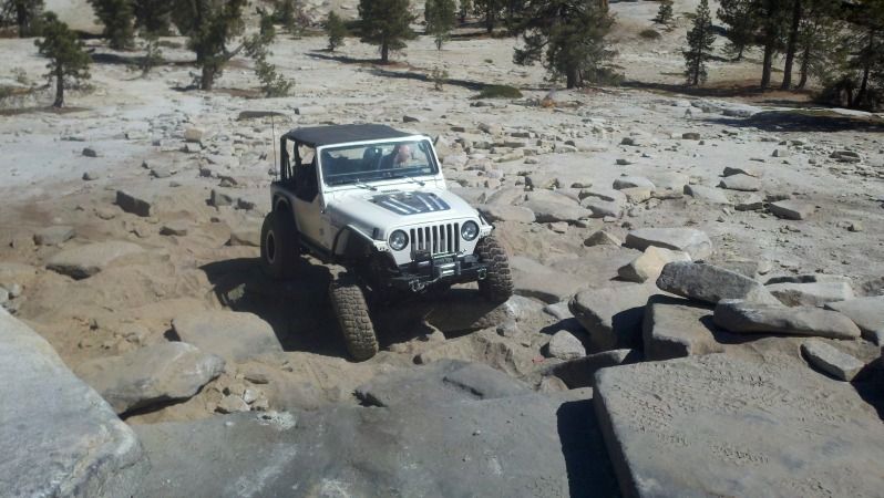

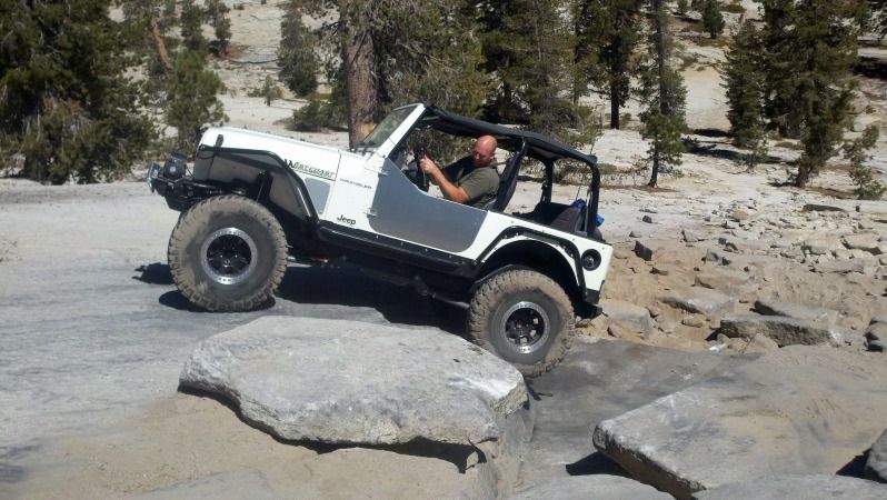

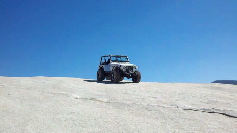

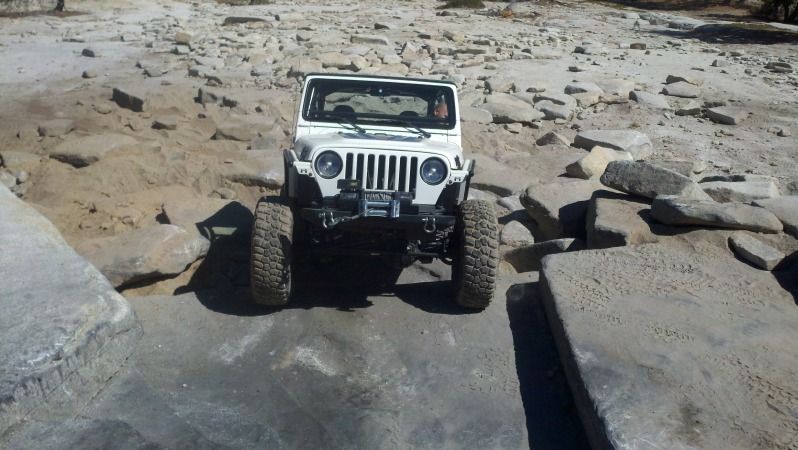

It's Swamp Lake Trail, this is the second time I've run it this year. It's about 13miles of rocks, rocks, then more rocks. Takes anywhere from 7 to 10 hours to complete depending on how many rigs you have, and how much you stop to BS. A good one to camp on and split into two days. Yesterday was an endurance test...... I took some hard lines and felt that I drove well so I was happy. I took the wife and kid, they were troopers... it was a long dirty dusty day.
Took me hours to clean the jeep up today, touch up all the paint underneath and dust out, vacuum the interior. I'm a sick man.

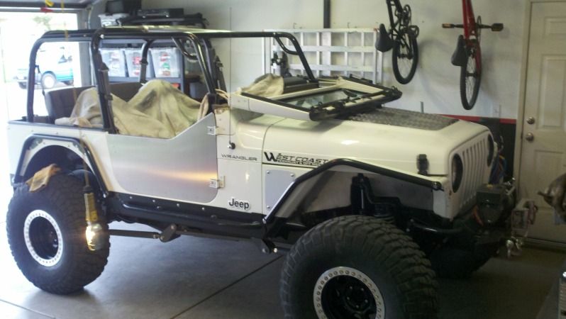

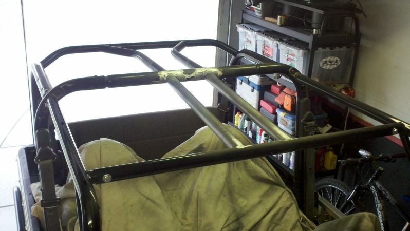

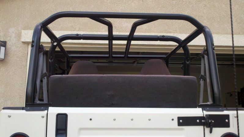

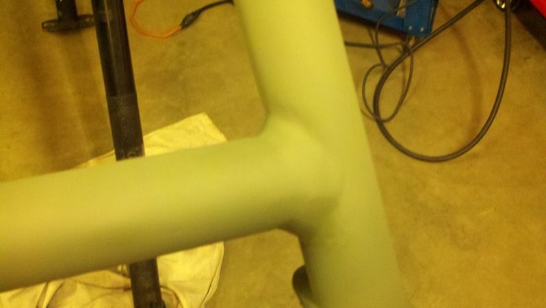

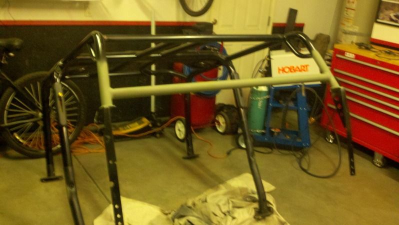

Wrapped up the cage work this evening. A little more grinding, some sanding, some priming, then a little paint and it's all back together. I'm pretty happy with it.
First time I've even folded the windshield down, I was pretty excited.
Ready for some paint...
All painted up, pretty half *** job really on the paint. It's just black though....
Put the soundbar, and bikini top back on.......and washed the whole Jeep..AGAIN... just did it yesterday but it got all dusty from the sanding... oh yeah... here's a tip. Cover your windshield and rear view mirror when you weld near it or it'll get welding slag ALL over it. The mirror is ruined, the windshield responded well to a razor blade...

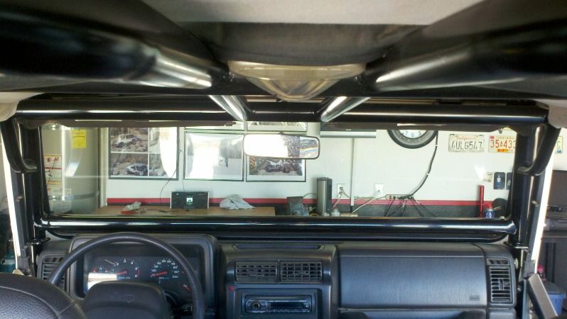

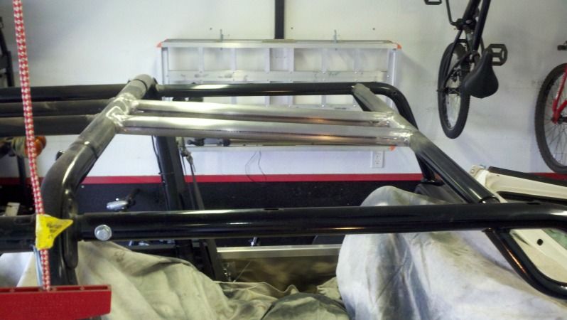

Had a stupid idea today to actually remove my cb rack (cage) to fab up a lower windshield spreader bar. It's a stupid idea because the factory torx bolts are stupidly hard to remove for the first time since the jeep was born. Only 1 really gave me a fight though and I had to drill it out some, then pound an Allen socket in it and it finally gave up. I was WAY off my game today so the fit up of the spreader bar SUCKED bad. I did not account enough for my notch or that the notch was tapered as the A pillar bars angle inward. So I had to fill some gaps while welding. The welding went GREAT compared to welding tube inside the jeep. Being able to flip the work over was awesome! I don't think I'll ever weld inside my jeep again other than tacking unless there is NO other option. I tihnk this will be the final addition to the stock cage. All that's left is some more painting tomorrow and a trip to ace to get some new bolts for the cage. 12 more torx bolts off my Jeep YAY!
I think it's looks neat like this!
I was light on the pics cause things were not really going my way and I was frustrated....

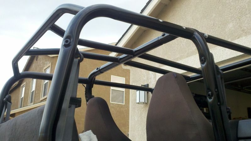

Well my windshield spreader bar turned into a real nightmare! Upon re fitting I realized that although I welded my bar in level, the A pillar bars were off 1/2 an inch and square up when you actually put the bolts in to tighten them down to the firewall. This meant I had to cut the bar out again, clean it up and reweld it!!!!!!!!! Holy crap talk about frustration. Then after all that drama the paint started acting up! Spider web cracking in several areas! So I had to spend a bunch of time sanding and painting. It was pretty terrible! Well I finally got to an F-it point with it and said good enough! I got the cage back installed and am calling the project DONE! The kicker is that I don't even like the bar there. I think I should have used 1.5 tubing instead of 1.75 and maybe even cut the plastic in the gauge cluster cover to recess the bar down lower. UHG.... my son got in the jeep (he's 12) and said all he can see is bar now..... good one dad. HAHA! We'll see if I just get used to it. I hear you do.....

Thanks man! Right now I HATE the damn thing....
Sucks doesnt it ? All that work and to not be happy with it . Sounds like we are a lot alike and we are our own worst critics . I am on the hunt for a stock LJ rear section to begin anew on , the next one will be perfect
Fwiw the cage looks good , and I had the same cracking issues wherever I welded a joint together .

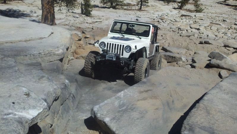

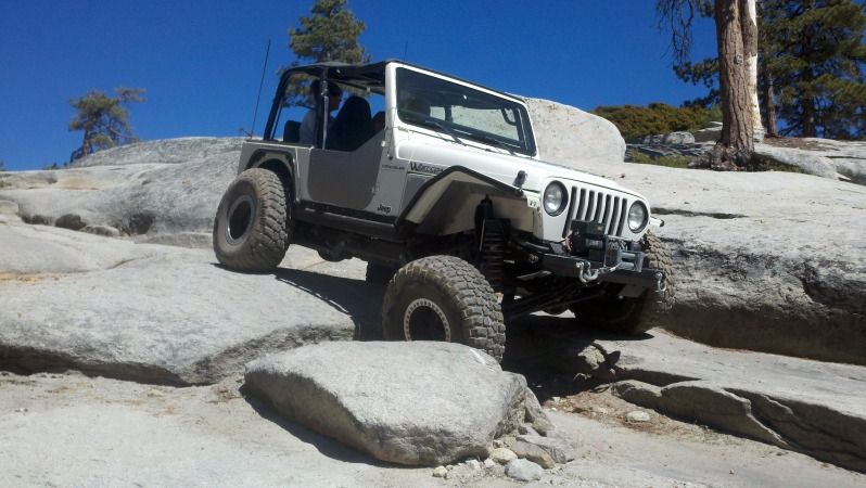

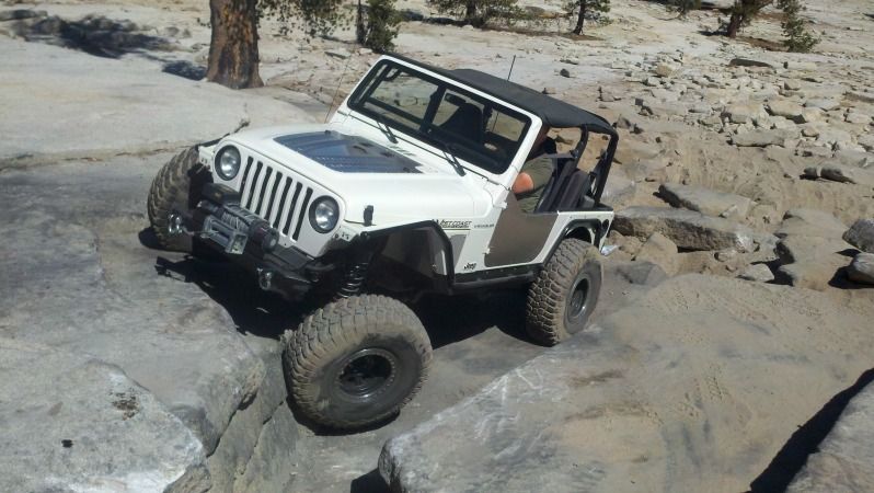

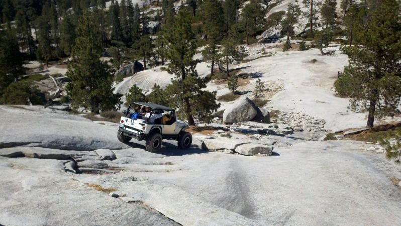

Went wheeling yesterday! Good times on Bald Mountain. Hit all the usual obstacles, V-rock, Hollywood, Posi, Bumper Buster. Had a good time as usual. Nice short day but relaxing. Here's a few pics I thought came out alright.
Posi Hill Sequence... this is a fun spot, you can tell by how the dirt looks and the black on the rocks this is a popular play area. It was very tore up!
The Jeep performed awesome for me. Can't really say I NEED to change anything right now. There's a few "wants" but definately no needs. As this wheeling season winds down I'm going to start putting together my winter plan for some minor tweaks.... rear shock outboard, coil bucket relocate, and maybe new frame side control arm brackets from UCF.
