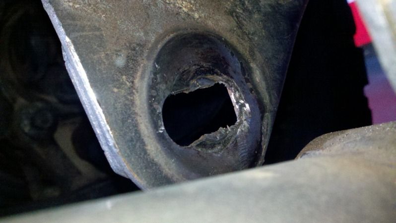

Good call on the oil pan skid.
This is what happened to mine a few trips back, freaked me out. Look like it took sone swings from a sledge.
The skid I purchased still needs to be installed. Haha
Wow that's pretty bad man! It looks like you spun around ON the oil pan... I'm actually very surprised mine has only suffered some scratching and two small shallow dents in all the wheeling I've done. I'm always concerned about it though so I'm glad I've addressed it.

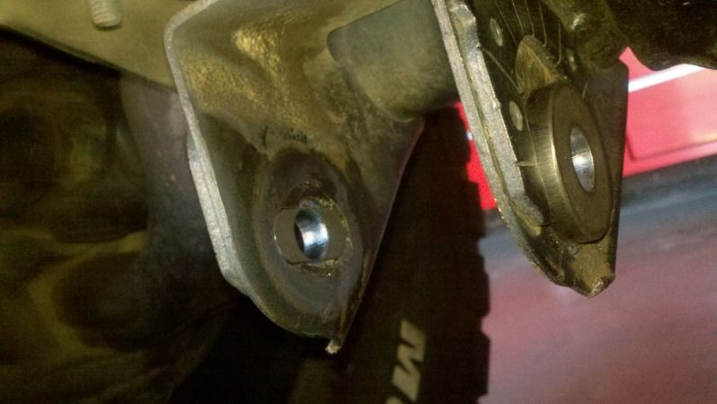

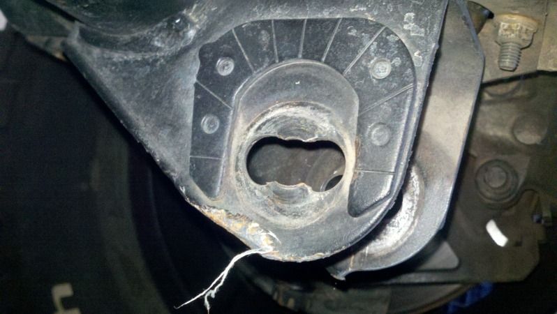

Black Magic Johnny Joint Washers
I wasn't even going to document this little project but I was pretty shocked by how badly I had deformed the holes in the lower control arm mounts in my Dana 30. I figured that there's probably a lot of us that haven't really paid much attention to this so a few pictures were in order.... These little buggers can be ordered here http://shop.blackmagicbrakes.com/Joh...ashers_c80.htm. Well worth the $25.
Here are the little buggers...
Now this is where they want to live.... Obviously they aren't going to fit in there. Some filing was in order, quite a bit. It went quickly though and they fit like a glove after a little time.
The drivers side one on the inside was the worst by far but I hadn't decided to take pictures yet... this is pretty bad though.
Now after they are in you want to make sure your mounts aren't so worn that they protrude on the inside.... if they do you'll have to file down the new washer itself. Mine did not protrude to my surprise.
I could tell just by how the bolts felt while tightening them that I was getting a much more secure fastening between joint and mount. The final torque was crisp, I remember in the past feeling like I was compressing the mount.
Thanks Blaine for making these. MUCH needed, I think everyone who has this axle should get these ASAP!

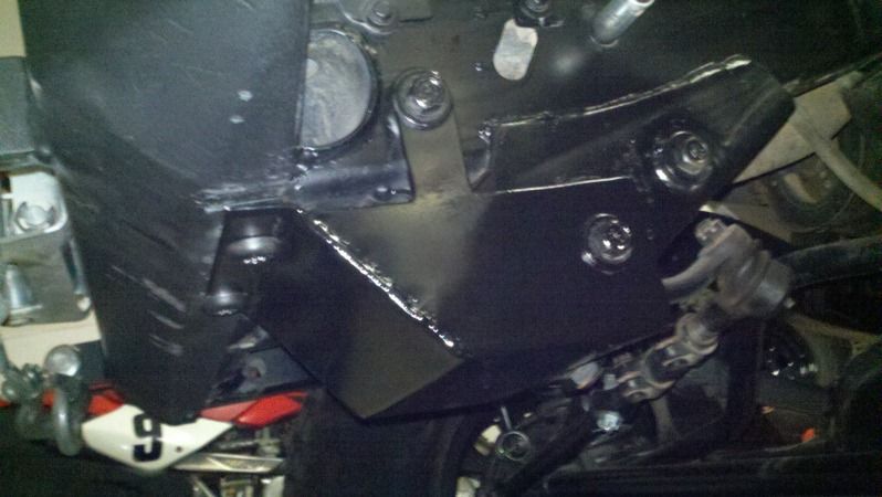

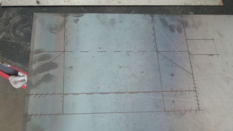

Homemade Steering Box Skidplate
Had some free time today and decided to try and hone my metal fab skills a little more by doing another Skid project. I know everyone and their mother makes a steering box skid and I know they are cheap. It's just something that I've never got around to buying so I decided to make one. My design is just like every other one out there. It turned out to be a finicky little sucker to make though without any real bending tools. I'm pretty happy with the results. On to some photos.
Forgot the photos of the cardboard mock up...
Here are my measurements and template transferred onto my metal (3/16ths).
Tada.... becoming a master of the suicide wheel. Not exactly laser quality haha.
This is the hard part of making stuff like this.... scored and bent in a vise
OK...now even I was wondering if I did this.
This is after lots of fitting, grinding, cutting, drilling and what not..... I kept the pictures light. You all know what these look like haha.
Here it is installed, It ended up working out good! It was dark and all my installed photos came out terrible....
Another good day in the garage though making noise and sparks. Couldn't ask for more.

Your welds on the steering skid look much better . Are you having trouble going straight ? What kind of helmet are you running ? The reason I ask is when I was running a cheaper helmet I had the same issues . Once I upgraded to a Hobart instant on with the larger viewing area , most of my tracking issues went away because I could see so much better . I got rid of the rest of the tracking issues by using a rest to weld from , I always try to steady my arm on something before I start running the bead .

Originally Posted by thirdeye View Post
Nice! That is sweet steering skid!
Hey are those Lca mount washer things weld on or just a washer?
Thanks! And yeah just a washer, no need to weld them on although I guess you could.
I have noticed some tracking issues, and yes without a rest it's about 200x worse! I was especially proud of the bead I posted a photo of because that was done with no rest. I can see how the bigger view on the better helmets would help a lot also. I will probably upgrade soon. Right now I have the least expensive Hobart helmet and while I think it works good for what it is, it's very basic. I have discovered one thing that's really helping me though. It's looking AHEAD, just glancing ahead of the puddle and down the workpiece to see where I'm at. At first I was just so focused on the puddle's exact position I was losing my way a bit. With beads over 4 or 5 inches, I notice when I have to reposition my arms I get off track also..... I find that annoying! More visibility will help for sure.

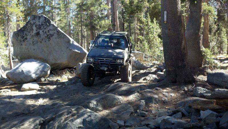

Wheeled it hard yesterday for the first time since the wheels, skids, rear cage and hood louver. Got a chance to scratch up my wheels a bit finally. Nothing to eventful, the trail is long and hard. The YJ broke a D30 front axle but made it back to the trailer luckily. That cemented my thoughts on getting RCV's as soon as I can. Just a few photos to share.
Ok guess not! Photobucket is being lame. Pics later on.....

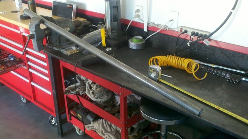

Posts: 4,368

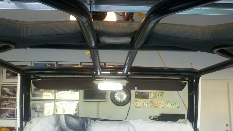

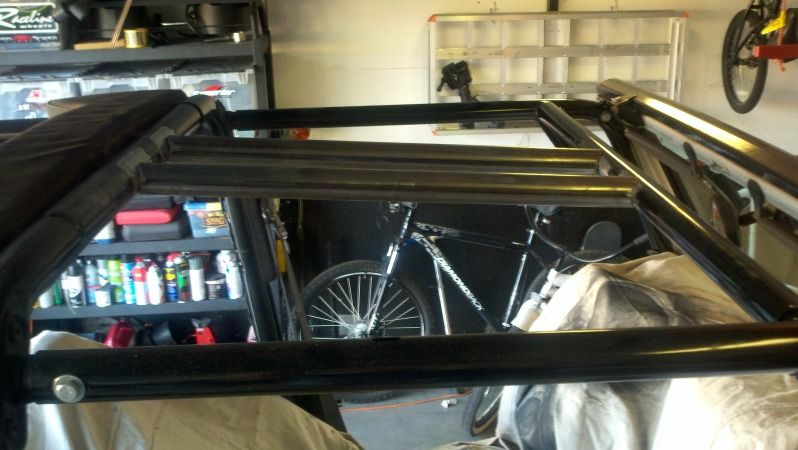

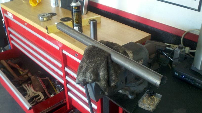

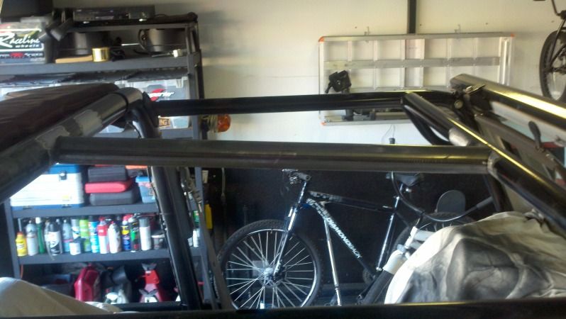

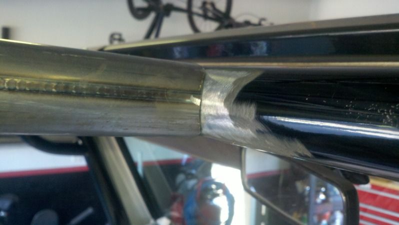

Picked up half a stick of 1 3/4 .120 tubing today to play around with. I decided to make two bars to connect my A and B pillars in the middle to match the B to C bars. This is my first time really fitting and notching tubing so it's good learning! Cutting and notching the bars was pretty easy, I can see why a good notcher would be cool to have though. Way faster and cleaner. I was DETERMINED to make sure my welding went better on these bars than it did last time. It went better but not much! I was smart enough this time though to lay off the trigger and just stitch it together with the intention of grinding it down for cosmetic uniformity.
I was able to fabricate the bars, weld them in and clean up the welds pretty good in 3 hours. Not bad I thought. I just have a little more cleaning up to do on the joints, some sanding and finally paint tommorow. All in all it went well! Sport Cage is done........ well until I decide to build a real one.
Raw materials... did you know they make you buy 10ft. minimum!
First bar being notched....
First bar fitted..... now to copy it.
Pretty good fit up...
Both bars set in place
Looks like it belongs...
