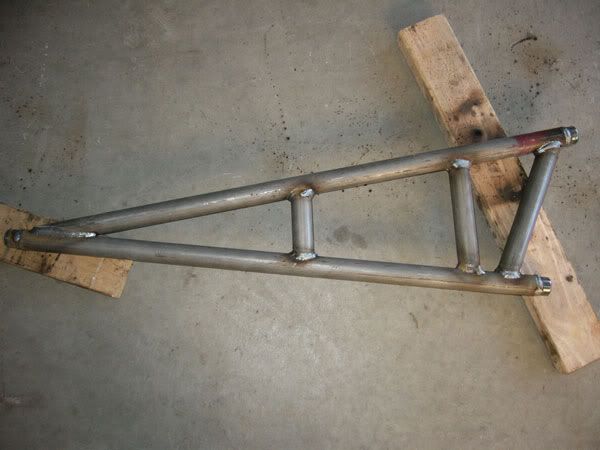

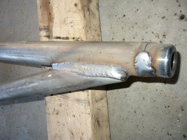

Went wheeling the other day, got wheel hop really bad and ended up destroying the U-joint straps on the first hill of the trail. Decided the time is right for a traction bar, and in order to prevent extra stresses on the axle housing decided a truss was in order. $45 in 2" .188 DOM tubing and an hour and half later and I bent and welded up a truss for myself.

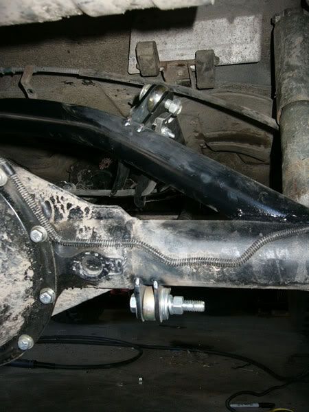

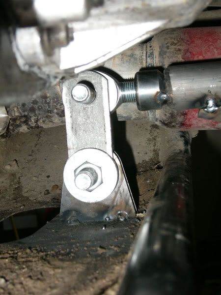

Built up an anti-wrap bar/traction bar out of 3/16th wall 1.25"OD wall DOM tubing. Heim joints, inserts and mount tabs were ordered from Spidertrax Off Road.
