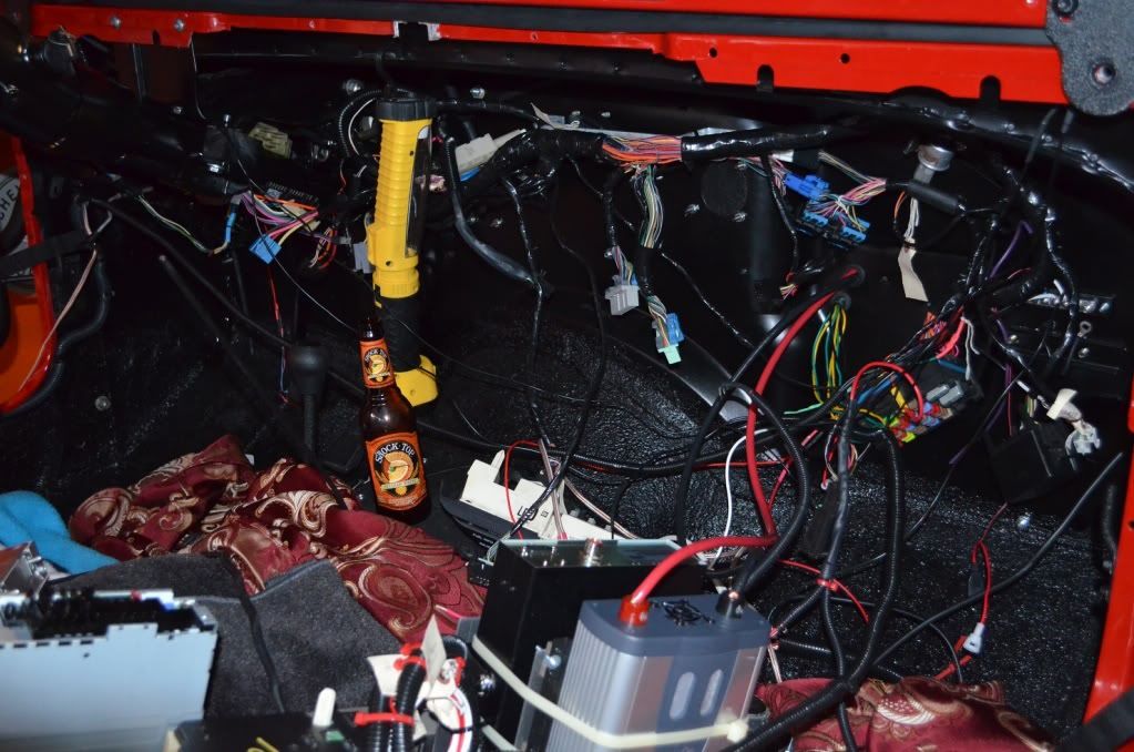

Got the dash panel off, tomorrow I'll try and find my issues. This will also allow me to clean the wiring up a bit more.
