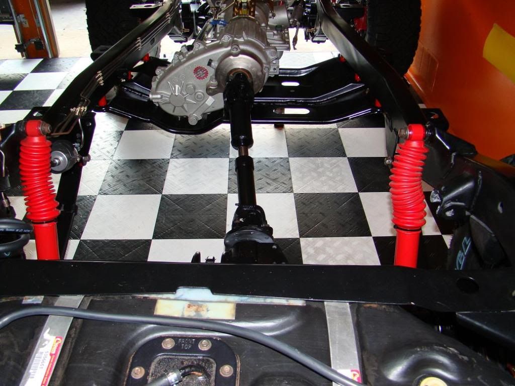

Is there anyway you could take some close ups of where you modified the rear of the skid? In the pictures it looks factory (ie good fab)! Lol thanks man!
Give me a day or so, I'll find or take and post the pics...
Rick
I fabbed it up with cardboard and tape after my angles on the drive train were done...hope this helps...

Thanks man. This helps a little bit. I was trying to see the how you did the angles on it.

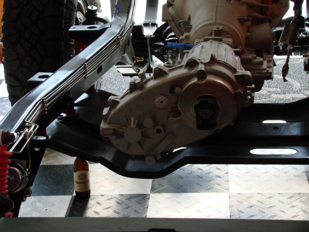

Why did you need to notch down the belly pan or clock the T-case down for front shaft clearance? Did you set the drivetrain lower between the rails?

Posts: 311
The np241 is clocked different than the 231.
Oops, I missed that it was a 241. Thanks.
Glad that was cleared up...I was wondering too.... I'm knee deep in the Griswald Christmas, Will post a few pics ( with beer) when I get more up.
