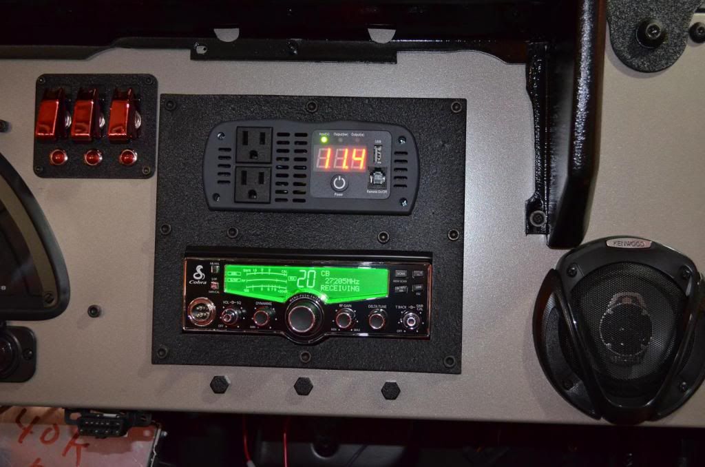

Got most of the dash wiring done...

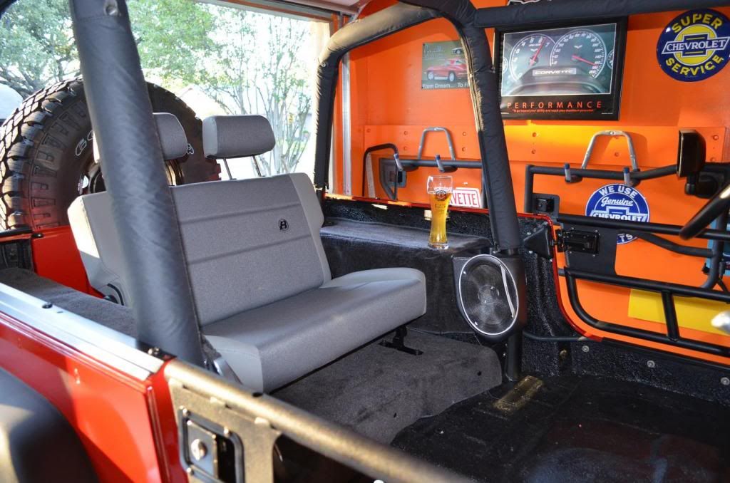

Finished the stereo install, except for the sub which should be in tomorrow, Installed the rear carpet and rear seat.
