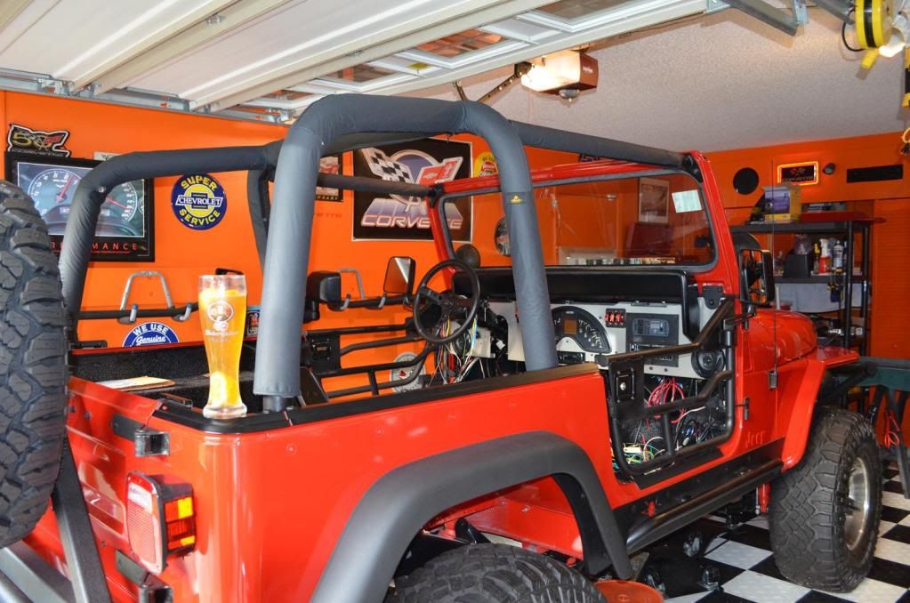

Got the dash pad and front roll bar extensions installed. Also wired the windshield lights.

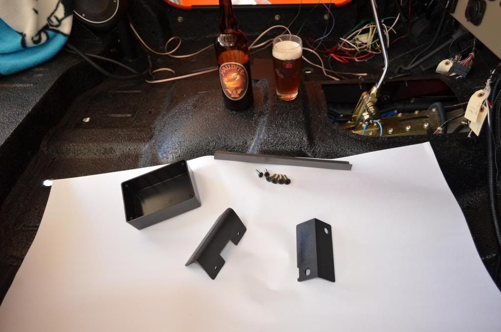

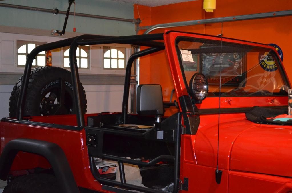

Fabbed some brackets up for the CB antenna and wiring box, also installed the roll bar padding

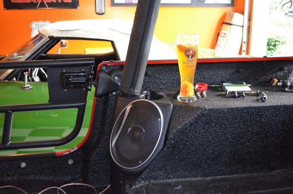

Installed the rear speakers... Just realized they will have to come out for the carpet

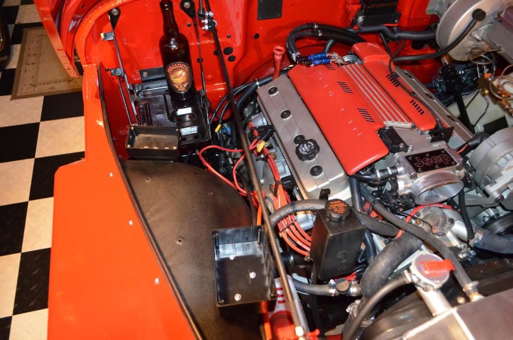

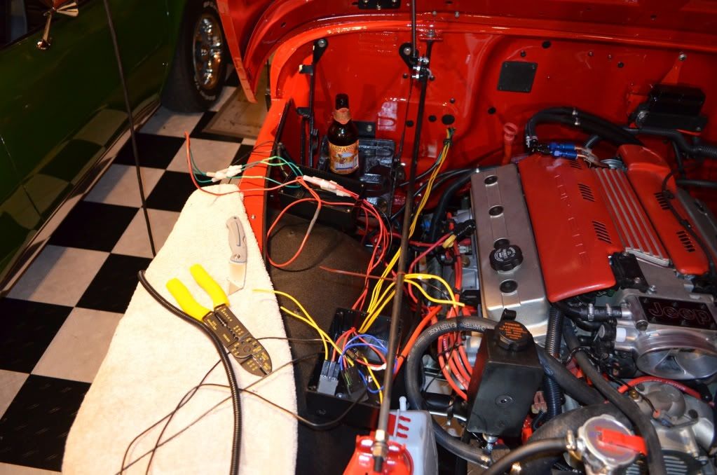

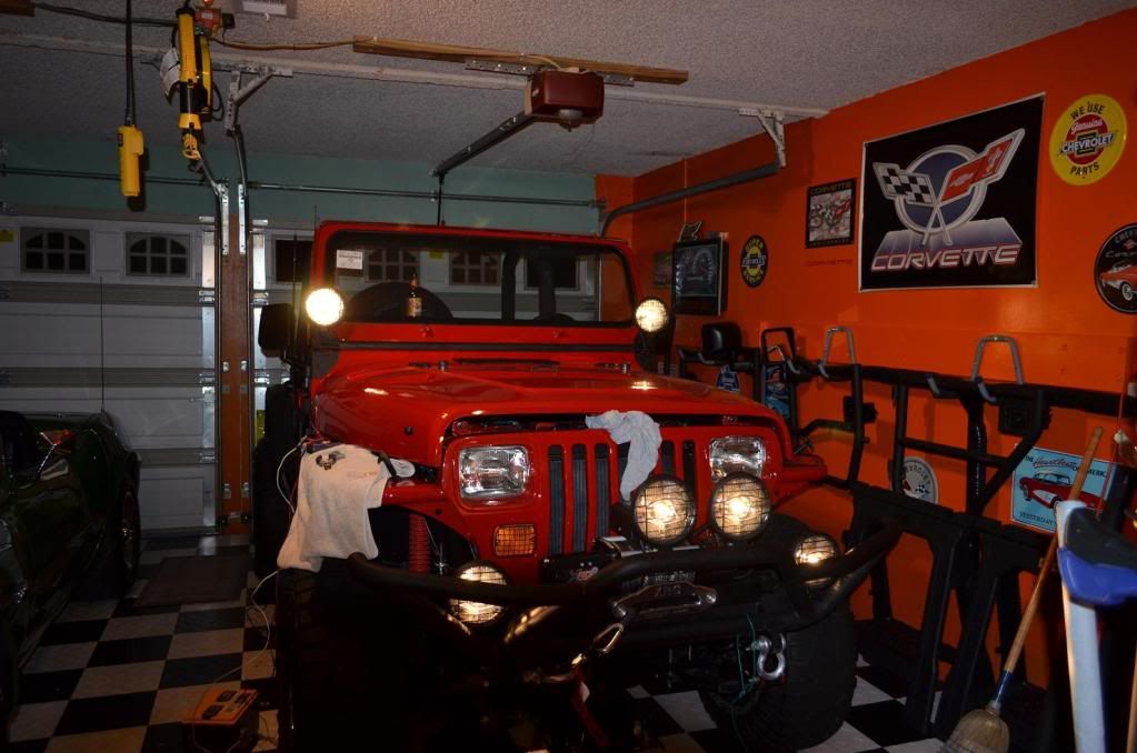

Got my boxes installed, started wiring the 6 Hella's..
Waiting for my 500 amp buss blocks from VTE, one for the winch with a 500 amp fuse and the inverter with a 250 amp fuse

Six lights wired, still need to dress up under the hood. Also still waiting for my 500 amp ANL fuse holders.

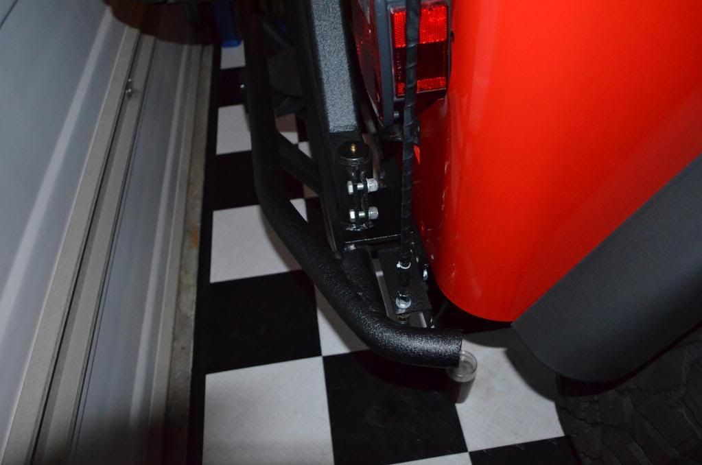

Light day, got suckered into mowing the neighbors yard. Got the CB antenna mounted, it's a 1/2" away from the light, I was thinking about sliding a rubber hose around it, then using shrink tubing around it....Thoughts?

Rough weekend, my Horns lost and I didn't get home till 2am. That's 4 hours past my bedtime. Then had my brother in-laws wedding on Sunday. This means I had way too many beers to get much done on the project, but I did punch all the wiring thru the firewall and shrink a protective hose over the CB antenna.
