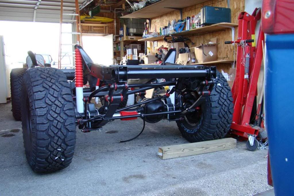

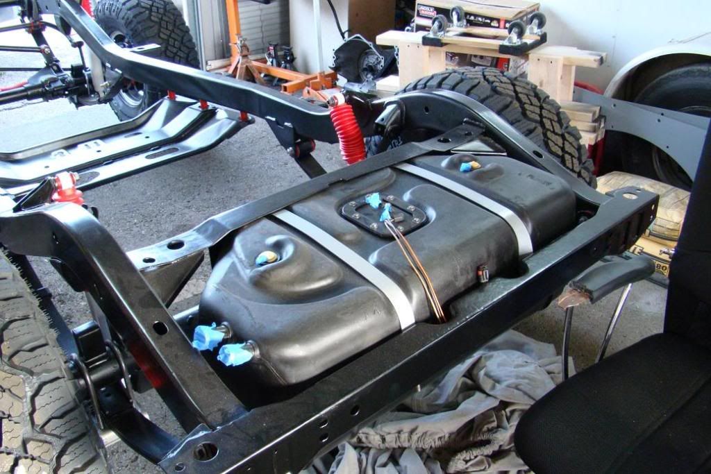

Finished the front suspension and mounted the tank, this is all I can do to the chassis for now.......On to the drivetrain.

If the resto on your corvette is as clean as the work on your jeep, that thing must be flawless. Second, don't let anyone talk you out of doing a v8 swap into a yj. The one thing I will say however, your not building a factory resto. Some of the things that were done to that jeep, and some of the things you still need to do require more mockup and layout before proceeding. I think you have seen that with the rear axle already. You should consider eliminating the rear tracbar all together and replace the front shackles with some stronger/longer ones to allow the springs to perform better. You have the skidplate bolted up with tcase drop spacers, you should try and eliminate them and run the tcase with a sye and use a cvstyle driveshaft. You will have to readjust the pinion angle on the rear axle for this, but you already have that planned. I do think the work you have done looks real clean, I'm just trying to give you some constructive criticsm.

Originally Posted by mavrick331 View Post
Removed the stock fuel pump, had to fabricate a fuel pick up.
You have any more info on this? You say you "had to fabricate a fuel pick up." What part of the above picture is stock? What part did you fabricate? Where's the fuel pump?
When I swapped my LT1 into my truck ('85 S10) the pump took the place of my stocker TBI pump which resided ON the pickup. I basically pulled the old one off, put the new one on there, soldered new connector on, plugged it in, then dropped it back in.
It would be nice if the Jeep worked out this way.
Either way...please explain what setup you're using for my sake on our swap into a '94 YJ.
Thanks, I really appreciate your comments; I understand the shackles and have been doing research. I am having a SYE installed right now on the t-case and a cv shaft is in my plan, but I donít understand the need to remove the spacers, I thought the less angle I have the better for vibrations? What am I missing?
Thanks,
Rick
I removed the stock fuel pump and replaced it with the submersible fuel line in the picture, then had to mount the strainer to it, the idea was to go with a frame mounted fuel pump.
I'm scraping that idea, the LT1 requires 255 LPH @ 40 psi, the 2004 Grand Cherokee (and similar years) uses an identical sized pump and can be had aftermarket rated with the same specs as the LT1. It will bolt and connect right up the the YJ unit. I picked one up online from TRE performance this evening for $78, free shipping.
Benifits this way are, quieter in the tank, saves frame rail space and runs about $60 cheaper..... unless you bought the foot long peice of submersible fuel line like I did for $18.....

Putting the skid back up on the frame will give you more clearance if you ever do wheel it, especially if you stay on the smaller side of tires (every inch counts). Not doing an sye and using a standard driveshaft with a tcase drop on a lift more than 2"s is a crapshoot whether or not you will get driveline vibrations. Since you are doing an sye and you have changed the rear end you would be crazy not to do a cv style driveshaft. You will have to set up the pinion angle on the rearend afterward, but thats already been discussed. Going with that setup allows you to run the skid up high without the worry of vibs, infact running the skid dropped would give you no benefit at all. I'm running about 7" of lift with an 8.8 and a tatton cv driveshaft up to a jbc ss sye, with a rockkrawler skid (higher than stock) and have no vib issues. I set the pinion angle about 2deg lower than the tcase like earlier reccomended and it works fine. The time it takes to mockup and install the motor/tran/tcase in the right location and angle, it would be well worth getting that skid back up there first. It would be a nightmare to do later. Keep up the good work and trust me, you'll love the v8 power.

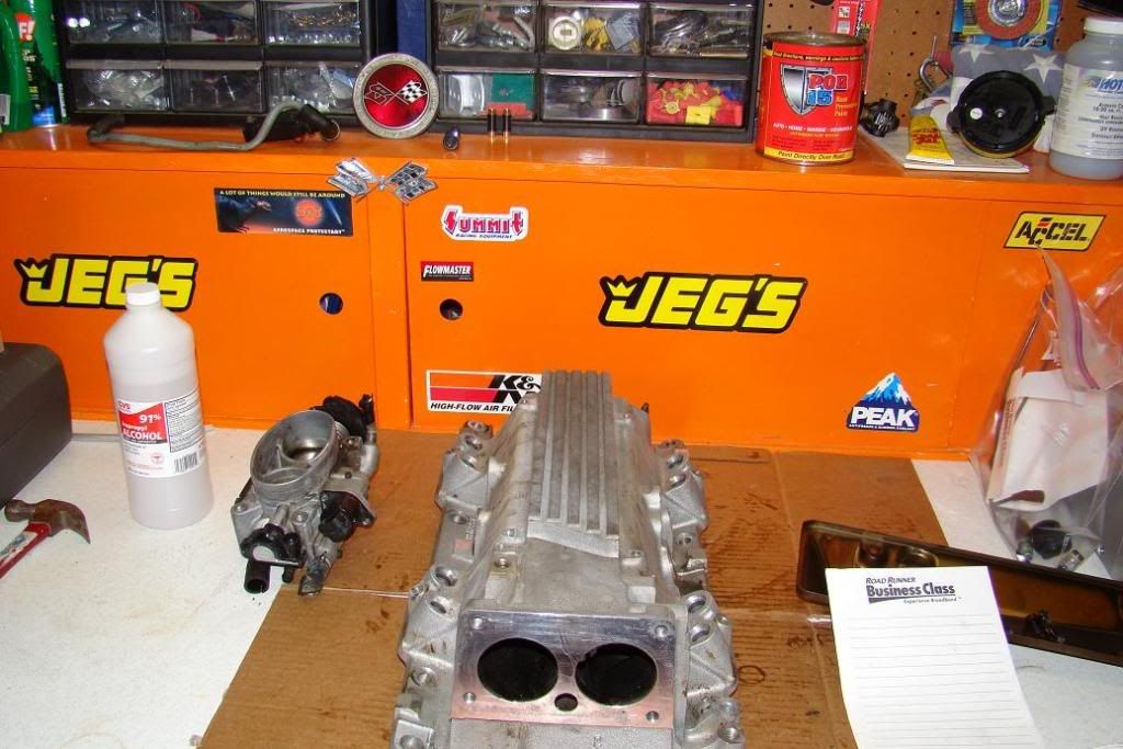

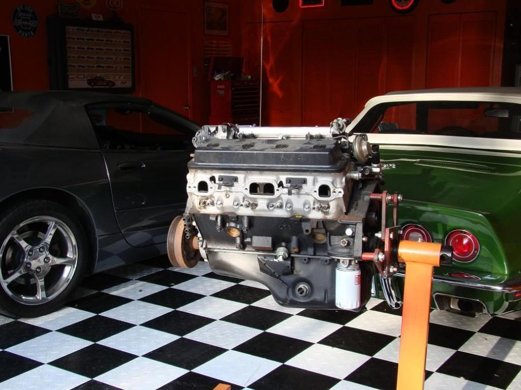

On to the drive train, decided to work on the engine at the house, gave it another cleaning then stripped the intake down.

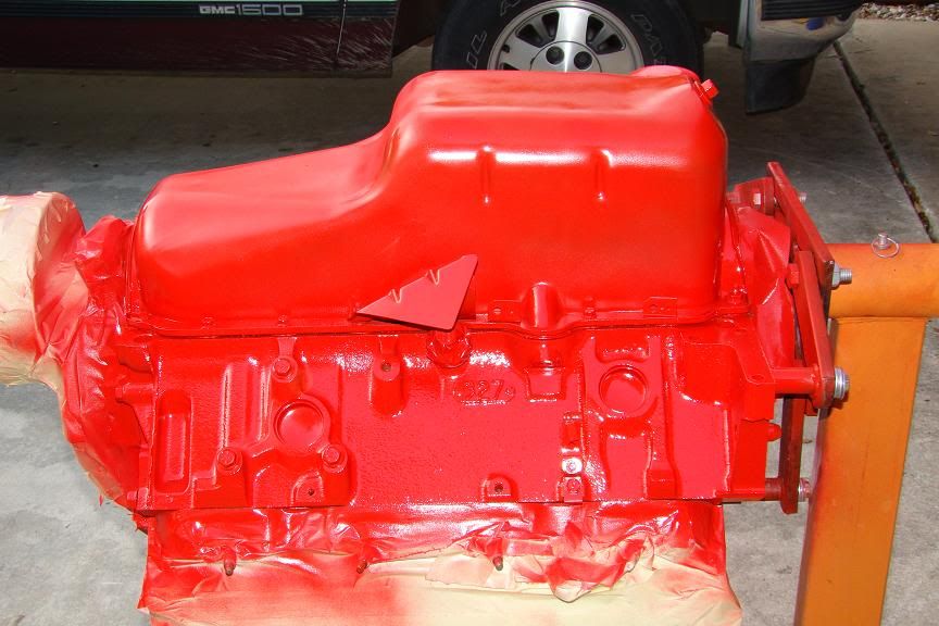

Got the bottom of the LT1 painted red.

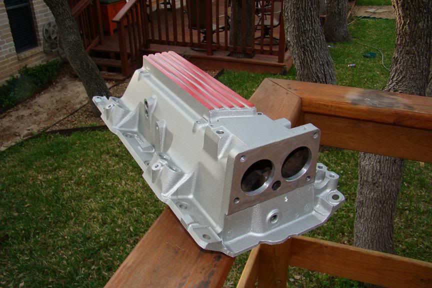

Happy Easter all !!
Got a little work in over the weekend
Intake, throttle body and my and my little helper

Nooooooo - you didn't paint those valve covers!!!! That makes me sad!!!
