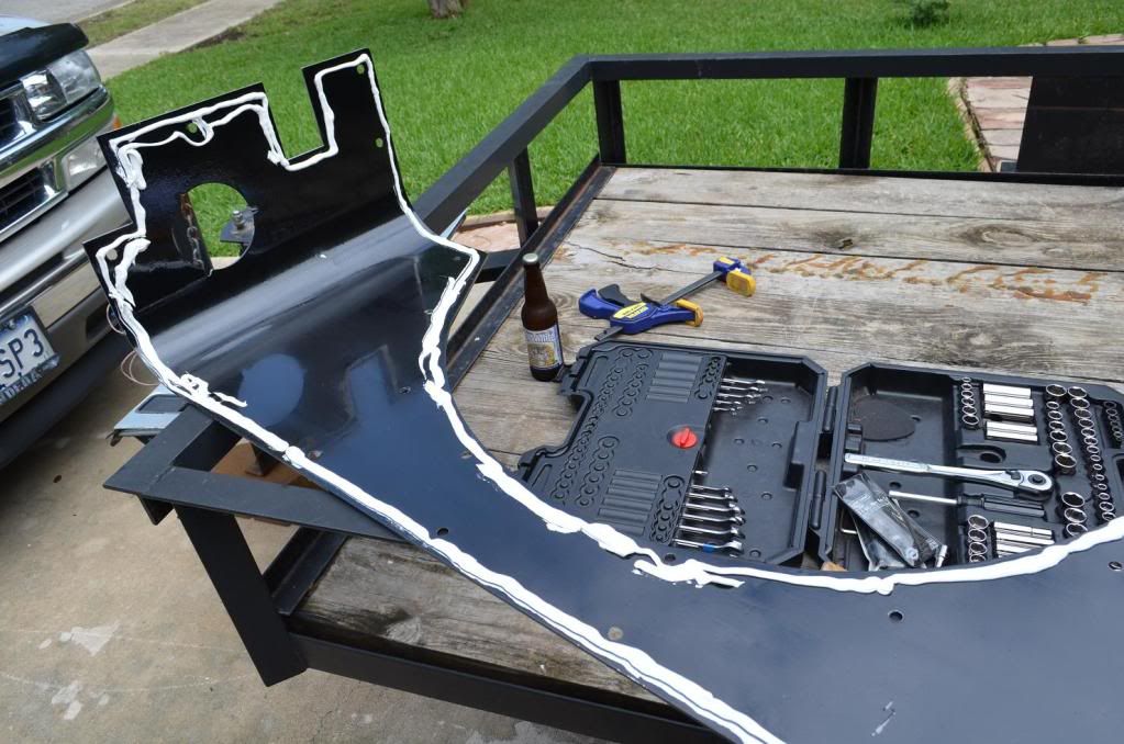

Seam sealer on the side armor..
Armor mounted for paint

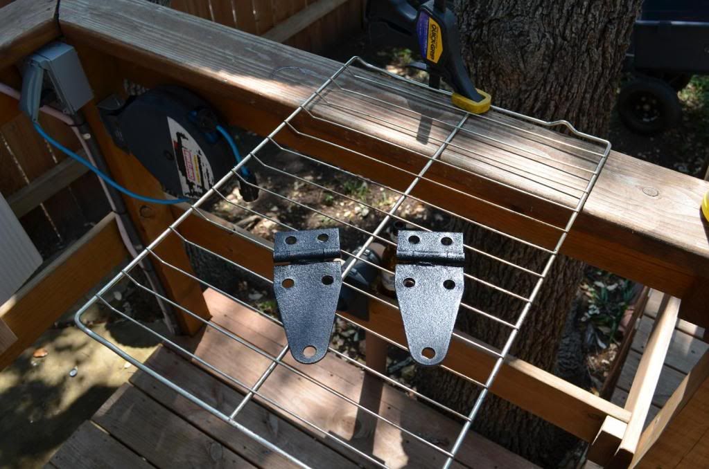

Got my black wrinkle powder in..

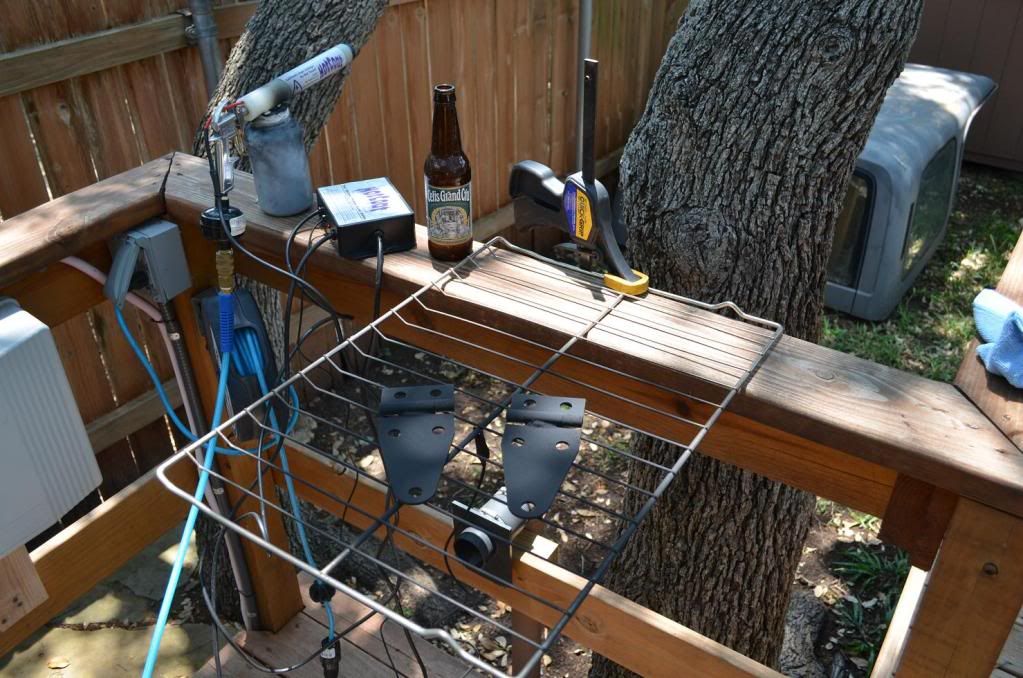

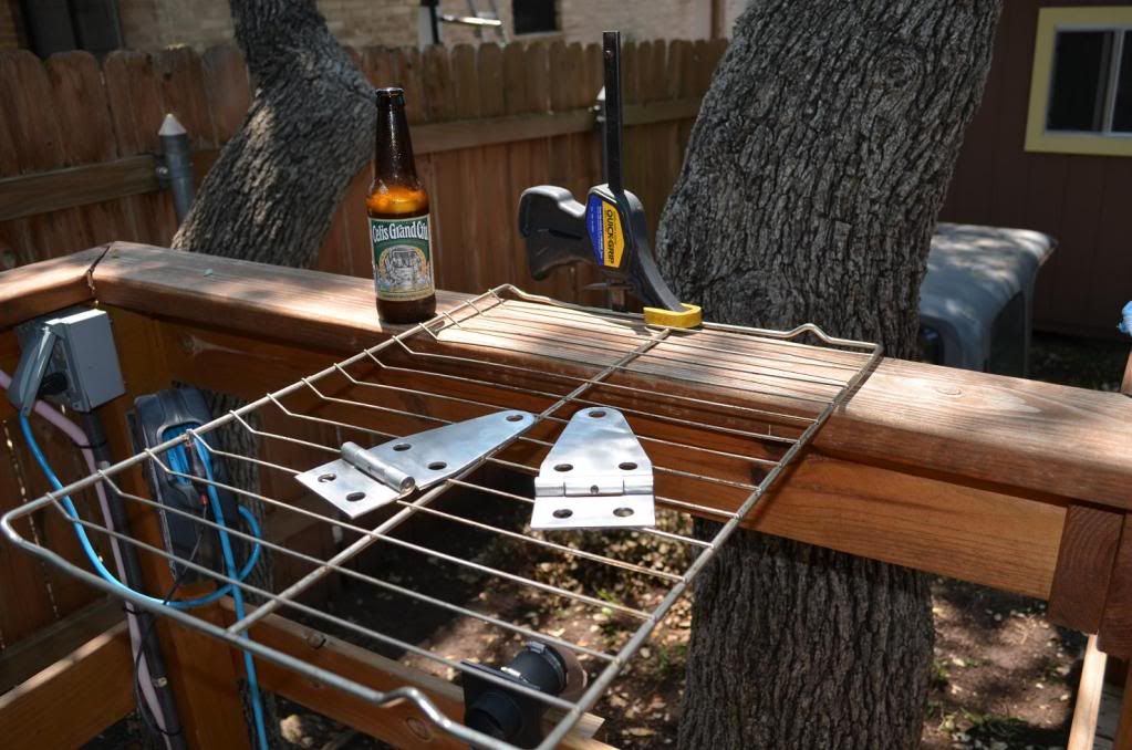

Hood hinges prepped..
Powder on...
Baked on....Picture does not do it justice, they look awesome and match the bumpers perfectly!!

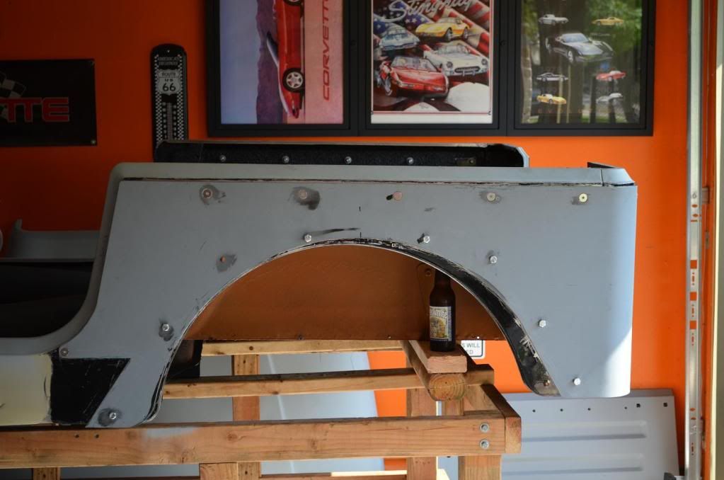

I would have, but you were not here to point it out when I did it... I'll address before it goes to paint, then again when I get to mounting the tail lights.
The side armor is for a YJ with a TJ cut on the wheel openings. It looks like I must cut the openings where the tub sticks out from the armor wheel opening to get a stock TJ rear flare to bolt up properly.
I'm thinking about loading the cut up with seam sealer? The flare will cover it.
Thoughts anyone?

Sure wouldn't hurt!

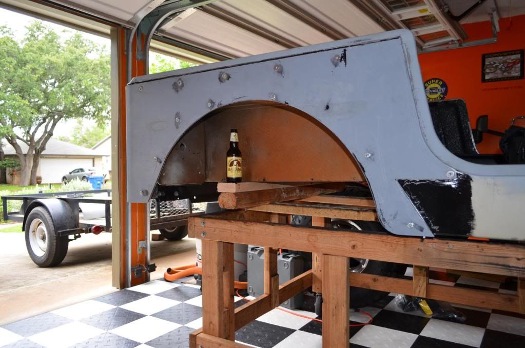

Got the rear wheel openings cut...despite the incoming thunderstorm.
